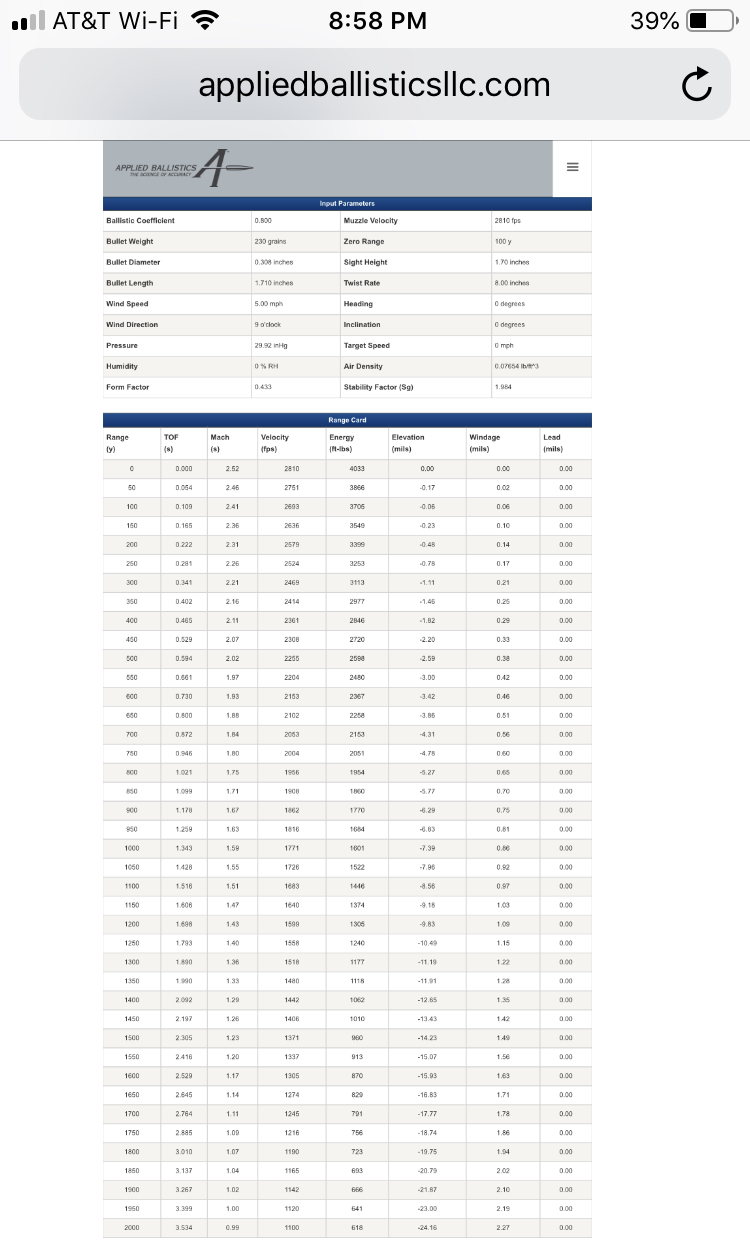

Your velocity at 1760 yards is 1336 from my calcs.

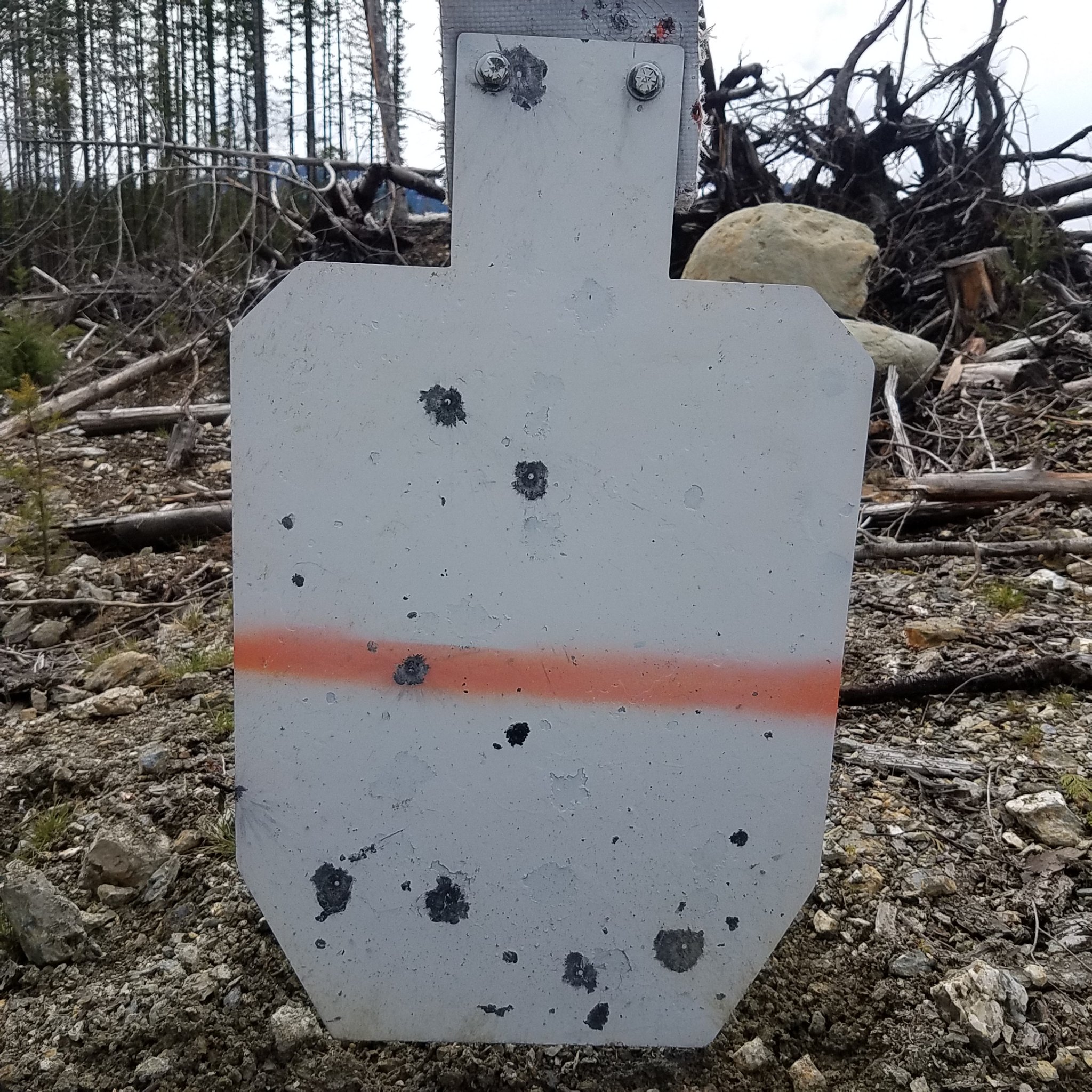

Here is a pic of a tgt from last summer. All hits are consecutive with .1 mil correction after getting on target. Was at 1743yds.
Not quite a mile but close enough.
7034992
Its now a 28" 1-9.5" twist with a Razor GenII on it. That TGT was using the current brl with 225 ELDM. This load is a little tamer than the 230 Hybrid that my last brl liked. It launches the 225's @ 2810fps. I can easily push them to a bit over 2900 but it wasn't as accurate.

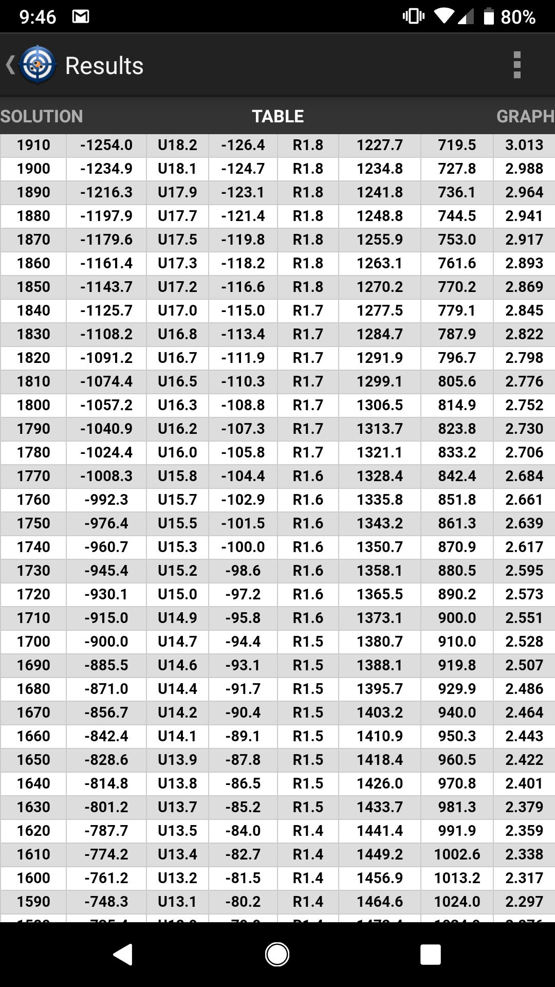

Anyone have any experience with Siera 230s? They have an advertised BC of .8
Through my research over the last week or so i think they can be pushed somewhere around 2810fps from a 26” 300PRC barrel. If this is the case they will be supersonic right up to 2000yds.
