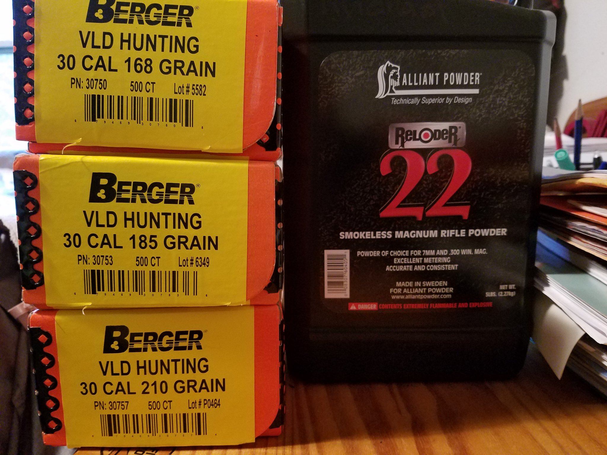

It's always a bit helpful to know a little info on the gun. Having said that I'm an unabashed RL22 fanboy. For my location it just works for me and those I load for. Regarding the 185 VLD's, ya, we've across the board wrote them off. We as a whole like to either zip 168's outta a 300WM or 210's for more thump like a WM should have. IMHO if you think about it the 185's make no sense, unless of course you have a unicorn that won't shoot the 168's or 210's. *Honey, where's my flame suit* :unsure: I've loaded for Remmy's, Winny's, Savage's, Thompson's, SAKO/Tikka's, you name it, and a fair bit of people with WM's. They all have pulled the plug on the 185's for the right reasons for THEIR guns. I'd throw CBTO's and grains at ya but not knowing if you're going for magazine fed lengths to jam, meh, it's a futile endeavor at this juncture.
