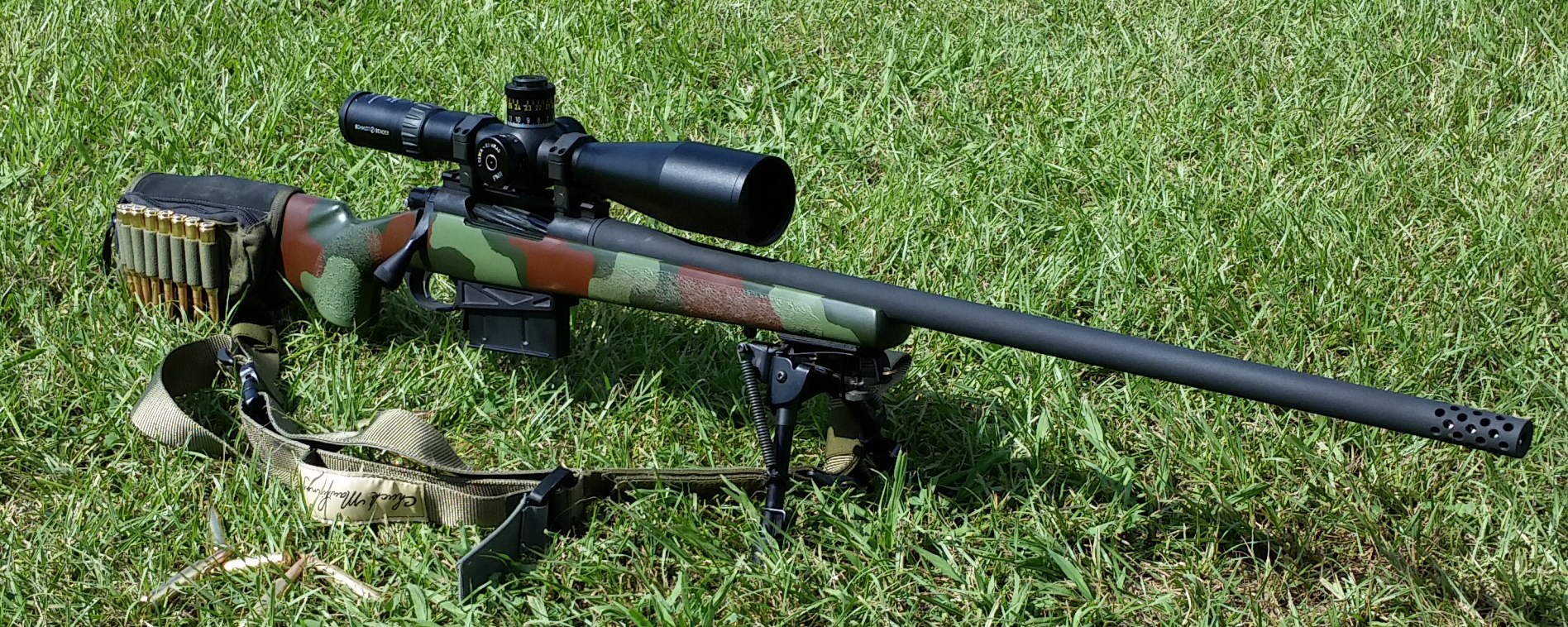

I Had to build this when my oldest son said he was ready for his own rifle and I said pick one out! So he took mine!!!WTH image.jpg and yes this is my HUNTING RIFLE. A Sendero will be really hard to beat for the money your looking to spend, $1000.00 plus a $200.00 jewel trigger and your in business. Good luck......
