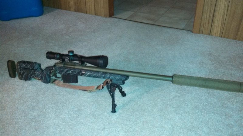

I think mine turned out perfect. I used a TRG S action, KRG chassis, and Lilja Mk.13 barrel.
It's very heavy but it soaks up recoil. Shooting 215 Hybrids at 2975fps in Norma brass.

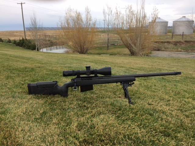

I have a 24" proof on mine, only thing I would have done different (which I am now) is get a different brake. I went with the thunderbeast brake since I am going to eventually run suppressed, but it is not very effective at all. Muzzle is all over the place. Trying the area 419 stuff out. I am also contemplating going with a little lighter bullet, maybe a 190 or 200 grain. Shooting 215 bergers now, which you don't really see huge advantages ballistically until you get waaay out there. Most of my shooting is done under a thousand yards, Then again my gun shoots the 215s so well, I might just stick with it.

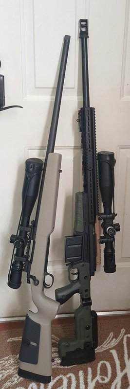

So that will make 3 people I know of with a .300 WM Mausingfield, myself included. Mine sports a 30" Pac-nor heavy Palma prefit, Manner T4AF with mini chassis , jewel trigger and a Vortex Gen 2 Razor. Took a year to get all the parts but like 20 min to assemble. I started with the 215 Berger at 2985 but found better accuracy with the 212gr ELD-X at 2975, running it suppressed with a SilencerCo Hybrid gets me to 3010.
The other day I started to do some testing on the 225gr ELD-M which show promise, I could get 2920 suppressed out of it.
As for what I would have done differently, I should have went with a 9 twist as I pretty much only shoot heavy bullets except for a breif tryst with some 115gr Controlled Chaos bullets at 3600fps.
I plan on hunting with it this year because I can though at 20lbs hiking it up the ridge to my stand might be a bit overkill since a long shot is 150yds.
