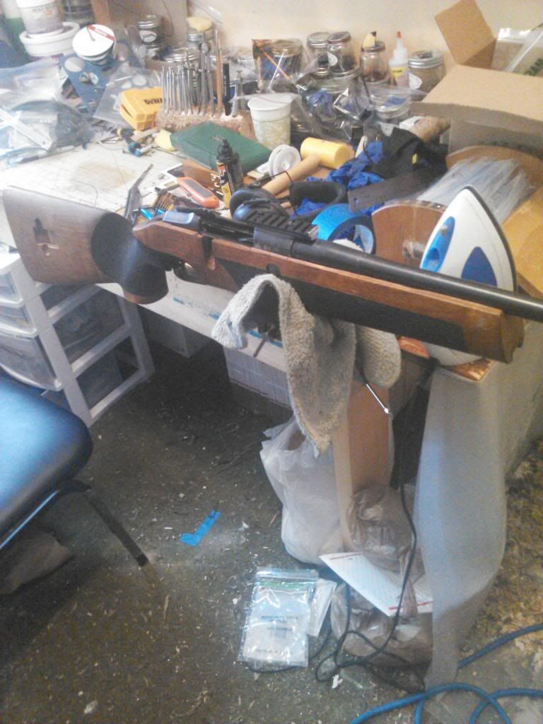

OK guys time for pics. Got the stock in this week and started right in on it. First off the pics I promised of the trigger group. Then the pillar bedding of the stock. Stippling and staining next and then one teaser of it mocked up. Lots of work but I think it will be worth it in the end.
Now that everything fits and looks the part, the next step is to find a scope that will work for my needs. I will also be building a barrel shroud to resemble the TKIV 85. I have an old mosin stock that is cracked and worthless. Turns out the wood is the same. I will just need to sand and refinish it after shaping. I will also be adding a muzzle brake to handle the 300wm.
I have given some thought to this and I will also add some weight to the stock. It is relatively light and I think it would benefit from a couple extra pounds. I will remove the butt stock plate and bore a hole into the stock at that point. Then mix lead powder and devcon together to make a slurry, a heavy one. Add some to the forend of the stock and balance it while I am at it. Barreled action is getting torn apart and cleaned up now. Then a coat of either black or OD green moly resin after the brake is installed. All that I should have left is the bolt modifications. I got in my parts from McMaster Carr. I decided on a 3/8-24 bolt and 1" phenolic knob to create the look I wanted. I also ordered the same knob in 1.250 and it is much larger than I want. Oh well, extra stuff to go into the tool box for later.
The stippling was accomplished with an electric engraver that I made a tool for from a finish nail. It gets the job done faster. Tape everything off at least twice, decide on the pattern you want and get after it. I used a steel ruler to get the straight edges perfectly straight on the stippling. It took me about four hours to do this project. Small circles....lots of small circles.
