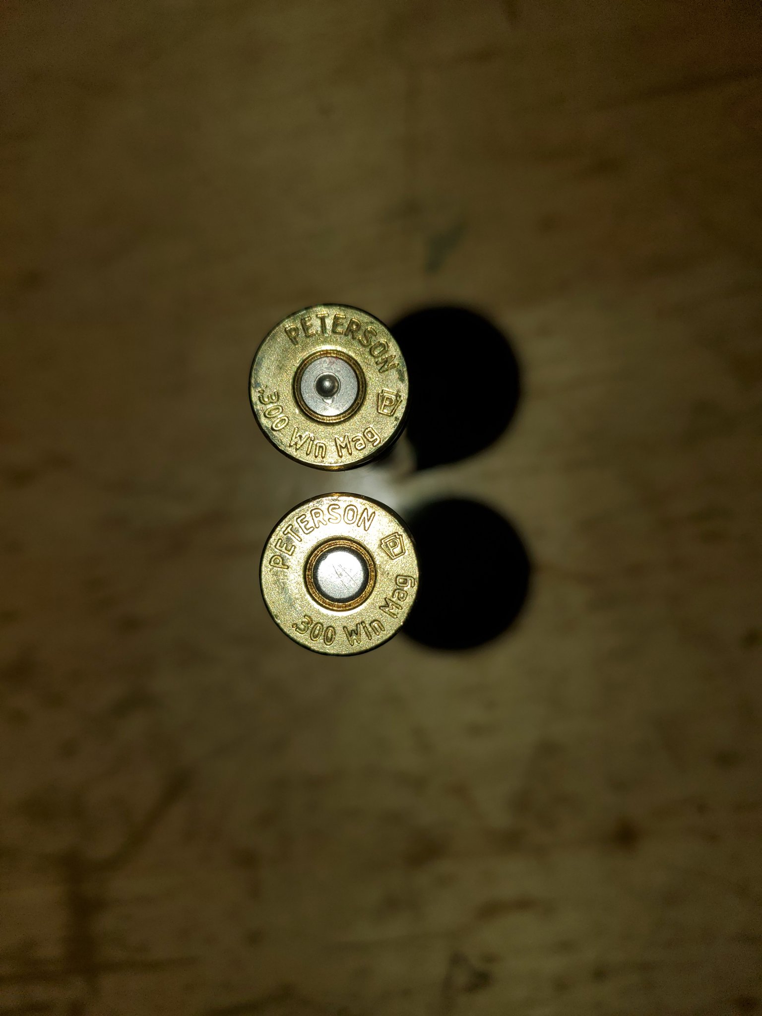

What pressure signs? Thanks for some recent info.

I didnt see any pressure signs to bring any alarms nor did I have a sticky bolt. I would have tested further, but that would have meant loading my round arbitrarily longer, but I dont think it would have squeezed out any more fps. I believe if I want to get faster rounds (im satisfied with the results btw), I would need a magnum primer and redo the ladder test. Below (top) is a round that was loaded to 77.7gr and an unfired round. Aside from a very marginal flattening as expected, the brass held itself intact with no noticeable damage. But Im also keeping in mind Peterson brass is built like a tank.
