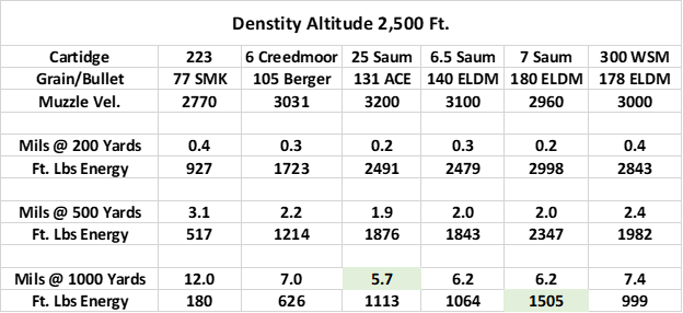

I have been studying the 131 ACE for a 25 SAUM build and reading up on @coldboremiracle articles of his Quarterbore experiences. I decided to make a table to compare drop and Energy on target of the calibers I load for with actual data straight from Trasol. The 25 SAUM is the only one with a muzzle velocity that is an estimate based on reading I have done. The 300WSM sounds like a show stopper but when the data is next to something like the 7SAUM it does not look as good... but only at extreme distance. I'd image a big ol' 30 cal hole from a WSM at "normal" hunting distances will be devastating. Plus fitting in a short action is a huge benefit.
I was happy to see the 25 SAUM is much flatter than the rest, while still retaining enough energy to whack a mulie or maybe an elk... but the energy of the 7SAUM still is hard to overlook.
Anyways, back on topic! Here is a 300WSM data point for you. I'll take my table over to @coldboremiracle page on the 25 Creedmoor and 131 ACE now lol
