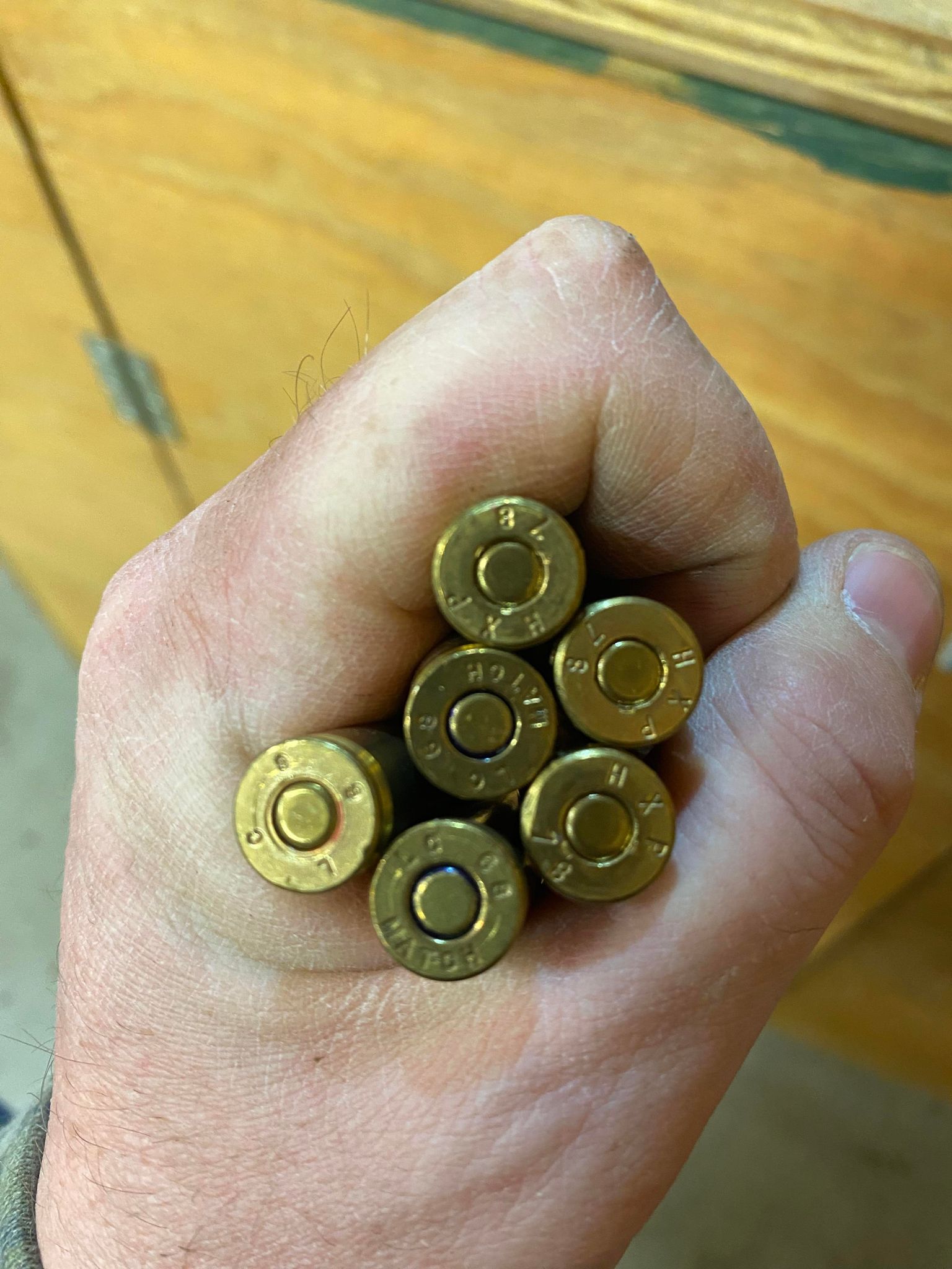

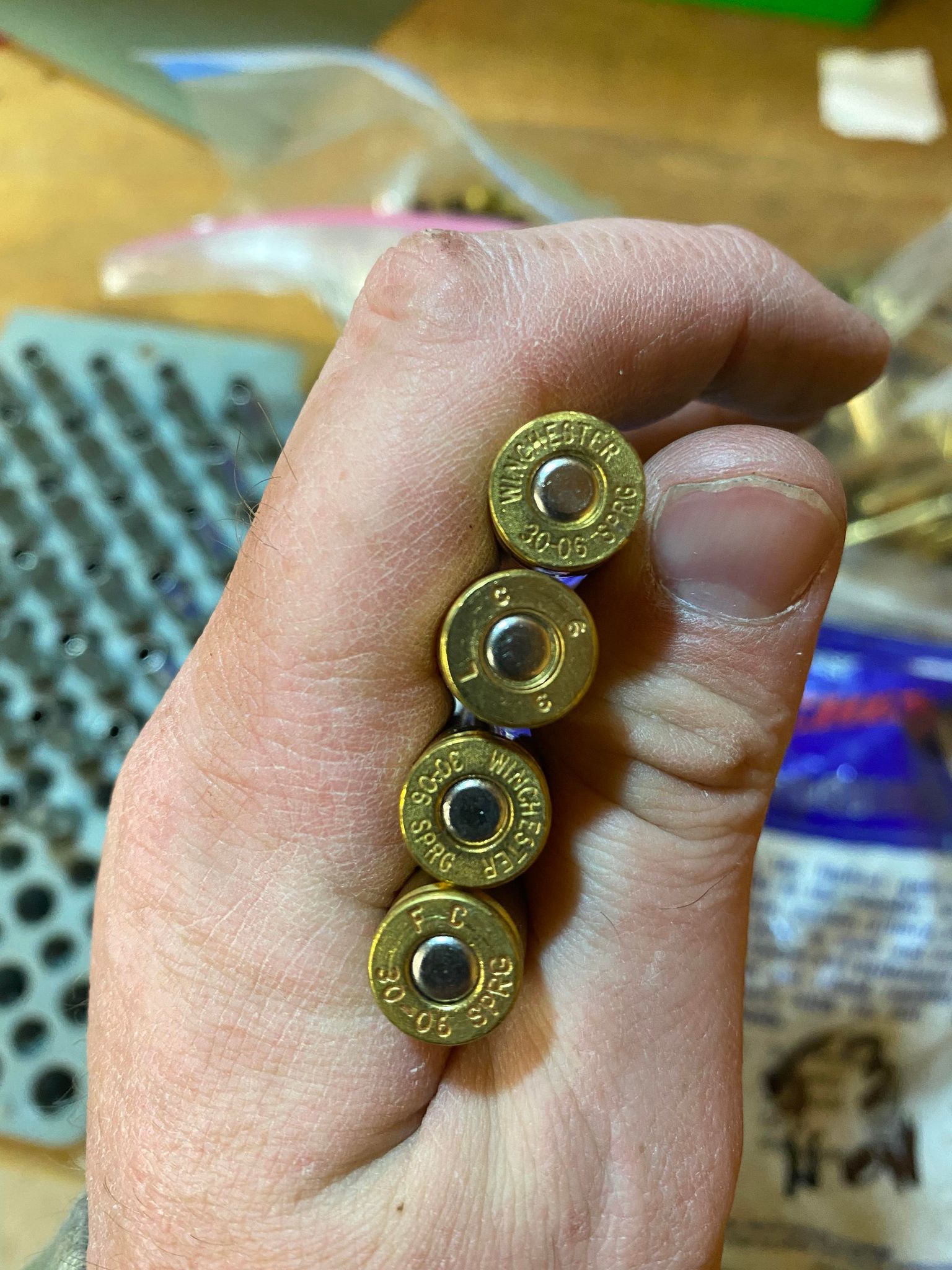

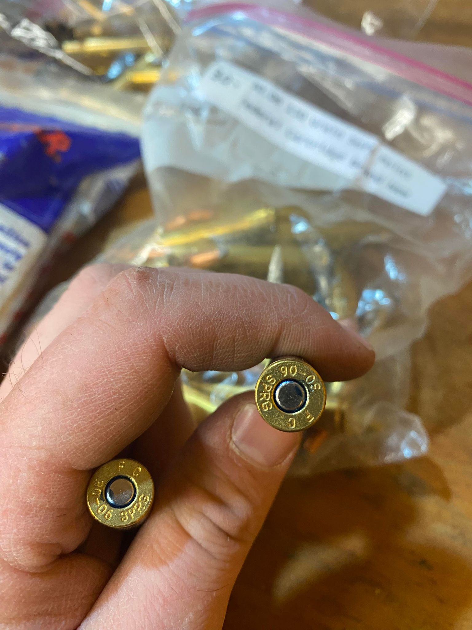

Getting some components together for a target rifle build. Went through my late fathers stash of brass. I found roughly 400 rounds 3006 almost all either once fired or brand new. However, some of it has been primed and I am trying to decide if I should just roll with it or decap and reprime. I am not sure what primers Dad used, most of it was still in loading blocks at Moms. He had started reworking the brass sometime after his 2nd stroke and he was starting to go downhill cognitively. I am not sure where any of it came from. Mix of head stamps, mostly winchester, remington, LC and HXP military brass.

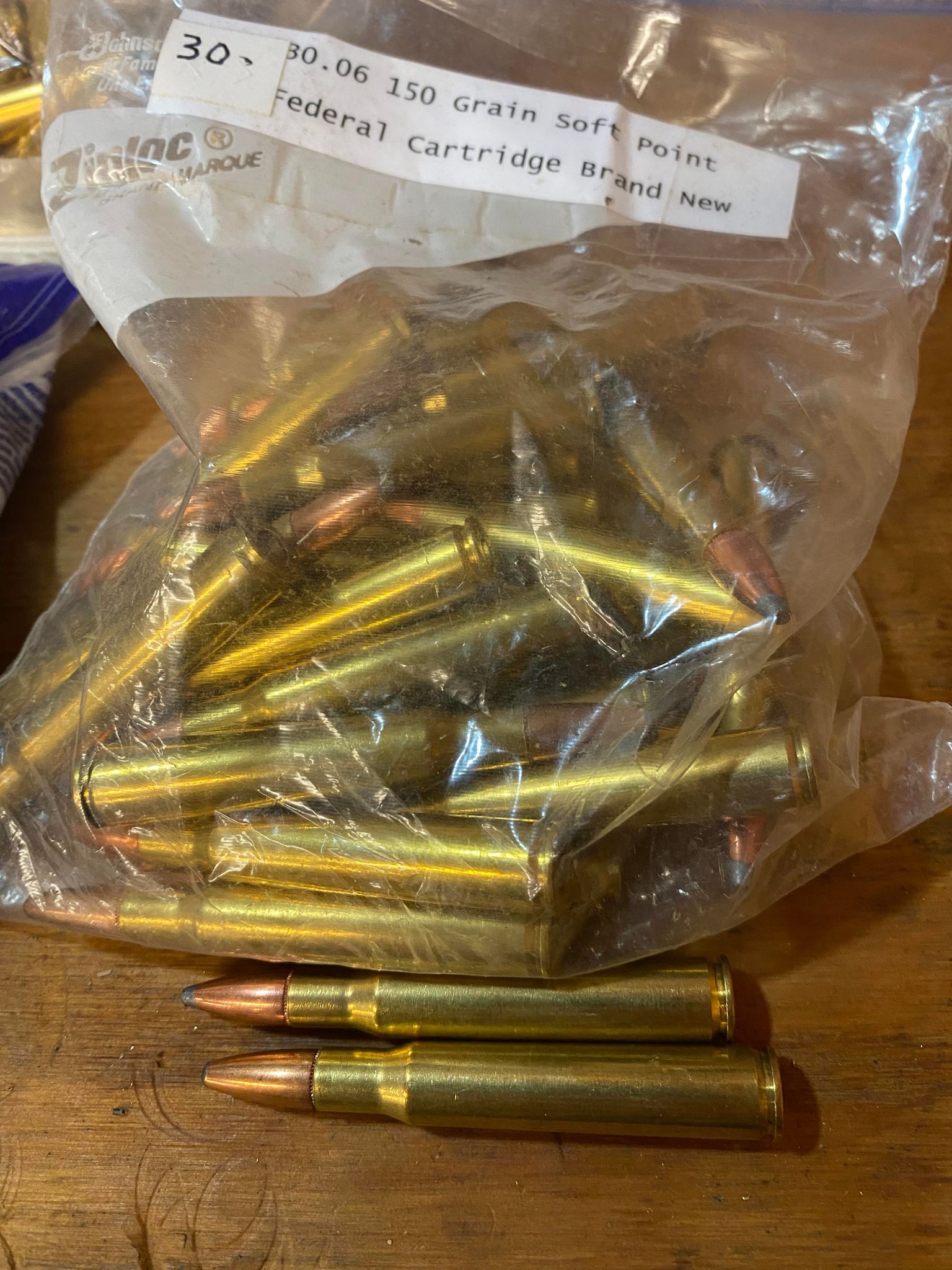

I am assuming Dad got these at either a gun show or an auction, I am not sure if they are brand new federal or someone's reloads. Should I pull the bullets and start over on them?
And finally I have a pile of floor sweeping brass. All I can figure is that either he bought them this way or he pulled bullets and powder himself. Mix of LC 66, 77 ect, HXP, LC Match brass. They all have what looks like factory primers, should I pop the primers as well or roll on? I am loading for a 700 and squeeze some accuracy out of what I can put into lots.
The primed brass, I'd pop one in the chamber, step outside and see if it lights off (be smart with where you point it / where you do this). If they don't hang, I'd load and send me.
The fed brass with the sealed primer are likely factory rounds and g2g, I don't know anyone at gun shows selling reloads with sealed primers but I've been proven wrong before.
The gold primered brass - HXP is the headstamp for greek surplus IIRC. I'd make sure it's not corrosive, then probably send it anyways.

The FC in the plastic bag appear to be labeled correctly IMO.

Non mercuric primers are very stable and last indefinitely. The advice to shoot a few should verify they are good. As for the loaded rounds I would not shoot those. The problem is if they are reloads you have no idea who or how much. Just isn't worth the chance. As for the primed military brass I suspect Dad primed but never loaded (mix of headstamps). Again shoot one and see if it goes pop. Did he load for a Garand or a 1903?

Deprime and use the primers in practice ammo. On the GI brass, the primers appear to be original and crimped. Best to load and use IMO.
