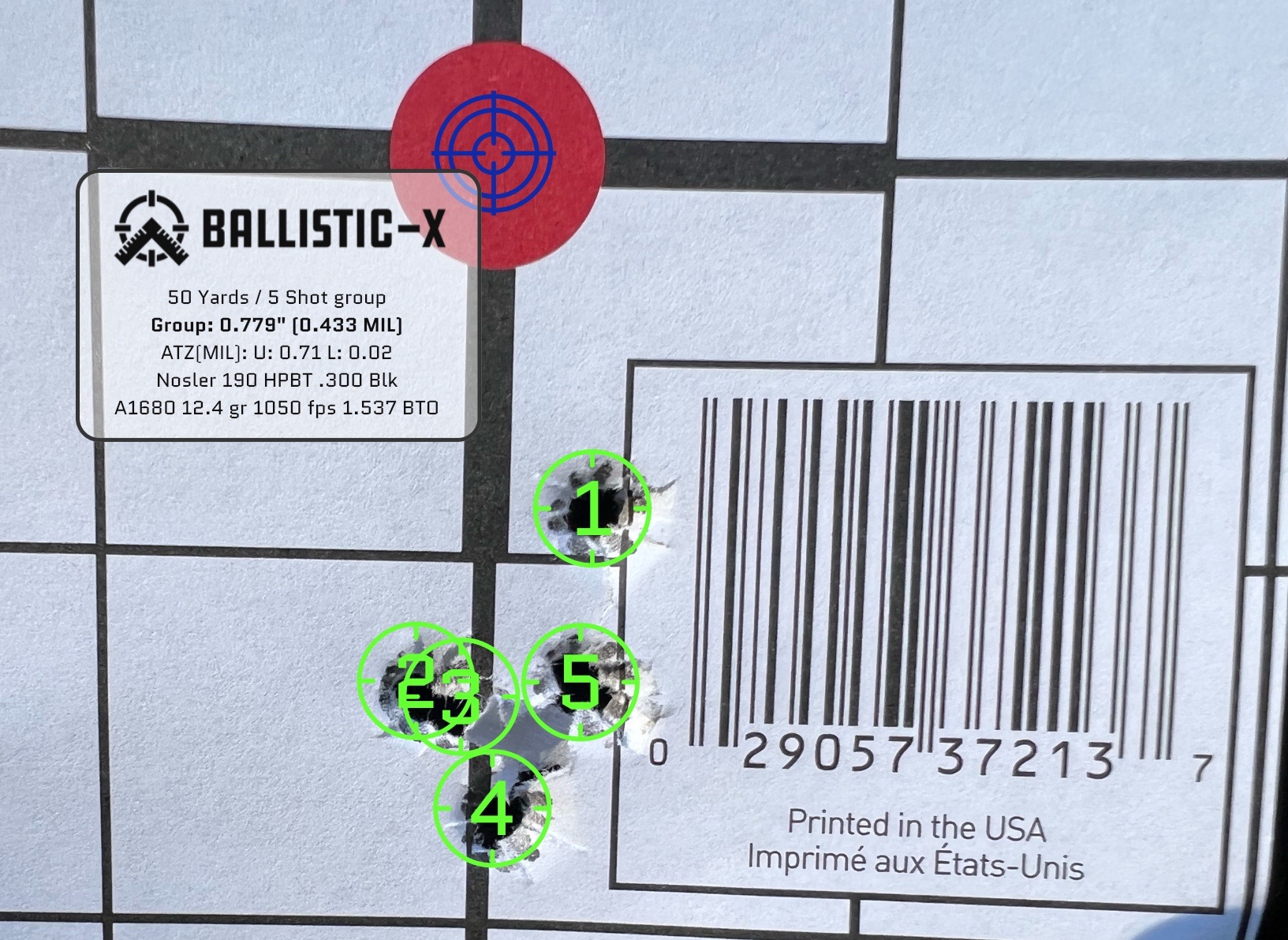

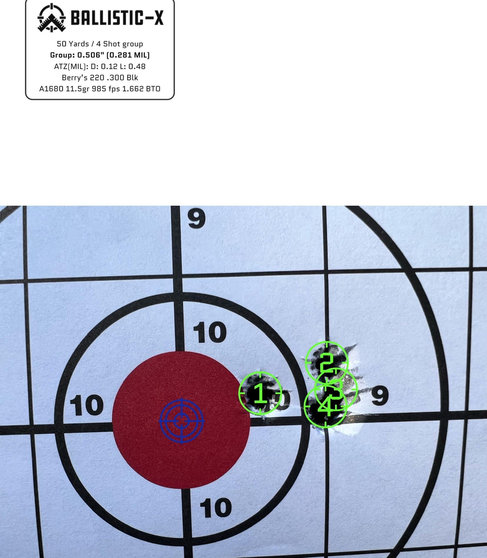

I like AA1680 under a 208 gr hornady bthp. I'm loading 11.4 grs in Lake city cases with cci 41's. Barrel is 7.5". I haven't had a chance to shoot them suppressed yet, but mv is 1050-1075. You might need to back that charge down just a little with your longer barrel, to stay subsonic.

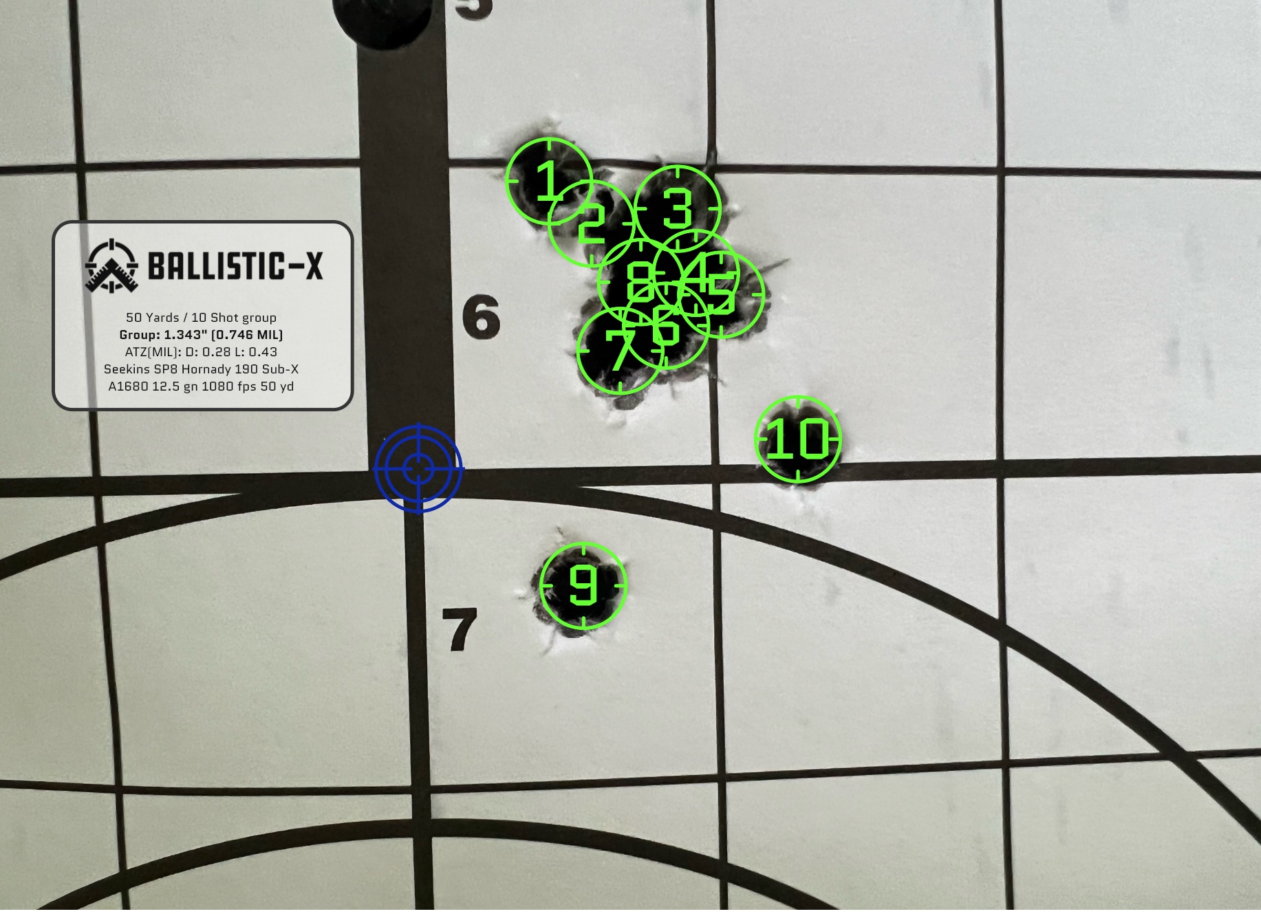

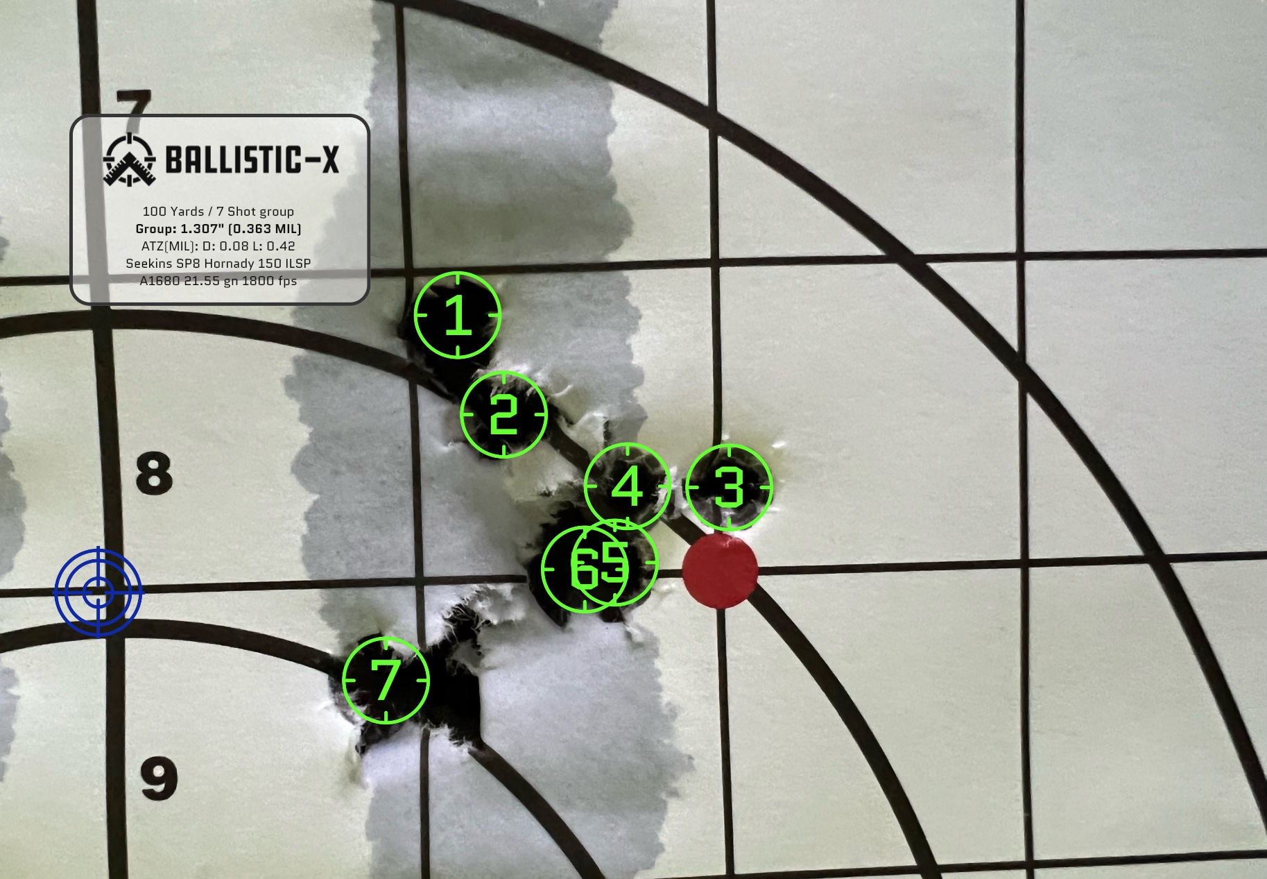

Seekins 8”
Magnetospeed V3
69 F 28% 30.07 in
Hornady 190 Sub-X
A1680 12.5
205M
New Starline brass
BTO 1.680
1146, 1093, 1142, 1099, 1094
1” @ 50y
Berry’s 220 gr .300 Blk SP
A1680 12.4 gr
205M
New Starline brass
BTO 1.6620
1082, 1081, 1081, 1062, 1079 SD 8.4
1” @ 50y (4 shots 0.75”)
