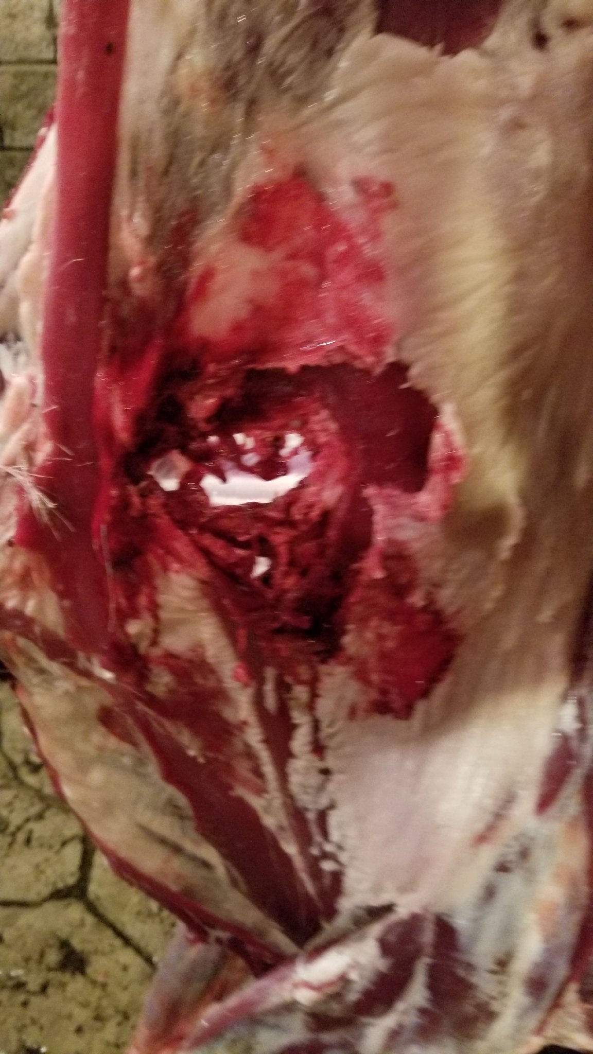

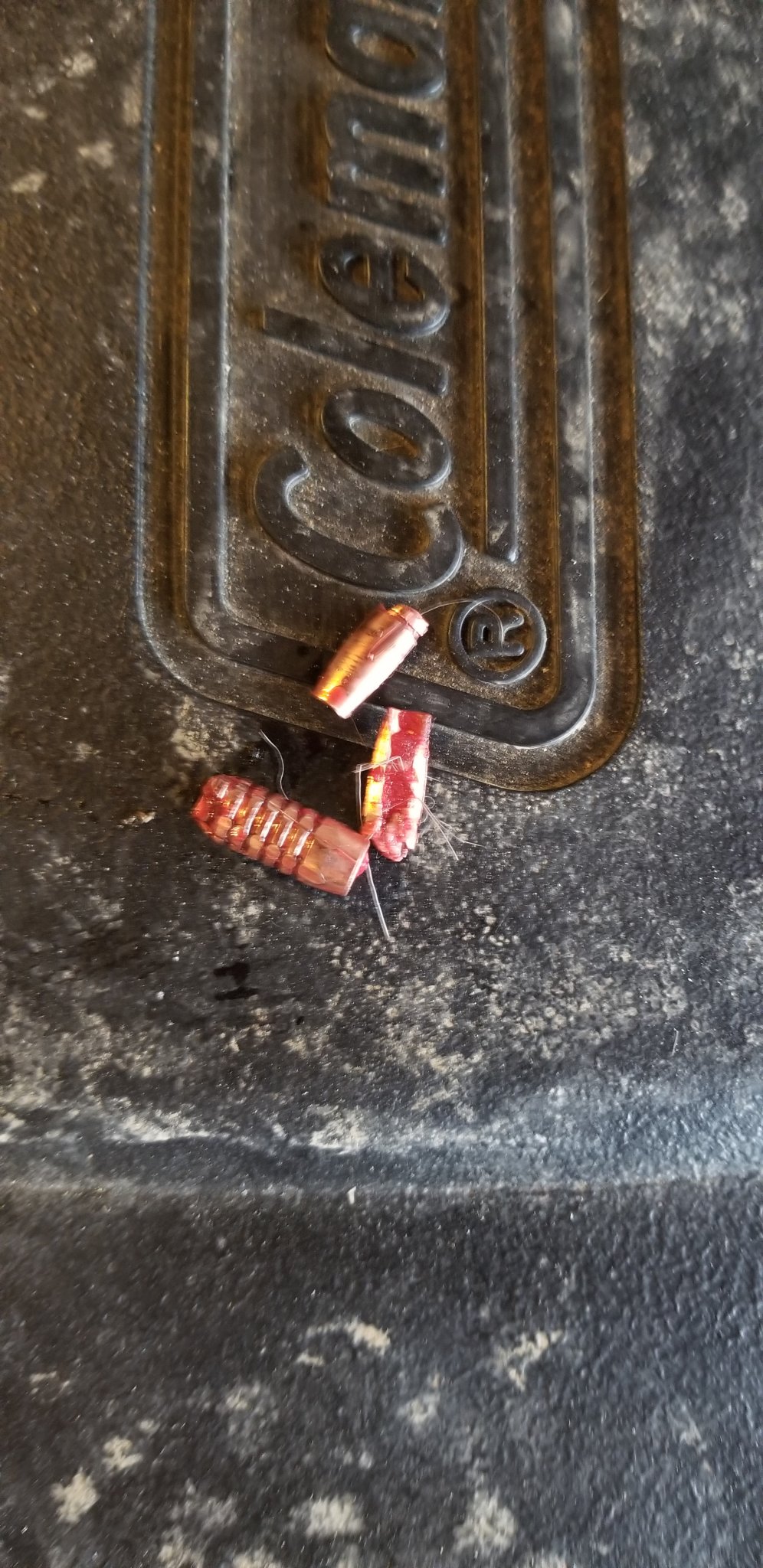

My nephew shot his first deer in a treestand hunt on my place. After he shot, this 80lb deer took off running. I grabbed the rifle and put 4 more in it on the run before it stopped. It ran 150y with 3 of the 4 bullets in the vitals. Terminal performance was really underwhelming.
What bullet and what range

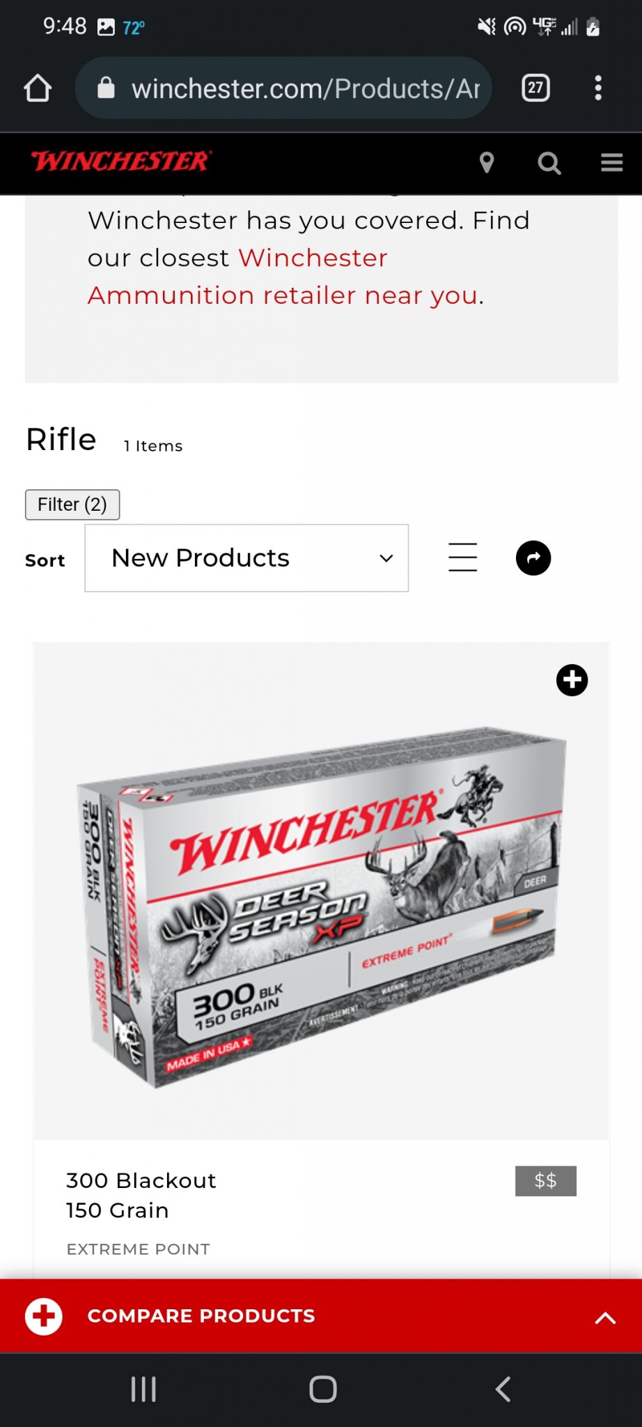

It's been a few years since these events, but I believe it was the stuff in the attached picture. I thought I remembered them being 125gr, but it may have been 150gr. I remember the box was marked "deer season" or "deer hunting" because I was so disgusted with the performance on actual deer. I now load my own 300blk for coyotes in tight timber, and it does great with 125gr TGK, 110gr V-max, and 120gr TTSX, but my days of shooting deer with it are over.
Personally wouldn’t trust a 150g projectile to perform in 300BO. That round is only doing 1900fps from a 16 inch barrel. I’ve loaded 150g hornady spire points to high 1800s, low 1900s and watched it pass through 7 milk jugs. It only started to tumble/deform on the 5th jug.
110-125 would be the only thing I truly trust unless it was one of the controlled chaos rounds, and even then I’d prefer 110-125 range.

I was just looking at data for the sake of this discussion, and there is roughly 300fps difference at the same bullet weight between 300blk and 6.8spc. Same platform and barrel length, I'll stand behind my statement that if subs aren't part of the equation, the 6.8spc just blows it out of the water. We are talking about the same m.v. difference between .308 and 300wm. It is significant.
Reactions: roostercogburn98
300 fps more would put this type of bullet into the “suggested” speed range for that bullet type.
I agree. I had a bad experience with the Speer 150 and it was sold as a expanding round at low speed, never again. If I’m using supersonic I’ll use the Barnes 110.
Those soft point 150s are supposed to be going at least 2100fps. I had some loaded, but like you have went back to the 110 for deer. Will see how well they work this year hopefully
