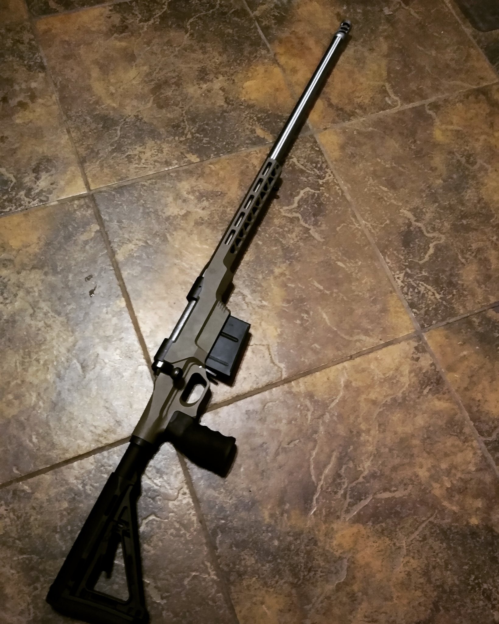

I'm new here sorry if I do this wrong.
I have a customer who bought a brownells MDT chassis long action for a rem 700, he wants a 300 prc from it but magwell is for 3.715 aics.
Brownells says it will work both with chassis and mags, but I'm having second thoughts, anyone out there ever tried to fit 300prc in the 3.715 aics mags?

The 3.715 AICS mag has a COAL of 3.625” - you will *not* be able to run 300PRC at SAAMI COAL.
That said, I’ve talked to @MDT_OFFICIAL support about CIP-length support in the ESS/etc., and to quote them:
“At this time we do not plan to make a 3.850" cut into a 700 platform as the 700 itself cannot accept it. Their 338 mag is 3.775". That being said, we have had customers mill out the front of the mag well to make it happen with both of those lengths.” (Note: this was before the ACC was announced.)
So, mill out the front of the magwell by 0.135” and you should be good to go with the longer mags.

Thanks for the reply, I think I'm going to mill out for the 3.775 so I will only have to remove .06, do you see any issues of doing that. The ID of the of the 3.775 would be about 3.715
For reference as well, if you are using a factory Remington 700 to go to 3.850" you would also need to remove material from the feed ramp as well. This is why in most of our chassis systems for a Remington 700 long action, we go to 3.715," so it is a drop-in fit. The only exception is our ACC since most customers will use clone actions on that.
Thank you, and will do I was nervous about Taking over 1/8 out of the chassis.
