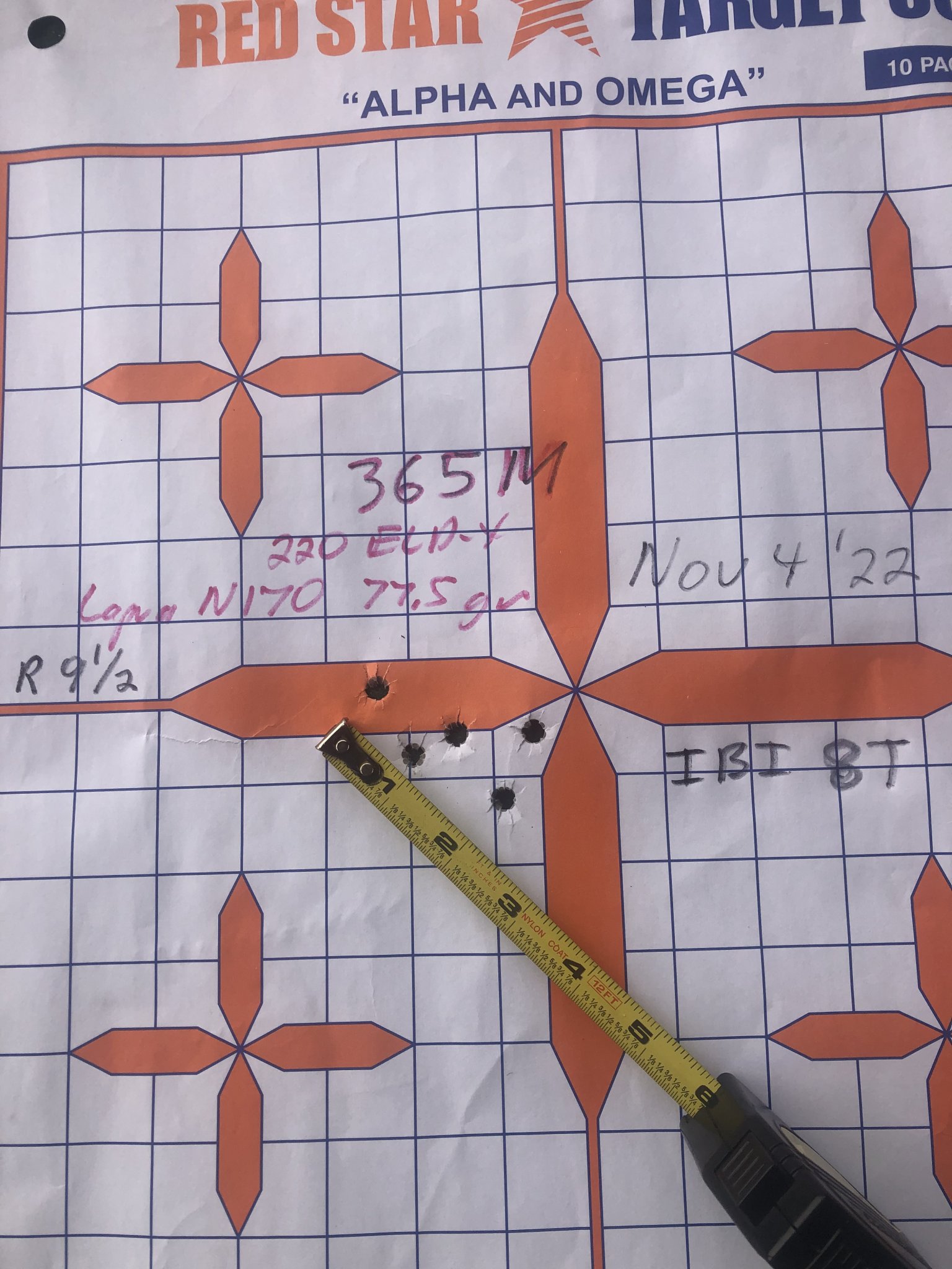

I moved up a 1/2 grain and got a solid 5 shot group at 365M today.
I’ll see if this is repeatable. It was the 4th loading of Lapua brass neck sized with a Redding die. I’ll start another batch until I have 100 4Xfired to anneal and then look for someone who has one.

26” barrel looks to be around 2830 or so. 77.5 N170 Rem 9 1/2 primers, Lapua brass, no pressure signs. It’s chilly out though. I need to rezero to make sure what the drop is 90M to 365M. The load is accurate so I’m doing positional practice now at 365M. With time and better weather I’ll chrono it too, but I don’t really care as long as it shoots well.
