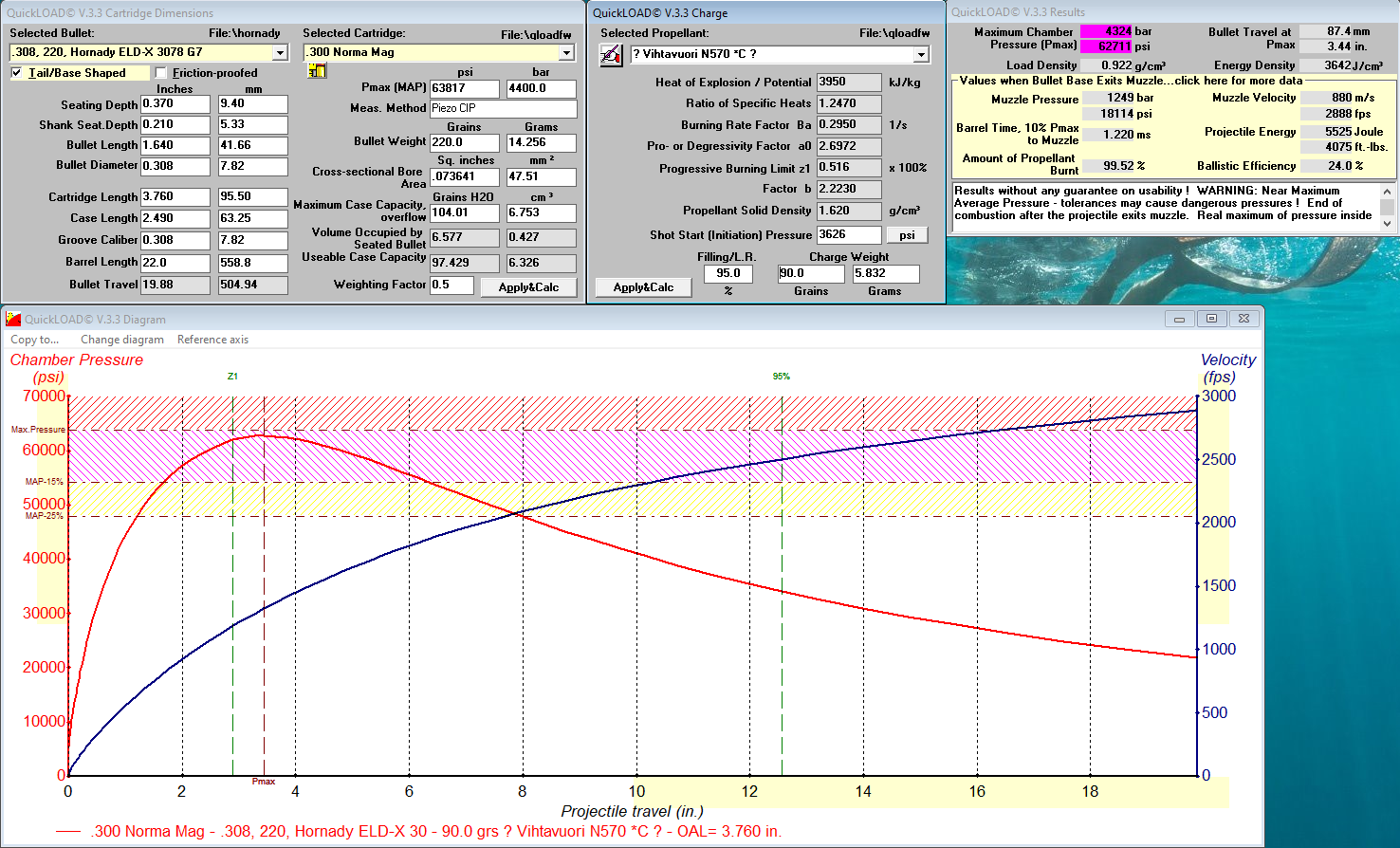

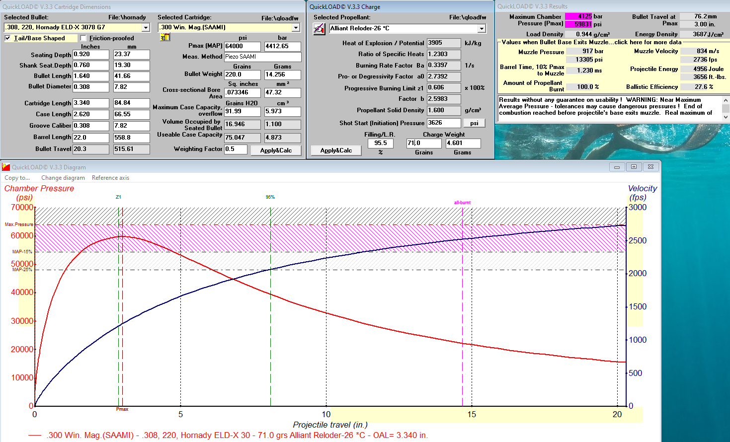

Crunching the numbers in QL, you're honestly not going to see a big improvement in velocity if you jump up to a .300NM. Don't get me wrong, .300NM owns, but if you've already got .300WM barrels, bolt, and reloading gear, it just make sense to stay with that cartridge.
.300NM shooting 220s @ 2888fps out of a 22" barrel
.300WM shooting same 220s @ 2736fps out of 22" barrel
Awesome, thanks for the data! Honestly 150fps might be worth it to me so I wonder how close that data is to real world results. I appreciate the info.
