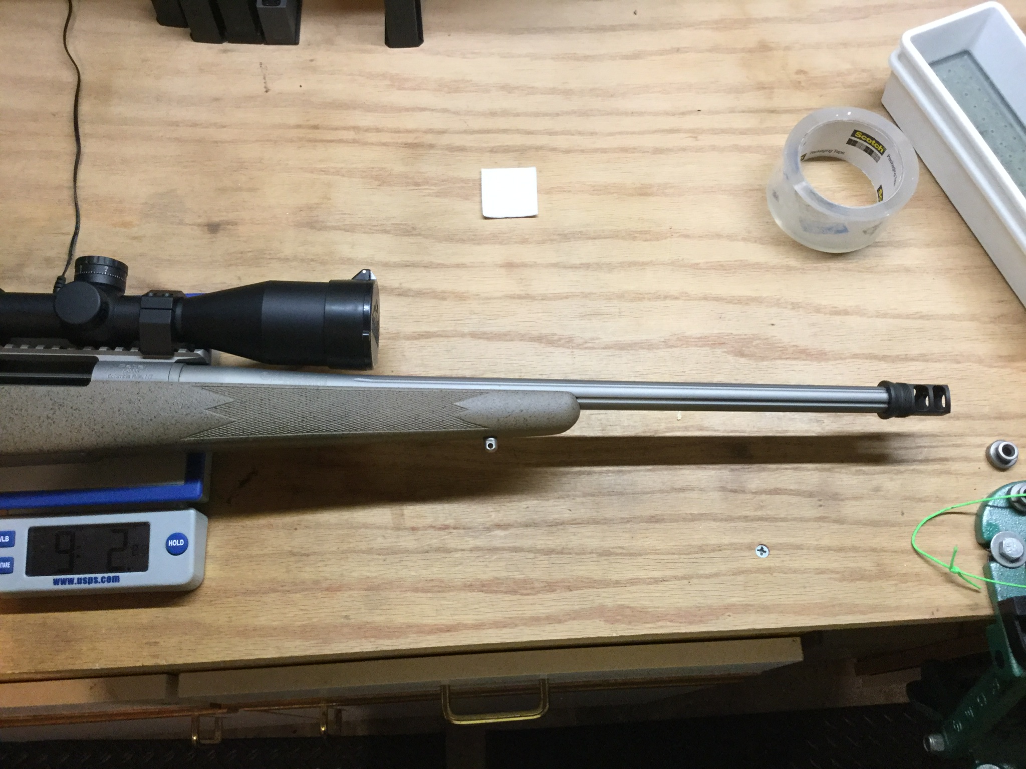

20” 300WSM, 10 twist Bartlein barrel. Factory Norma 180 Bondstrike is just over 2,900 fps.
I went 24" 9 twist 5R and it slings Fed 180 MeatEater coppers at average 3060 ES 13fps over 10 shot string 500ft elevation 71F.
It's a little portly at 9.5lbs (via bathroom scale so +/- 0.25lbs-ish) all up but I don't mind, sorta like Xtrem's rig above.

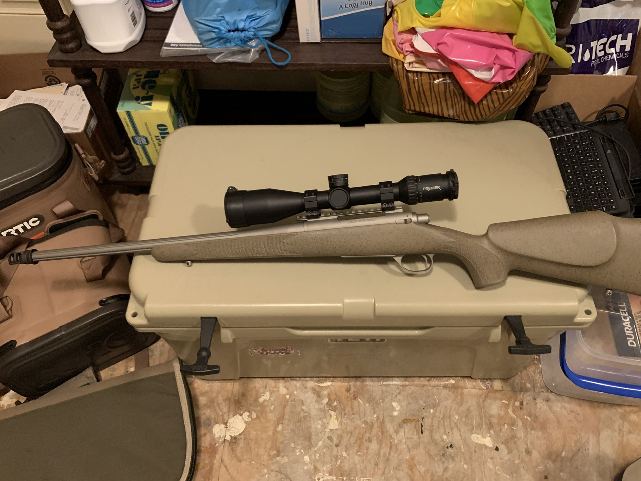

I hunt with a early Kimber Montana, in 300WSM,, FWIW, It has no trouble out to about 600, It could likely shoot farther but its sooo light that you have to control it through the recoil. Not easy with 180 Accubonds. its a < 8 lb gun fully fitted. MIne loves 180's 165's shoot OK but not at the longer distances.. Montana's have never been known to be a 1 hole gun,,, more like a "Minus elk-OA"
My brothers 300RUM kicks less. But weighs about 2x more.. He recently acquired a Sako in 7mm WSM and what a sweetheart. Mine may get downsized when the barrel gives up, or I just cant take the recoil any more.. Makes me wonder if you like the WSM footprint, the 7 would be a better choice? Lots of good ELD 7mm Bullets out there,, I believe there are also dies for a 6.5WSM..

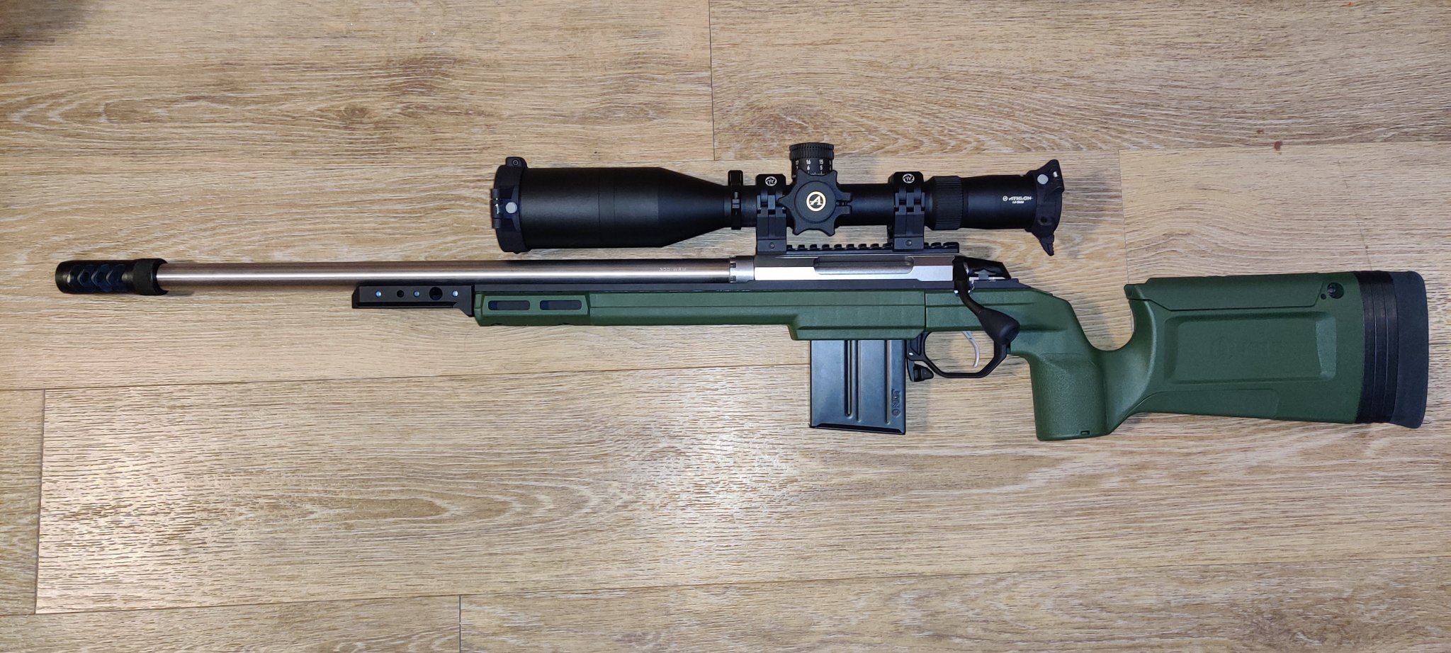

I actually thought a lot about the 7wsm but ended up going with a Tikka in 300wsm. I bought a spare factory 6.5PRC barrel for it though, and the rifle originally came with a 7rm barrel that I still have. It's currently just set up range shooting but the other barrels lighten it up a bit.
