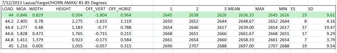

    Thanks to all for the info.I generally don't mind the effort to work up loads,but I find it's getting harder to get out and shoot as much as I would like to(which is pretty much all the time).This gun is so much fun to shoot,but I'm always looking for just a little better load.
    I played with one run in my 700/5R. For reasons I can't remember, I wasn't that impressed with them. Clearly wasn't on my game that day and that may have jaded my impressions.
    Here's the data with the usual warnings, work up, my rifle, etc.
