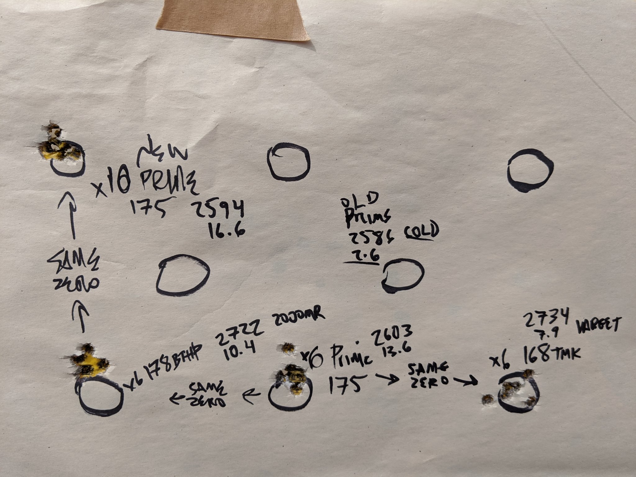

    I finally got out today to test 2 handloads at 100y.
    One batch of 6 was with 46.8 grains of 2000MR and 178BTHPs in virgin Lapua with CCI BR2s. OAL @ 2.87", almost mag length in my MDT mags with plates in them.
    Other batch of 6 was 44.1 grains of Varget and 168 TMKs at mag length of 2.88" in virgin Lapua with BR2s. Shot @1moa, meh.
    This 178bthp/2000MR load shot well @ 2722 fps, SD @10, @ .5 moa, but I only brought 6, saving 99 for a match.
    Happy with the results @.5moa for the 6.
    My Prime175 is the go-to load, accurate but slow, you can see my 10-shot group top left to end the day, @.5 moa. 178/2000MR was close, and only minor vertical zero shift.

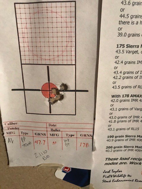

    Straydog,
    Curious if you measured the jump to the lands with your 178's? I see you mentioned "a couple hundredths off jam". I'm wondering if the 178BTHP is jump sensitive? I think I have to jump them more.
    I used 47.5gr2000MR/178BTHP/LapuaPalma/Rem7.5 for a recent Palma course practice match in my Armalite AR10. 800 yards is usually a pretty easy yardline all things considered and I was kind of all over the 10 ring instead of solidly in the middle. 900 was about the same, not many X's but mostly loose 10's.
    If you want a really nice setup try 49.5gr2000MR/168BergerHybrid/Palmabrass/REM7.5/2.94" in my chamber. Shot really well, much better than the 178's. right on call , better group at 1000 than 900.
    I'll dig up the notes tonight and edit this post.
    I ran the #s thru shooter, and I'm not really gaining anything much on wind, maybe .3 mils at 1k yards in 10mph with 178 bthp, 175 smks, 168 tmks, so I may just stick with the 175smk and shoot for 2750+ with 2000MR.
    I think the 178 is a little jump sensitive, but not too much. Rob01 has some pet loads in old threads to search for. I just loaded long for mag length and got lucky on my 1st batch. I also only shot to 100 on that day!

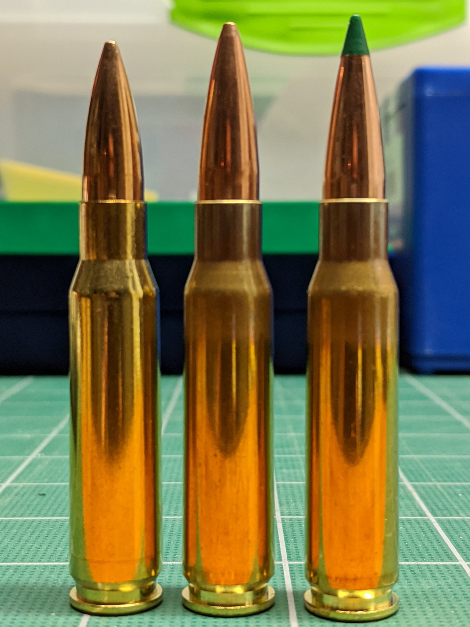

    following up: fianlly loaded some 46 grains of 2000mr in Prime .308 LRP x1 fired, full length resized, with 185 Jugs at 2.84" OAL, cci 200s.
    Nice tight group of 5 at 100yds.
    This was 185 FGMM, for reference, speeds were about the same 2600 out of 22" 1-10.
    My 46.0 load was @ 2615 fps, SD was low teens. Rifle was zeroed weeks ago on new barrel with old 175 Prime factory.
    This was 45.7 2000mr, wanted to test another lower load to start, didn't turn out well... and was @2580-ish.
