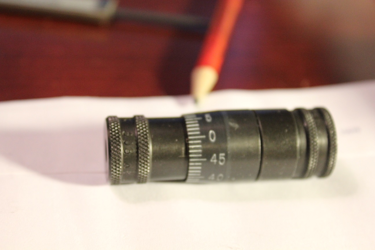

Did you actually "zero" your RCBS precision Mic using a 1.630" headspace Go gauge? Sometimes, the RCBS mic can be a little off from true 1.630". You can go with the numbers you are using since they are a reference off of the gauges "0" point.
I don't know why you are mentioning neck sizing for these rifles, you should never neck size for autoloaders, always F/L size.
Didn't know about zeroing with a go gauge. I figured it could be off but wasn't sure how to get a conclusive calibration so I'll pick one of those up.

You don't really need to zero your precision mic with a 1.630" Go gauge. Save your money. If you are curious, just ask your local gunsmith if he could put his 1.630" Go gauge in your RCBS mic and see what it reads on the dial, then make a note. That's what I did with my Hornady gauge. Using the RCBS gauge as is, is fine. The numbers are relative to what you are doing.
There was a thread here not too long ago where a member zeroed his RCBS mic with a 1.630 Go gauge and he found the RCBS mic read -.002", not at the 0 mark he expected it to. Only if you needed to know the exact 1.630" measurement in your chamber. My Hornady Headspace / shoulder .400" bump insert reads 1.611" on a 1.630" Go gauge. This is because my gauge has a .019" chamfer on it's rim, that's why it reads .019" short of 1.630". I made notes of this and any shoulder bumping @ 1.611" is actually 1.630". I just read the gauge where it reads. If I have a case that reads 1.614", it is .003" over the 1.611" (1.630" minimum).

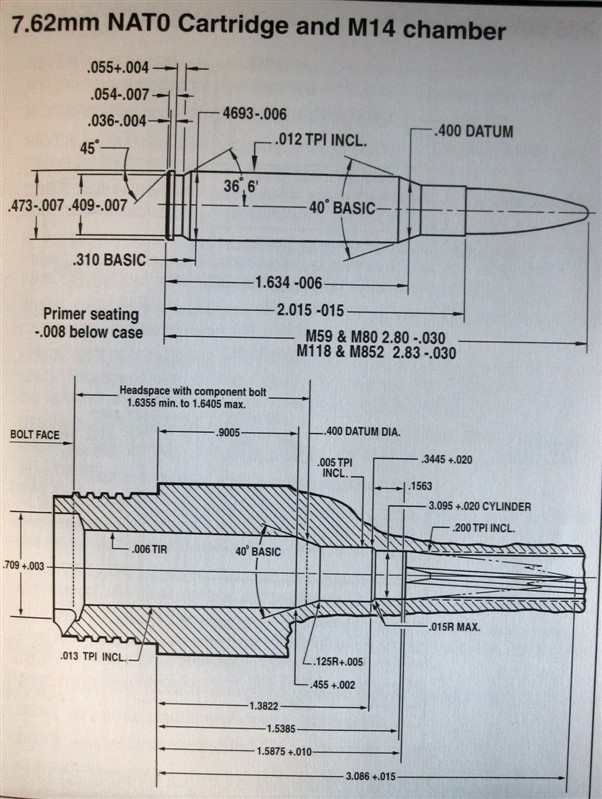

Another note, on my Remington Custom Shop 40 XBKS, the stainless barrel is actually marked "7.62 NATO" for the caliber, not 308 Winchester, but the chamber is in the low (tighter) end of the 308 Winchester SAAMI specs. It can get confusing.
As far as the chamber head space specs between 308 and 7.62 NATO, I get a little different numbers than you did.
7.62 NATO GO: 1.6355" / NO GO: 1.6405"/ Field Reject: 1.6455"
308 Winchester Go: 1.6300" / NO GO: 1.6340" / Field reject: 1.6380"
7.62 NATO has a bit more headspace allowed.
Just measure the cases fired in your rifles using your RCBS gauge and shoulder bump from there.
Don't worry about the pressure differences between the two. You don't have pressure measuring equipment anyway. You load ammo that is safe to shoot in your rifles without showing excessive pressure signs.
Traditionally "military" chambers are larger in diameter and longer in headspace than SAAMI civilian specifications. You can forget the headaches your reloading dies are made to SAAMI specifacations and all you need worry about is the correct shoulder bump with "YOUR" fired cases.
Will do. These were my sources for the specs. Looks like the 1.6300-1.6400 SAAMI values provided in the RCBS precision mic pamphlet must correspond to the chamber spec, not the case range as suggested?

You don't really need to zero your precision mic with a 1.630" Go gauge. Save your money. If you are curious, just ask your local gunsmith if he could put his 1.630" Go gauge in your RCBS mic and see what it reads on the dial, then make a note. .
Flight762: thanks for the continued education. I went ahead and got a forster FIELD, primarily to zero the mic but figured if I was going to buy one HS gauge that would be the most useful one. My mic reads about .0015 under the gauge. Not sure to what precision forster can produce stuff, I figure +/- .001 would be impressive so that would make it tough to say for sure which gauge was right, seems like the important thing is that they're close.

RCBS Precision MIC as compared to the Reddding Instant Indicator / Case Comparator
This thread is of particular interest to me, as it touches on just exactly what I was searching for on the google. What really sparked my interest is the comment about someone putting their "Go Gauge" in the RCBS precision mic, and it was off. I have been reloading .308 for about a year now, and as I learned more about it, I ordered both the RCBS Precision MIC, and the Redding instant Indicator / Case Comparator. So, I put the brass "Set up Gage" for the Redding II/CC into the RCBS P. MIC, and I was surprised to find that it read .004" under the SAAMI minimum standard. The instruction booklet for the Pre. MIC say it is set to "zero" at the minimum of 1.630". I was looking for a "zero" reading. I measured the brass set up gauge with a Mitutoyo digimatic from the bottom of the case, to datum line, and it seems to be right on the money at 1.63. I get the feeling that the brass insert for the Redding II/CC is right on spec, and that the RCBS Pre. MIC is off by .004" (relative to the Redding). But after reading this thread, I think not to agonize about the difference, and concentrate more on the comparative readings that I get, as I use them to set up my dies. I like the RCBS Pre. MIC, it's handy and easy to use. I think that Redding II/CC to be an incredibly accurate measuring device. I have read this thread several times now, and thanks to all for the intricate, but easy to read / understand common sense approach to the subject. Awesome guys, outstanding information!

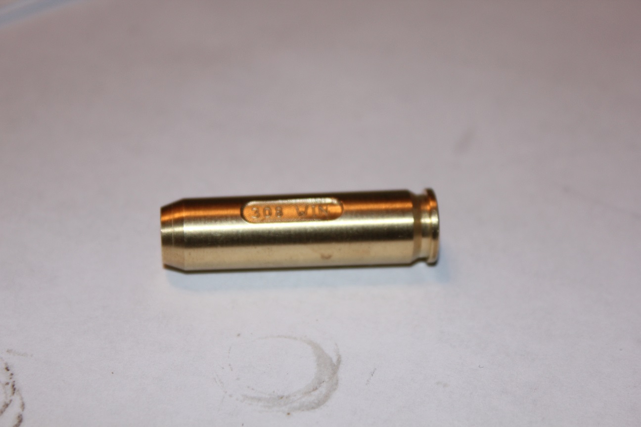

Lancer, thanks for posting. I am not familiar with this setup (that particular caliper or the brass gauge) so I am curious about a few details...is there a feature on either/both part(s) that ensures precise measurement to the datum line? Also, was the digimatic reading only to the hundredth inch? Sorry if this is a dumb question but if we were rounding to the hundredth with 4 thou in dispute it seems like the rcbs could still be very close to dead-on.
dmike, the "brass set up" gauge comes with the Redding Instant Indicator / Case Comparator. It is a brass mock cartridge case that just extends to the shoulder, so the datum line (as per SAAMI specs) can used to zero out the dial gauge.Redding Set up gauge.jpg. What I noticed is that the brass insert from Redding, measures "less than" the minimum standard of 1.630. In the RCBS Precision MIC, it measures to be 1.626, which is .004 (four one thousands) of an in short (more headspace). However, when I measure it with a digital caliper, it seems to be right on the money at 1.630 (as close as I can get it). The Mitutoyo Digimatic is just a digital caliper, and it measures to .001, or one thousandth of an inch. Your's is not a dumb question. This can be confusing. All I am trying to say is that in the RCBS Precision MIC, the Redding brass insert measures "short". With a digital caliper, it measures just right. That's why I thing the brass insert that Redding provides, is a near perfect representation of where the datum line should be with a .308 Winchester cartridge.

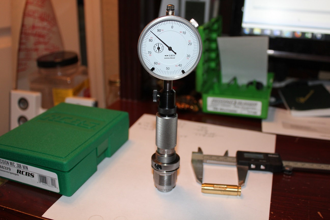

These are an array of the instruments I'm using; Redding Instant Indicator, and the RCBS Precision MIC.
You can see the large Dial Indicator, Redding supplies the brass insert so you can set your dial to zero in terms of where you compare your own, fired cases to. It does not "Fix" anything, it just allows you to compare the headspace measurement of your cases, to the SAAMI standard (as provided by the brass insert "set up gauge).

dmike, the "brass set up" gauge comes with the Redding Instant Indicator / Case Comparator. It is a brass mock cartridge case that just extends to the shoulder, so the datum line (as per SAAMI specs) can used to zero out the dial gauge.View attachment 31530. What I noticed is that the brass insert from Redding, measures "less than" the minimum standard of 1.630. In the RCBS Precision MIC, it measures to be 1.626, which is .004 (four one thousands) of an in short (more headspace). However, when I measure it with a digital caliper, it seems to be right on the money at 1.630 (as close as I can get it).
thanks for the info and the pics, I was not familiar with that product. I like the idea of a flat at the .400 datum line, FWIW I believe SAAMI spec is "1.634-.007" so it seems like that would put the minimum at 1.627. Not sure what the Redding paperwork says whether it's just "minimum" or if it specifically claims 1.630 to the flat but if it was just a SAAMI minimum value to zero the dial gauge then the mic might not be that far off. I have heard from folks on other threads that there aren't a lot of products available that give precise resolution of these distances...like the hornady comparator being about 2 hundredths off due to chamfer etc.
regardless I'm sure indexing the mic markings to .001 during manufacture is tough so I wouldn't be surprised if they were off sometimes. Limited to common tools, it's tough to know for sure which product really has the .400 datum line exactly 1.630 from the base (go gauge vs comparator vs mic vs brass gauge etc).
