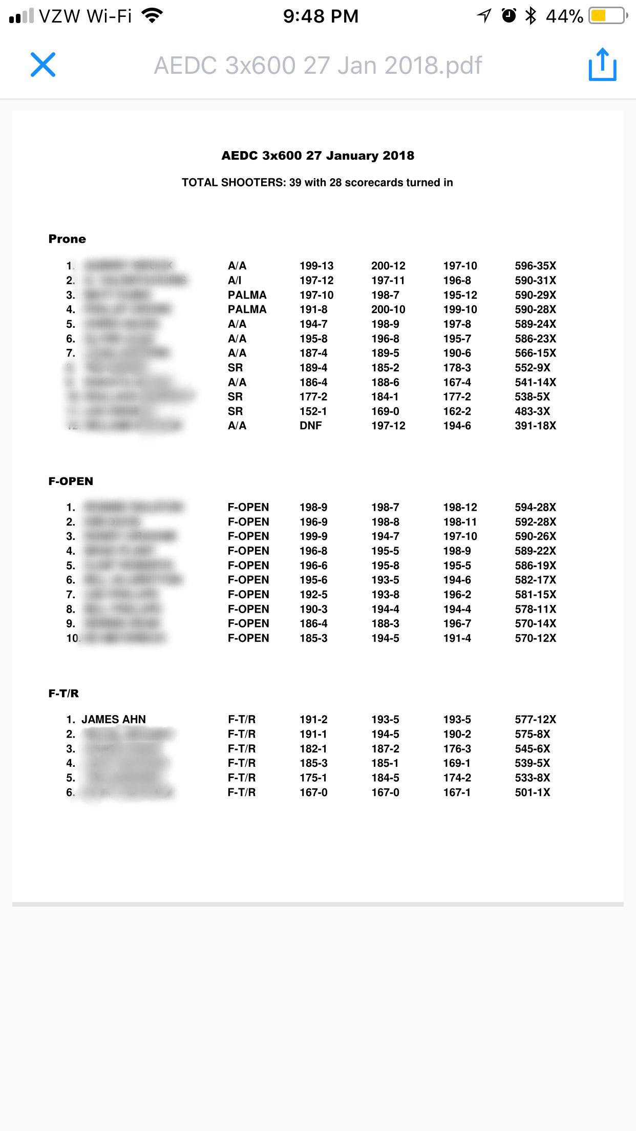

Just scored first in my class this past weekend shooting 600 FT-R
Used alpha SRP. Had a hot load.. but my alpha brass shot very very well.
I just neck turned to skim .001/.0015 off the necks and backed my charge down a hair
