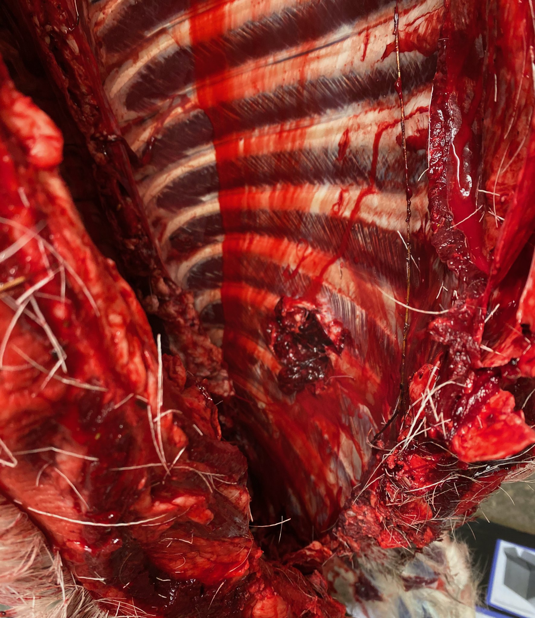

Good call skipping the Bergers, I've hunted with them for years and had some really poor results. Blow ups and pencil holes no consistency.
I got tired of meat contamination with lead core bullets so I switched to Barnes LRX this year.
If the eldx gives you issues maybe go with the copper bullets, the nice thing is that if a buck comes running in you can shoot him in the chest, or shoulder and won't make a shrapnel mess
