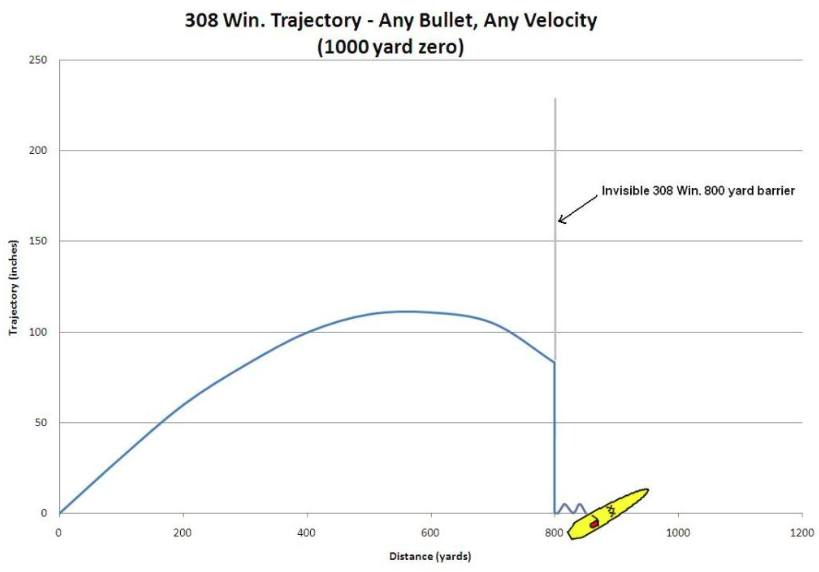

I have to say, I'm a bit disappointed with Hide member's responses.
10 responses so far and not a SINGLE admonition to the OP to give up on the pathetic, anemic .308 and choose the magical 6.5 instead. Come on guys, you're better than this. He may as well throw rocks at the target if he's going with a .308 :)
Reactions: buffalowinter
that ship has passed.
the 308 is so useless and pathetic now that most guys dont even click on a post that has "308" in the name.
lol
308 is only as useless as the shooter behind it :)
308 can do anything a 6.5 can do generally <1000 yards or less

The "800yd death veil" means less to me at 4200ft altitude than it would to those lesser beings infesting the lower altitudes; on paper, the168SMK launched at 2700fps is still transsonic at 1000yd, up here near Olympus where I live. Theya Fowah, the 308 is still every much as good a performer today as it ever was; it's just been overtaken by some newer alternatives.
You're gonna need ammunition in the 175gr-ish category (308FGMM2 Federal Gold Medal Match 2) to play nice out at 1000yd, and when it gets out there, some of those newer youngster chamberings will be lying in the tall grass, waiting for that golden opportunity to savage the oldster 308. Do you need to be a better shooter at 1000yd with the 308? Some would say yes; but truthfully, my response would be that everyone who plays out there needs to bring their best game.
