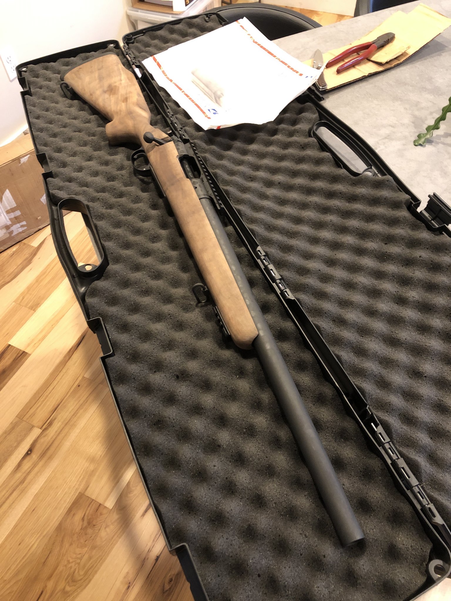

    I'll drag this one back to the top for a minute. I was going to post a similar thread then I found this one.
    I think the time has come to rebarrel my 308 700LTR. It'll still hammer out to 600 but it starts getting really wild around 750. It never has cared for anything at or above the 175gr range in bullets but it loves a 168smk and it's done pretty well with a 155 Amax. Out to 750ish. Past that it goes nuts.
    Around 800 it struggles to hit C zone size steel and out to 1000 you're looking at about 5-6 moa with the 155's that are routinely under half moa at 100. I don't rember my muzzle velocity but it was close to 2800fps I believe from its factory 20" barrel.
    So here's my dilemma, what twist to I go with. Looking through this thread it looks like anything in the 10-12 should do just fine. Would it hurt anything to go faster ? I don't shoot lite bullets from this gun.
    I had a 16" 1:8 lilja that started life as a 300blk when it first came out but it wasn't long until I lost interest in that thing and I had it rechambered to 308. It shot factory 168gr hornady match into one hole at 100 yards. Sold that rifle to my cousin and his favorite load for it is the precision hunter 178. I've tried to buy that rifle back from him a half dozen times but he ain't having it.
    So going off of past experiences with a sample size of one, the faster twist is appealing to me at the lower velocity of a 20" barrel. Seems like it would give better stability at distance, or am I wrong in my line of thinking there ?

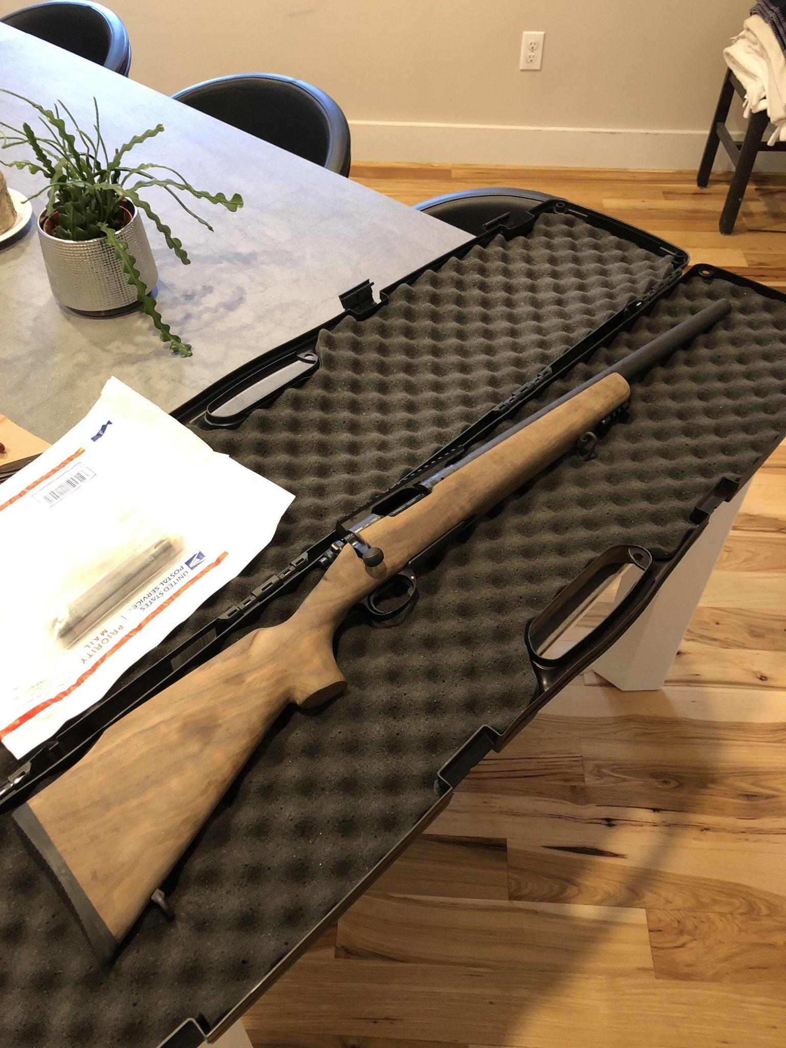

    I found a 9 twist bartlein m24 at Altus in stock. I may just pull the trigger on it. Cut at 20" it's gonna be thick on the muzzle end lol.
    Thicc is good.......M24 is like pencil diameter.
