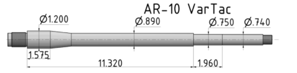

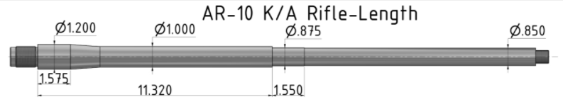

I can either go with 1.00" under the handguard, .875 gas block, and .850" after the gas block, or I can go with .890 under the handguard and .750" from the gas block to muzzle. The latter being about 1/2 pound lighter. Thoughts?

They have both in premades, the KA profile is the 1.000/.875gb/.850 profile and the Vartac is the .890/.750gb/.740 profile. I was pretty much settled on the vartac but now I'm kind of second guessing.

8 oz. in the barrel would only matter if you're carrying it to me. I'd take the extra material to heat up longer (and cool down longer) if it were mine.
I ended up going with the heavy profile. I figure with intent to add a bipod and maybe a suppressor in the future it's already going to be heavy, and with the goal being accuracy I might as well make the best of it. What's another 1/2lb.
