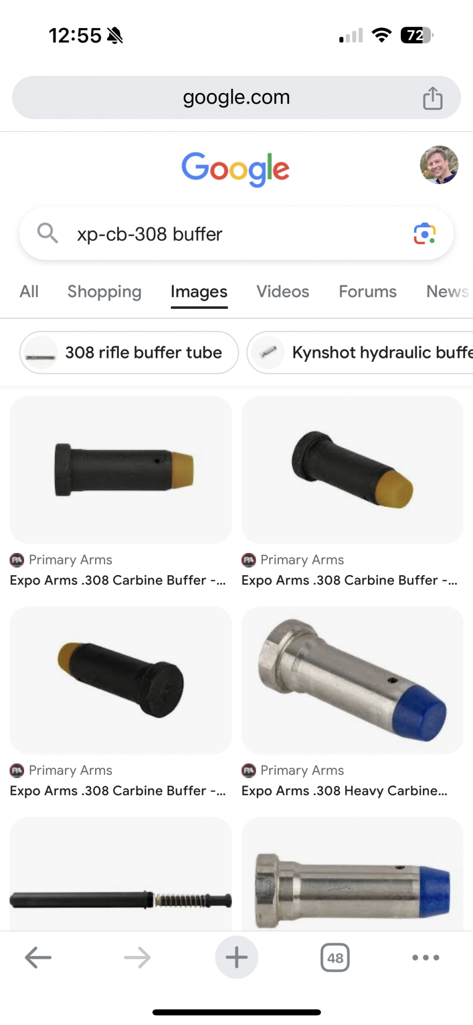

It’s the Expo arms shorty 308, see image. There’s also no wear marks indicating the carrier is dragging on the hammer. If I run the BCG into the buffer without the upper receiver it goes back far enough for the catch. If I run it with charging handle it stops short. The weapon cycles fine with this buffer and a regular H2.

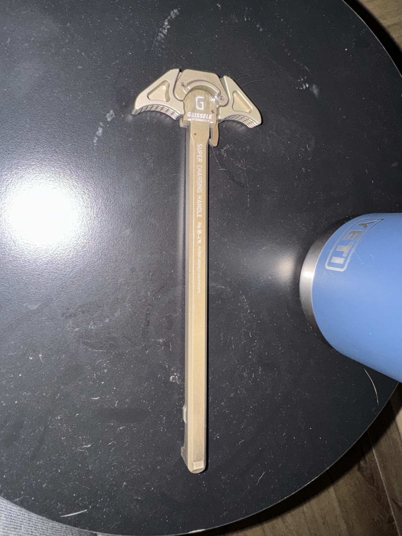

What charging handle ? Pics please.
I know it might be silly, but you do have a charging handle for LFAR ? .. right ?

Here’s the charging handle, but I’ll need to measure the tube depth in a bit.
