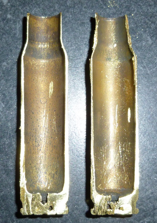

Just keep in mind that different brands of 308 brass had different internal capacity’s
