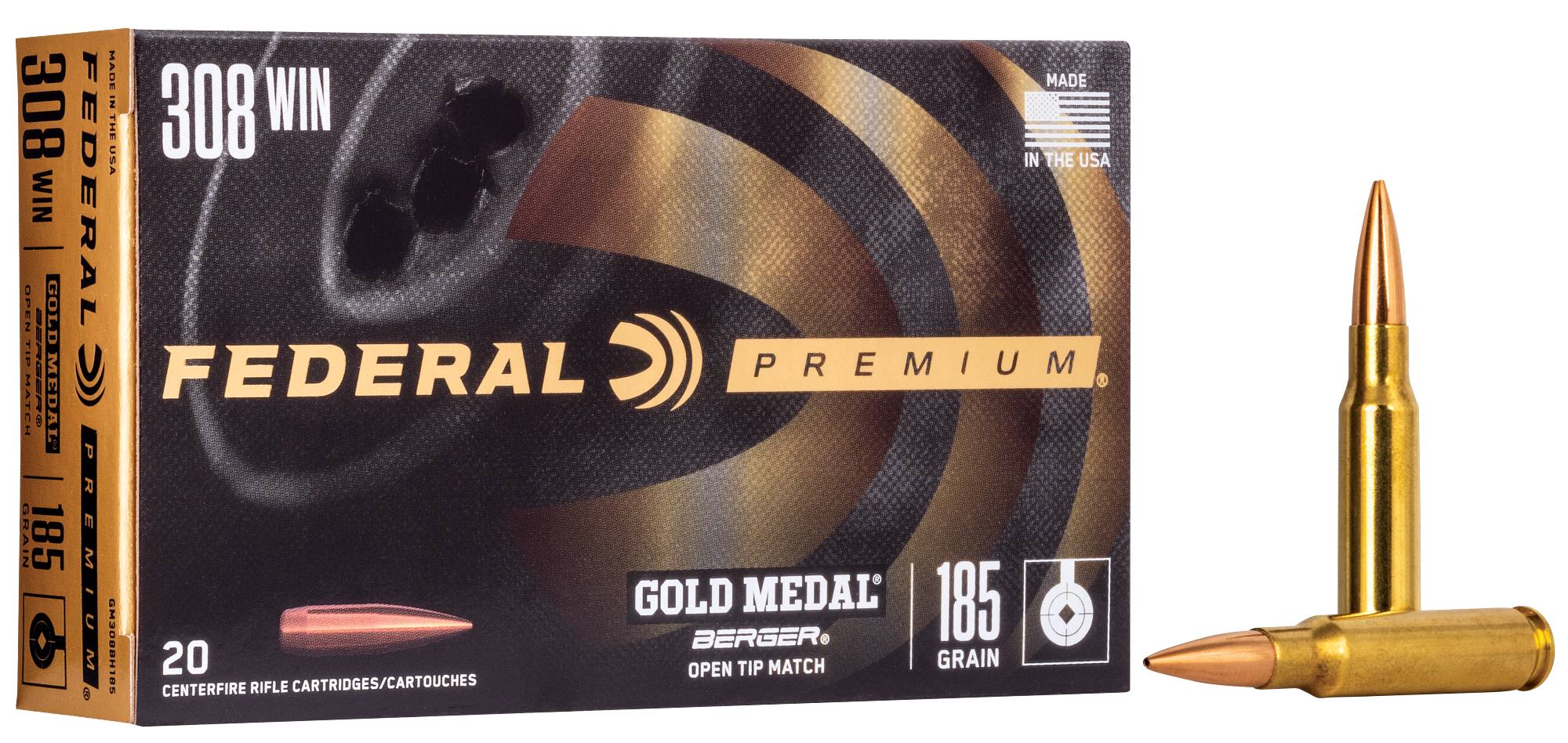

The 185 juggernaut is appealing. How fast are you pushing the 155's?
All of this said...I'm looking for simplicity on this and marginal gains are the lowest on my list
Federal makes a GM load with this bullet.

I was not talking about Berger ammo but the Federal loaded with the 185 Juggernaut. An ammo with a better bc and a bullet known for accuracy.
I have not personally shot the Federal 185 Juggernaut load but have friends who do and love it. I have shot a bunch of lots of 168 ELDs in three rifles and they were all accurate. He originally asked if Fed 175 SMK is still the gold standard and it’s not in my opinion and neither is the 175 SMk bullet for loading.
If he wants to shoot them then that’s his money to spend. Just trying to help him as consistent ammo and better BC and performance are not mutually exclusive. Having both is possible.

Sounds like this is pretty much it and you have it dead on. Seems the 185 juggernaut is respected and can be found somewhat easily. I'll see if that's the route I go down.
It's a .308 win at the end of the day. Just want to go shoot it, with a repeatable and readily available round, while I fuss with my other guns.

Thanks for the help folks!
I'll be looking into the fgmm 175 smk and 185 juggernaut, as well as the hornady eld loadings, either the 168 or 178. The 169smk is intriguing, but lack of factory ammo will probably stop me.
Leaning towards the 185 juggernaut as it is surprisingly impressive, I'm curious to see the velocity from my 26" barrel.
Thanks again for the introductions to new bullets, and this cartridge.

I’ve shot both of these bullets in my 308 and the 185s are really sweet. If you’re going to shoot factory ammo, get the Berger 185 factory load. If you decide to reload for your 308 later on you end up with Lapua brass fire formed to your chamber. If you’re not going to reload, then the Federal 185 Berger load will likely save you some money. Good luck.
