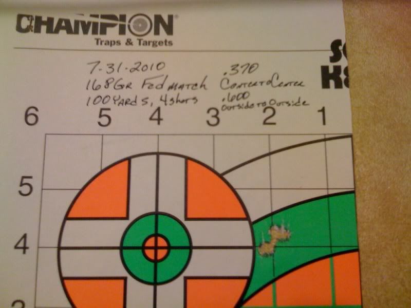

I just bought a NIB Rem 700 SPS and after gathering up all the reloading stuff I checked my chamber with a dummy round (fired case and a 168gr Berger VLD). It measured 3.233! That is way longer than sammi 2.800. I realize most guns are a tad longer than spec but that is almost a 1/2 inch! Has anyone run into this before on these guns. I have shot Federal gold medal match 168 and 175 grain loads at 100 yards and gotten several .3 inch groups with said gun. Any suggestions or should I just not worry about it.

<div class="ubbcode-block"><div class="ubbcode-header">Originally Posted By: Fuzzball</div><div class="ubbcode-body">You're getting .3 moa from a new factory rifle and want to know if you should "worry" about it?
I wouldn't. </div></div>
I don't like buying premium ammo. I want to "roll my own" if I can.

<div class="ubbcode-block"><div class="ubbcode-header">Originally Posted By: Swan</div><div class="ubbcode-body">.3moa from a factory rifle?! Damnit, why did I spend so much on a custom rifle?... </div></div>
I feel like I got lucky on this one BUT I did have to put a custom stock on it. The Houge POS went away...Jim
