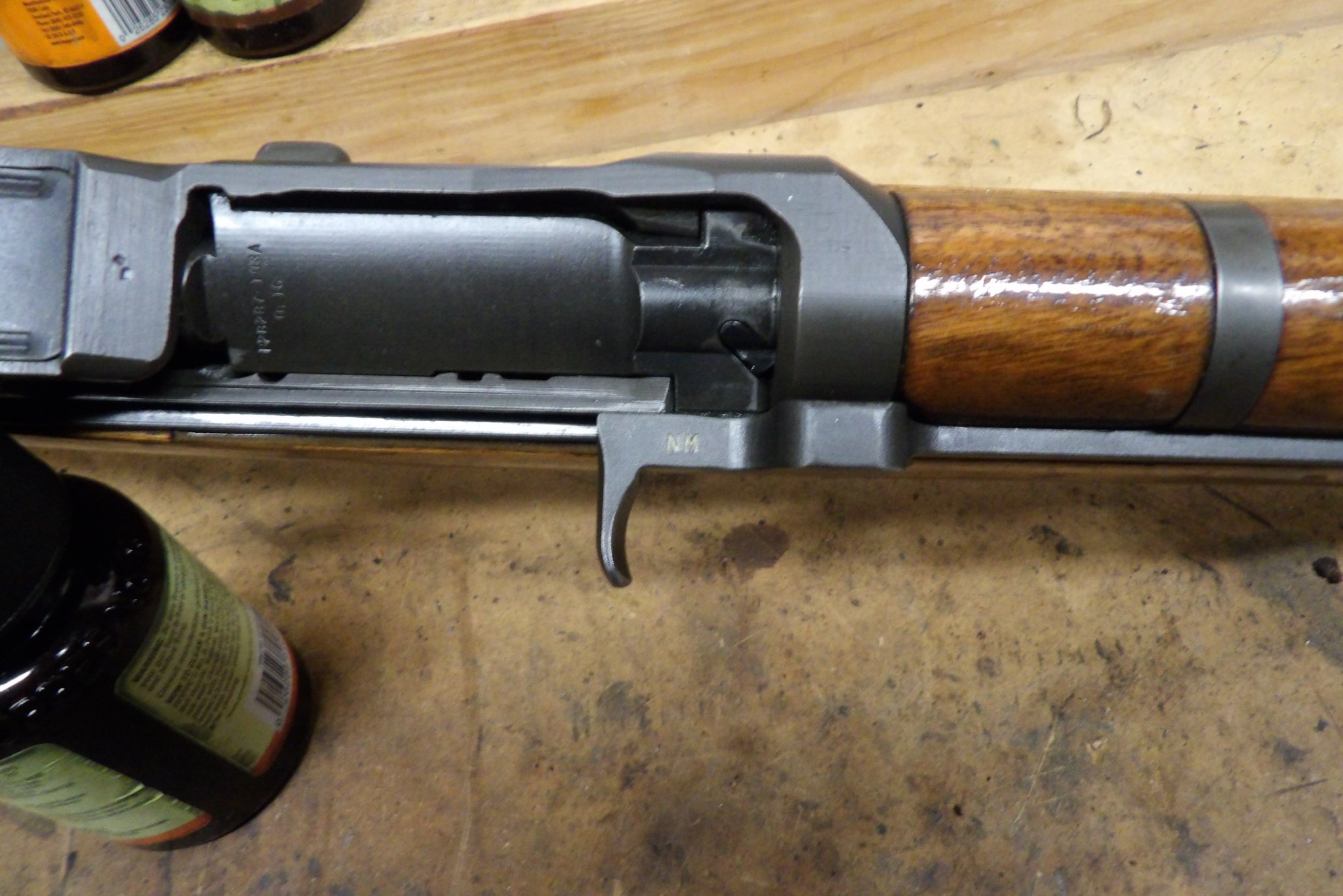

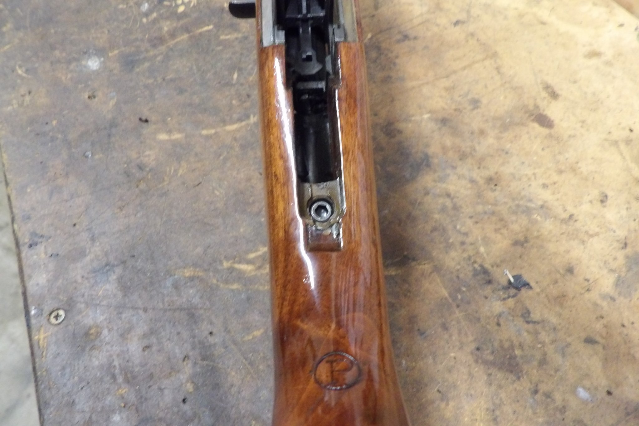

I've owned a .308 M1 Garand for several years. I wanted to be able to shoot commercial ammunition if GI ball was not available. I installed a Garand Gear gas plug, shot Winchester, Federal and Remington 150g .308 Winchester ammunition and have not noticed any unusual op rod wear. Even with the Garand Gear gas plug, I won't shoot any projectiles heavier than 168g in my reloads.
