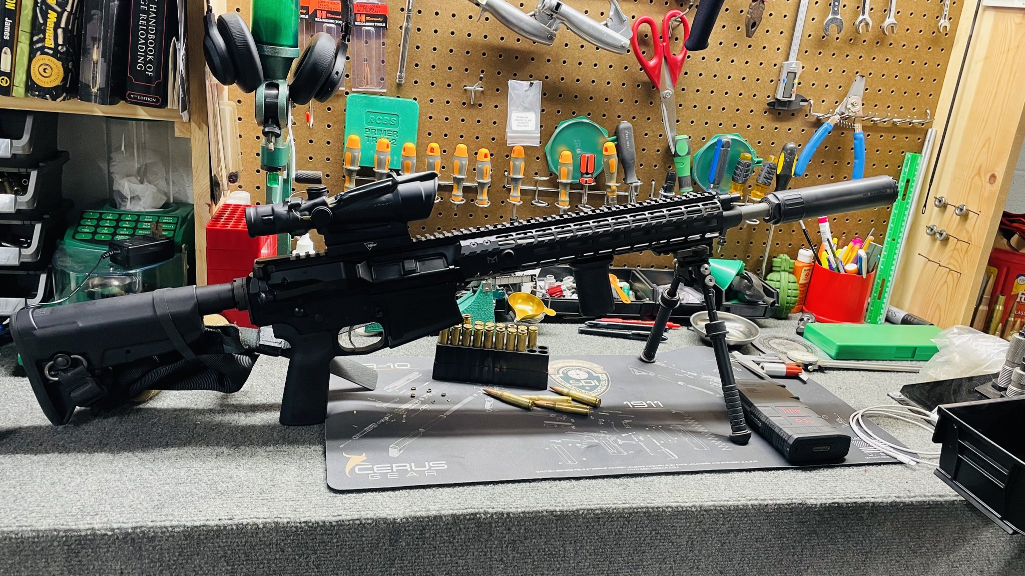

I run it on my DPMS LR308 build. It’s a Noveske N6 barrel with their switchblock GB. I’ve had some issues with some ammo, one in particular, but I think it was more to do with that ammo brand and not the rifle. It shoots FGMM 175 like a sewing machine.

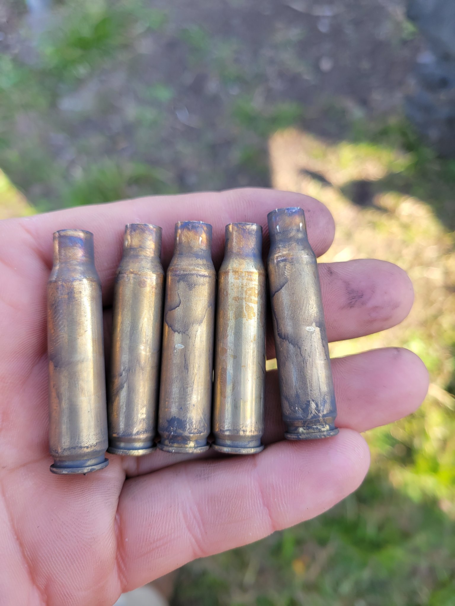

What do your fired cases look like ? Mine usually come out looking like a di gun without an adjustable gas block.
These are the best of the bunch After the new gas block from pws. This one is three position, old one was four. Thought I had a pic of the bad ones, they were just about black. Ejection usually runs 1:30-2:00.
Yeah they come out pretty raunchy but I shoot mostly suppressed. I don’t really recall what they looked like unsuppressed. I’m still trying to tune the rifle with buffer weight and spring tension. Since the OSS can reduces the increased gas blowback known for running suppressed, the rifle does not wanna cycle properly when the GB is on the “suppressed” setting. I have to run it on the “unstressed” setting and now it’s way over gassed with the can mounted. I’ve got several springs and weights and a few boxes of FGMM 175 and Black Hills 168 amd plan on heading to the range tomorrow to try it get it tuned properly. I used to only shoot reloads in this rifle so I was able yo tune the load to the gun/can/GB combo but now I’m shouting facotry match stuff, it seems to be out of tune.

Mine is shot suppressed 99% of the time. The brass in that pic was fired using my silencerco omega. Currently this pws is running the factory spring with an Xtra heavy carbine buffer. I ran a stiffer spring for a while but I got better accuracy with the stock spring/heavy buffer setup.
