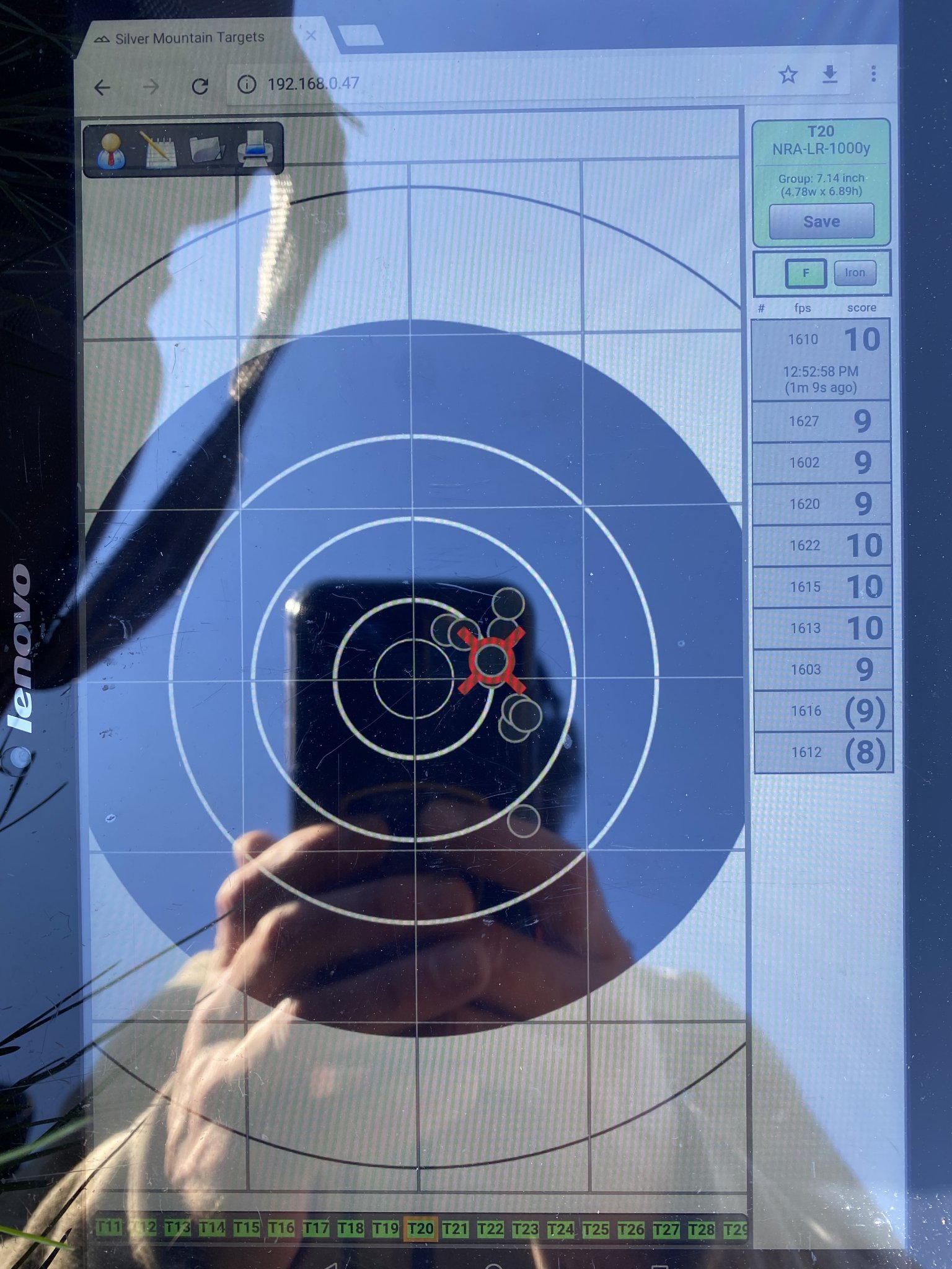

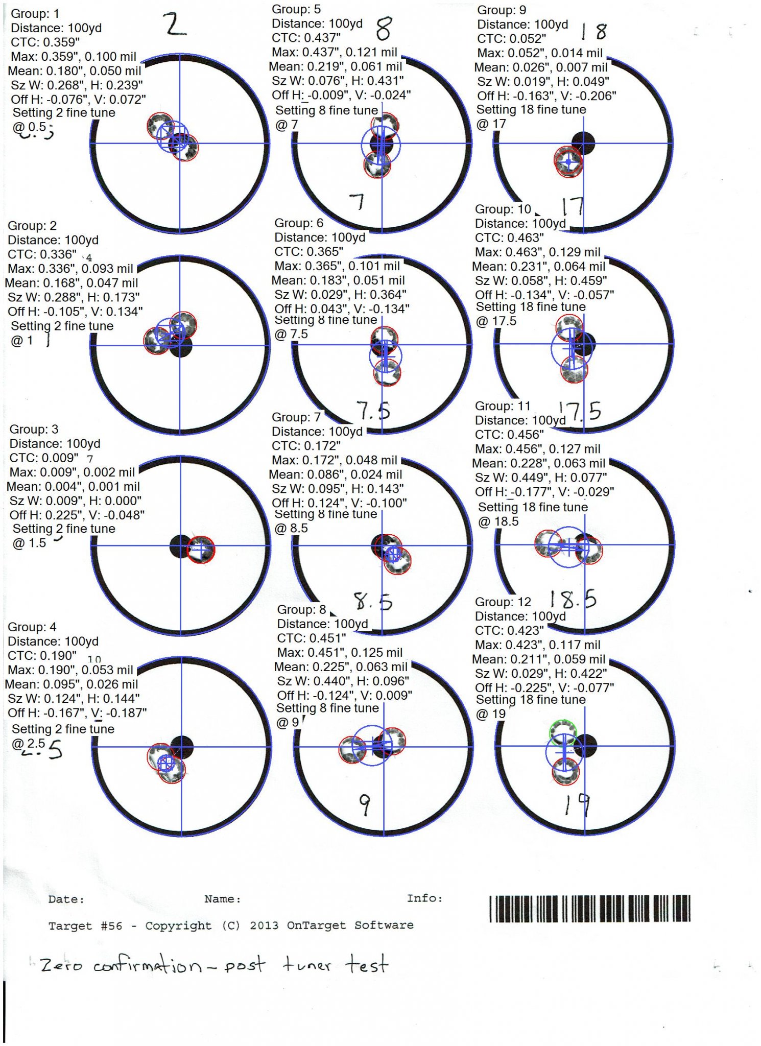

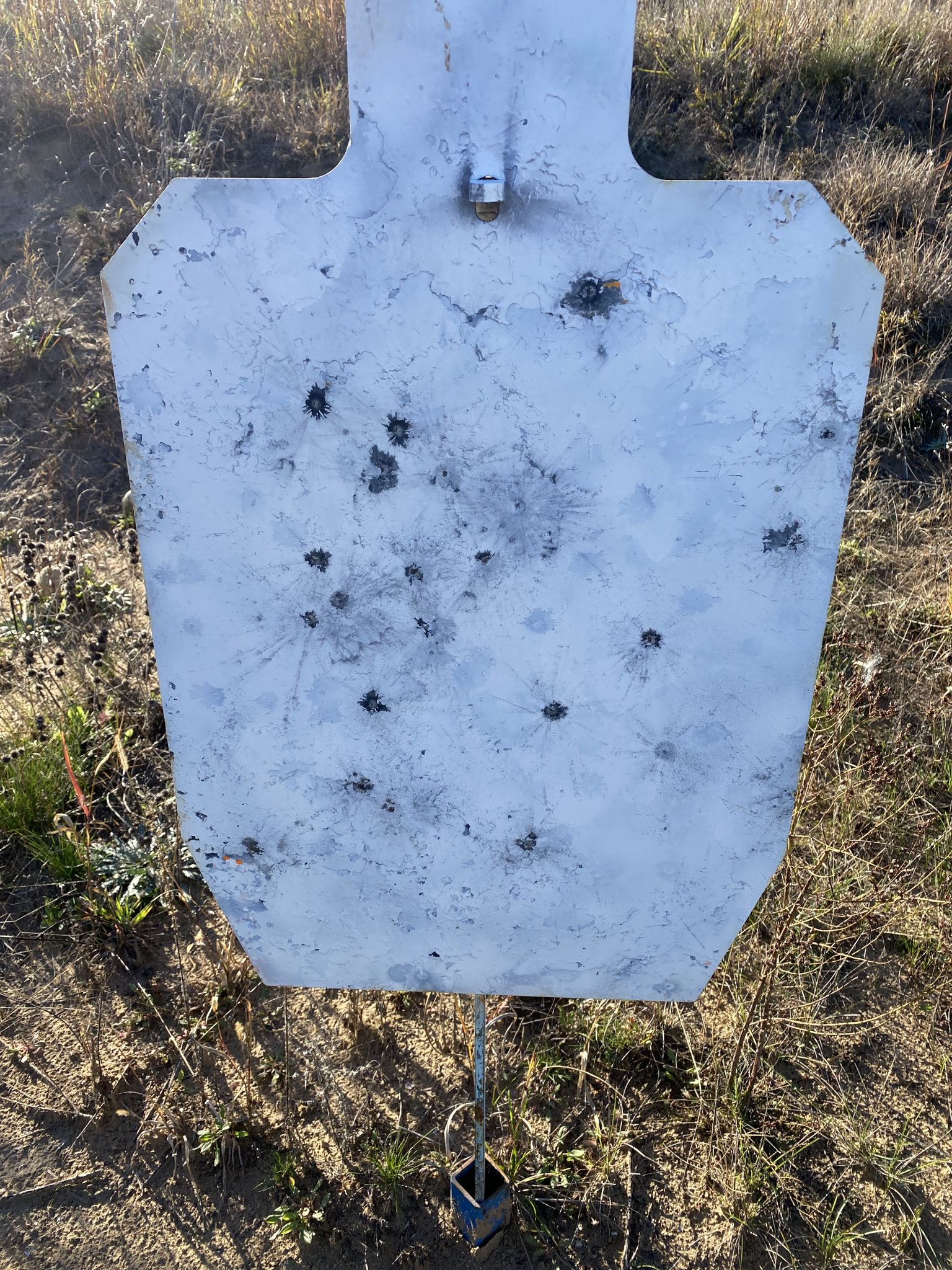

This is with 175gr Scenar-L with IMR 4064 @ 42.1gr 2590mv
Steel was at 1165yds
shotmarker at 600yds
all shot from a bipod and a rear bag
All the bullets were pulled and reseated to adjust the charge weight.
