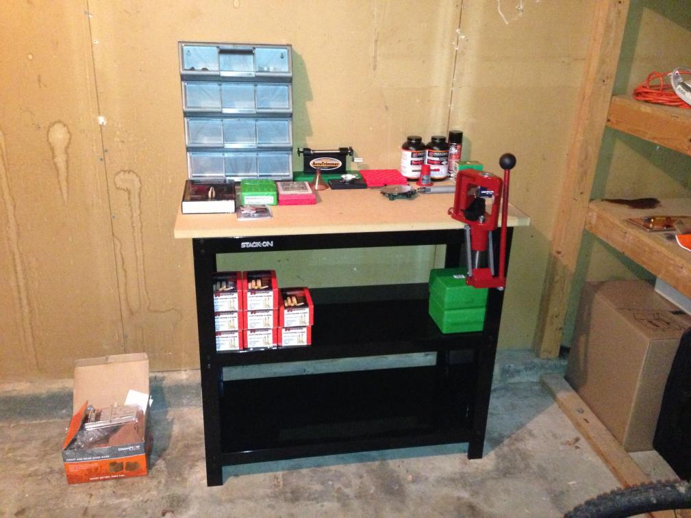

I just set up my first reloading station got everything i need to load .. the son and I will be giving it a go this weekend i have a 1/12 twist remington 700 sps tactical 20in heavy barrel ... any good loads been working for people i have sierra match king BT 155 grain bullets ATM and some 168 grain on the way I hear people get good results with 168 with my firearm .. well any advice would be great also im using varget powder any advice not just loads would be appreciated
thanks in advance !

My advise would be to keep building onto that bench, you're going to need the room, LOL!

That's one tiny bench! My buddy witht he same gun is having good luck with faster powders like TAC and 175SMKs but I think his twist is faster than yours so if yours it really 1-12 then 168s might be better in yours but either way, I suspect you'll find that faster powders (faster than Varget/4064) will net you the best results.
thanks high im going to make some this weekend and try them out and grab some what is TAC and 175SMKs im not familiar with them im trying to learn more about the different types because if not i just walk into store and they give me what they want because i dont know better ... thanks again
His bench is bigger than mine...
