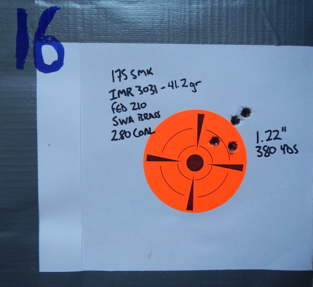

I had very promising results yesterday with 41.2gr of 3031 behind a 175SMK, it shot about 1/3 MOA at 380 yards (210 primer, new SWA brass, 2.80 COAL). M/V was around 2470. 41.0 was not good at all though. In terms of OBT I'm wondering if the shorter barrel makes the nodes closer together?
