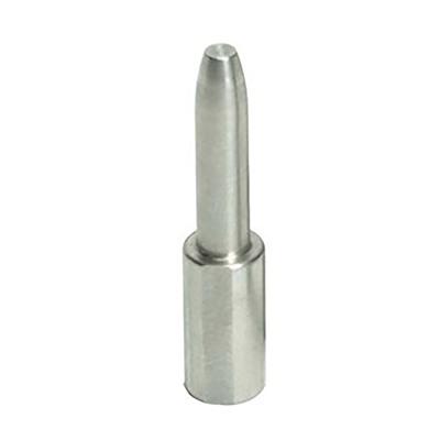

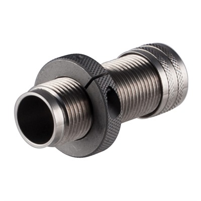

Typically, they'll have a spindle with an "expander ball" that will go into inside of the case and will push the neck against the wall for its sizing. I have Forster dies and I use my Forster full length die with the spindle and expander ball removed. Then I run a die with an expander mandrel into the neck to get my neck tension, like I explained earlier.
Here are pics of an Expander Die and one of the Expander Mandrel that goes into it (this is what I use):
