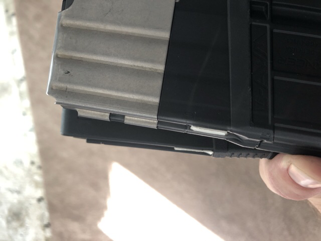

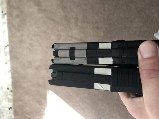

Seem to of found something that works for now. It would seem the nose was sitting too low. I put a small pad on the back of the mags and 100 rounds later no more issues. Going to get a couple more hundred rounds before I look for a permanent solution.
strange how such a small thing can make a world of difference
