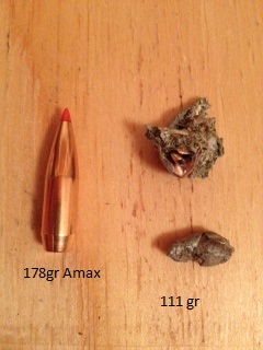

My buddy built a ballistics box using a gallon of water and phone books to capture projectiles to see how they expanded. I shot one of my 178gr amax into it and I don't think its a very good hunting round. Sure the projectile was mangled upon recovery but the jacket seperated from the core so I imagine that this has an affect on wound cavity and ethical implications as well. I'll post pics of the projectile later.

The amax will ABSOLUTELY kill a deer and will kill them very well. I've killed them with 140's from a 6.5 creedmor , 178, 208, 155 in .308. Personally, I would rather shoot a deer at range with an amax. I don't know about this "test" conducted in water, but my "test" was real world and the deer were shot, most dropped, those that didn't never ran very far. I think 40 yards was the most. The AMAX retains its weight as good as any "hunting bullet". Example , shot a buck quartering towards me at about 200 yards with my 6.5 creedmor and a factory 140. The bullet hit just above and to the right of his front left shoulder. I found the bullet lodged in his skin that covered his hind quarter still intact and mushroomed. So it literally went all the way threw and didn't break up. The 208 out of a .300 win mag.... I don't even think I even need to discuss how bad ass they are

here is a pic as promised. And to the others, I am not saying that Amax don't work. They clearly do and there is a thread some where here with pic upon pic of kills made with them. From my understanding, you don't want a bullet that turns into a "frag grenade" as it does not do the same damage as a bullet that stays together and mushrooms causing a bigger wound cavity as opposed to a few cuts and minor trauma that may not lead to an ethical kill.
I am glad that you have "real world test results" that prove they work fine. In all honesty a well placed 22lr will kill a deer too. I understand that water and phone books are not the same as flesh, muscle and bone, but it gives you a better idea of how they behave as opposed to prospecting while punching paper.
any ways, here is a photo...

Cool. Your right about the .22 and shot placement. I apologize if I came across as a jerk. That was not my intention. I just re read what i wrote and sorry if it was arrogant. With all due respect to MarkCo... A 208 amax fired from a magnum .30 cal will kill 99% of the land animals in North America. I've seen too much carnage from it (even on HUGE pigs in the 400# range) to know that the bullet is devastating on whatever it hits.
