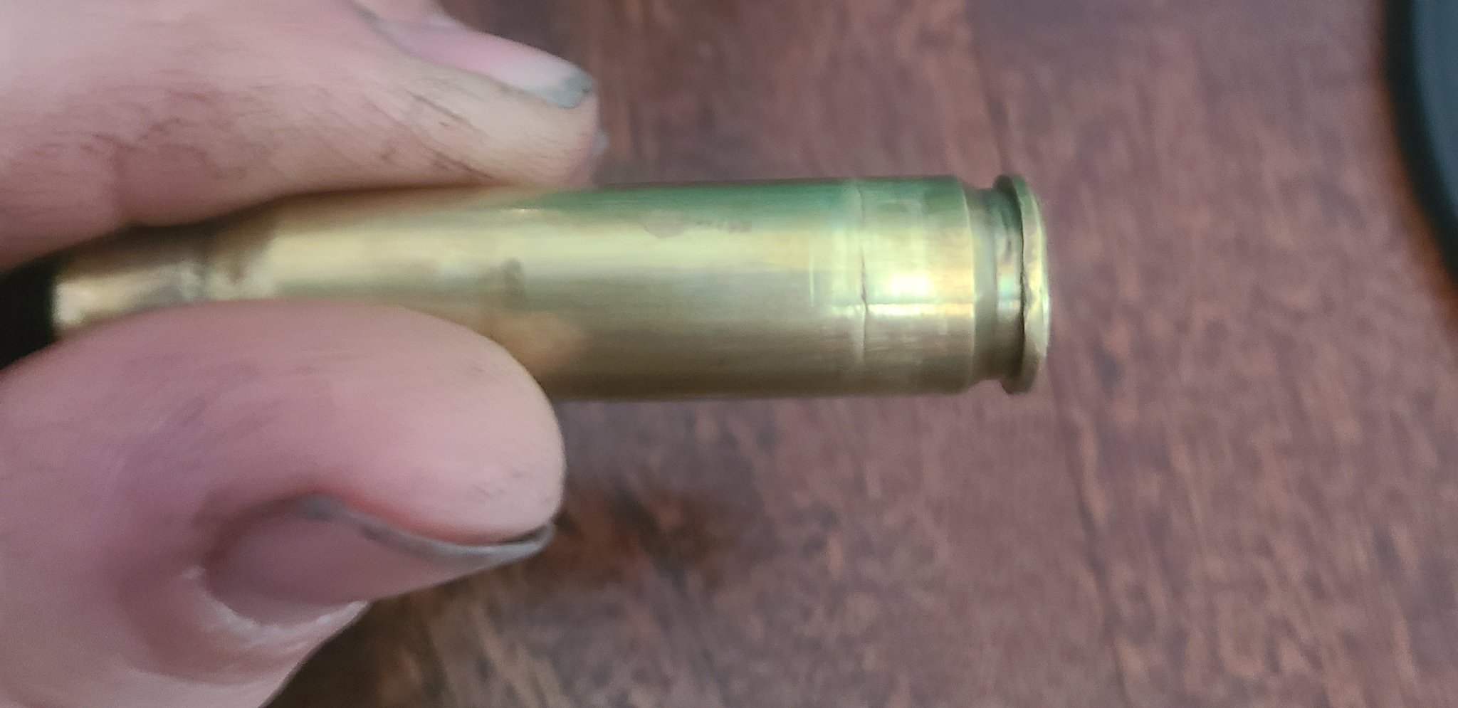

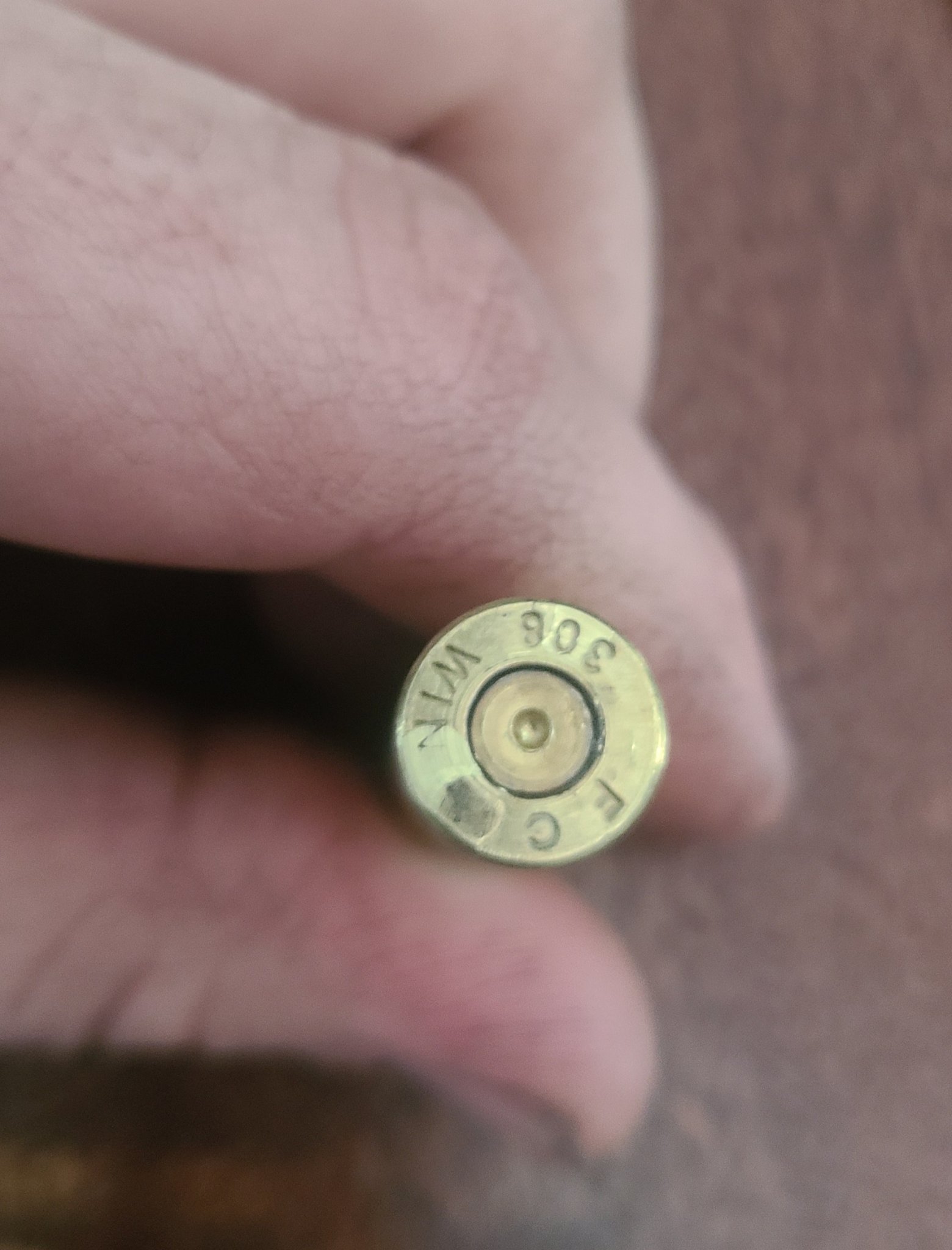

Reloading for my .308 remington 700 switch barrel. Barrel is a heavy varmint 5r. Load is 44 grain of varget. 20 thousands of the lands 2 thousands shoulder bump. I have high brass build up on the bolt after shooting and looks to be Crack brass 1/4 inch from the bottom also ejector marks. Think I pushed to hard or a bad chamber job

Looks like you are about to get some case head separation. I know you said 44 grains of varget but what bullet? How many times have these cases been loaded?
With the ejector marks on the case head it looks like a headspacing issue. 44 grs of varget isn’t that hot.

Federal has pretty soft brass but 44 grs under a 168 tmk is fine.
Either that brass has been loaded to many times or you have something going on with your headspace. Brass is showing high pressure.

If the Winchester brass is doing the same thing something is up with the chamber or headspace. Winchester brass is decent brass.

It looks like your chamber was reamed too deep from here. But to get an actual answer you are going to have to measure.
