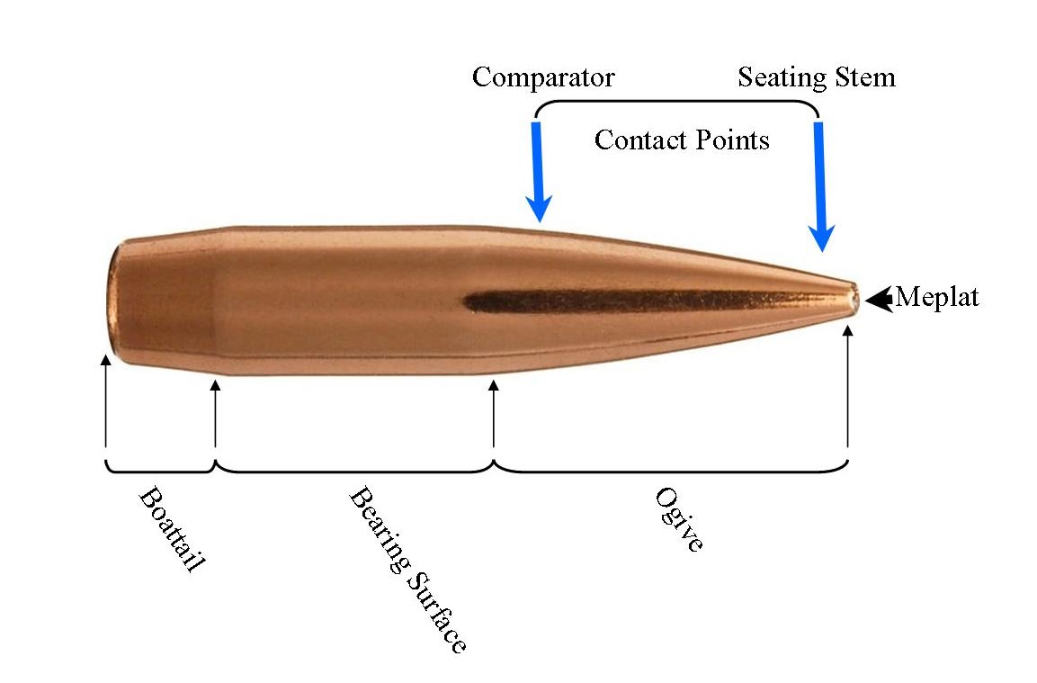

Hello everyone,
I am currently working on loading .308 with 175gr Sierra Match King bullets on a Dillon RL550C and Dillon's .308 dies.
I am noticing that my OAL after seating is varying and I suspect it may be related to the imperfections at the tip of every SMK bullet influencing this. My goal OAL is 2.800in, however I am getting the following lengths on the last 5 test runs:
2.799
2.806
2.789
2.800
2.805
I understand that a variation if +/- .005in should be expected for OAL, however I do notice that the measurement can change with where I decide to measure from the tip of the bullet the tips are often slanted with high points and lower points.
So in essence I have 3 questions:
1. Is this bullet tip variation and OAL variation something I need to worry about, or should I accept this range and be satisfied so long as the average is around 2.800?
2. I am not crimping since this will be going into a magazine fed bolt action rifle and my understanding is it won't be necessary in this use case - do you crimp in your mag fed bolt actions?
3. The completed cartridge does not fit into the case gauge post-seating without a crimp however will fit in my chamber fine. This is to be expected right?

That variation in bullet OAL's in what I'd call "normal" with a lot of SMK's. As mentioned by 918v above, variation in your seating can easily come from a any one or a combinations of inconsistent neck tension, slop in your press and interference from the surface of the necks. To see your seating differences, it better to measure your CBTO's as SMK's can have less variance in their BTO's than their OAL's.
If you really want good uniform cartridges, you may need to think about going with an arbor press and seating die like an L.E. Wilson seating die. ;) :giggle:

IMO opinion those magnitude of differences can be easily attributed to the meplat (tip of the bullet, yeah) inconsistency in the cup pulled over the lead core. This shown pretty clearly in the pics posted above.
Except for issues of fitting inside mag length, who cares. The key to performance is CTBO (measure to the ogive which is what die in your press is actually set up for) so do get a bullet comparator and good caliper (if you don't have one already).
If you really, really, really want you can get a bullet tip trimmer but now you'd be jumping into the rabbit hole of bench rest and F-open folks. Up to you....I don't think you will find any benefit unless you shoot one of those types of very high precision games.

In relation to #1. The interface between the cartridge, bullet and the chamber is what matters. In the case of the bullet to achieve uniform dimensions from round to round the dimension that matters is the beginning of the bullet bearing surface with the beginning of the lands. This is where the bullet diameter and the bore first make contact. Your seating die does not use the tip when seating but uses the diameter of the bullet near/at the bearing surface to achieve uniformity in the "base to ogive" dimension. Ogive in this case meaning the beginning of the reduction of the bearing surface. The ogive (bearing surface to tip) is never in contact with the rifle. The only reason that the COAL is included in the SAAMI specification is for the ammunition to be usable it must be able to fit in the rifle's magazine.

I don't know of any seating dies that are able to make contact at or near the bearing surface. That would be ideal, if it could be done. :giggle:
Because my seating stems make contact very high on the ogive, that's exactly why I sort my bullet with a comparator that makes contact at the same place as my seating stems, to help produce the most consistent seating depths (being that there's some variation between the contact point of a standard comparator and the contact point of a seating stem).

Ah, maybe try a VLD stem?

Update: I went through about 12 more cartridges and trimmed the cases, wiped the wax off best I could and the majority of them are able to fit the case gauge post seating.
Thanks for your help everyone suggesting these bullet comparators to measure from the ogive - they are super helpful and I have learned that the measurements are very consistent (even about .005 more consistent compared to federal gold medal match rounds. Cheers!

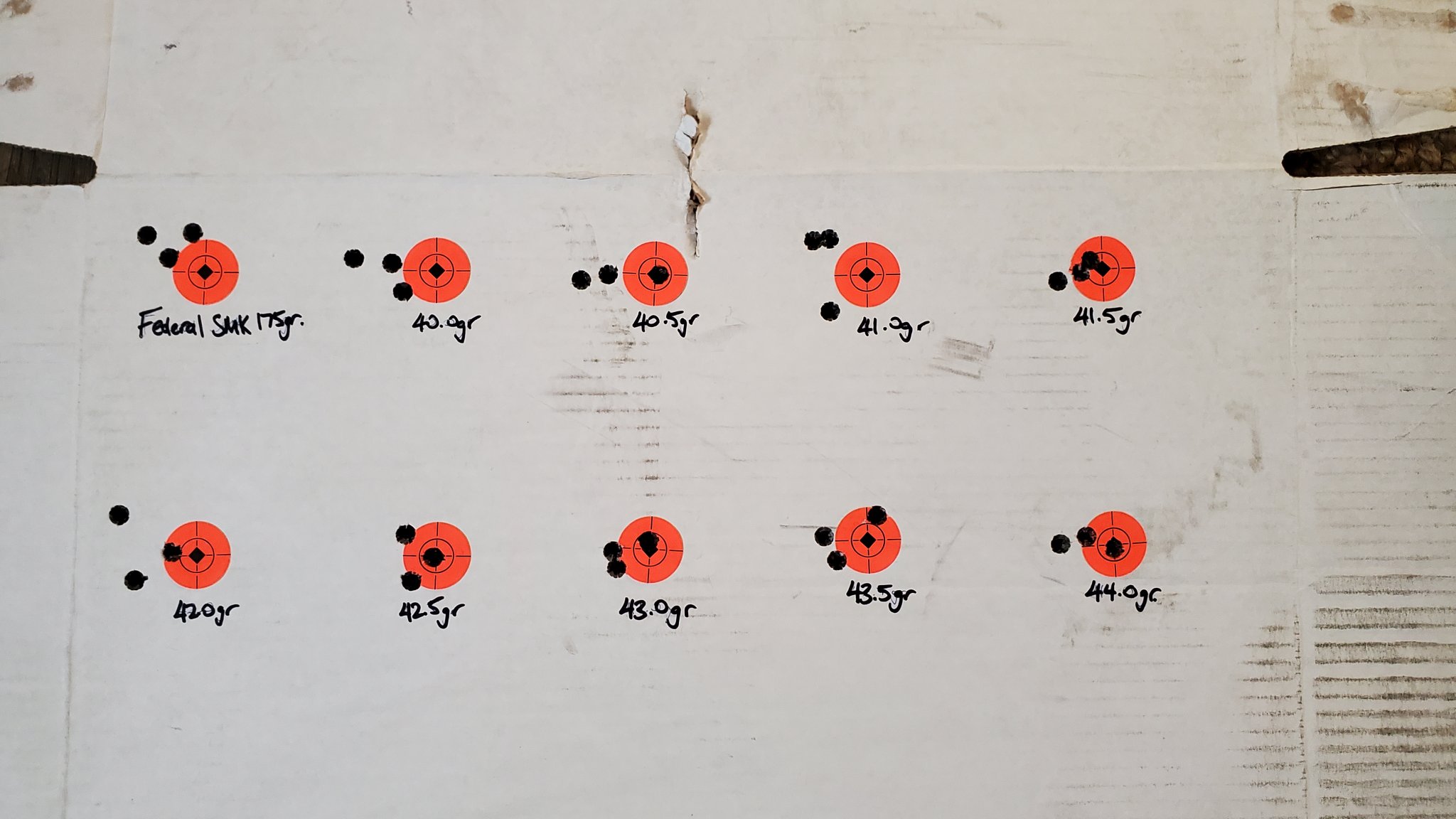

I managed to go to the range and gather data on my handloads:
I'm unsure if my powder charges are being compressed but I don't hear any powder moving when I shake the cartridge haha.
It seems my loads are a bit slower compared to my manual, which at 44.0gr would yield 2732 fps.

Is your barrel 20"?
The velocities you're getting is just fine for a 20" barrel using IMR-4064. Federal factory ammo no longer uses IMR-4064, it's not a fair comparison. These days, Federal is using AR-Comp for both their 175 and 168 SMK's, which tends to produce higher velocities.
.5 gr increment is too much for a .308 cartridge, as it's easy to skip over a good load. .3 gr increments is much better and easier interpret a series of shots like your showing. I think you should look at something around 42.5 gr IMR0-4064, based on my experience with that charge in my rifle.
This is coming out of a Ruger American Predator - 18" barrel.
I was going to ask that actually, it seems that the sweet spots were around 41.5gr, 42.5gr, and 43 gr. I take it that the higher velocity nodes would be preferred.
So the next step would be to load rounds from 42.5gr - 43.0gr in 0.1 gr increments to narrow down on the powder charge that yields the greatest precision?
Oh good lord lol
Most velocities from manufactures are 26”, maybe 24”
I highly recommend doing some more research, reading loading manuals and watching reloading videos from REPUTABLE reloaders.
I see most people using 0.3g increments.
I do, then bracket the best a couple tenths up and down including the best group charge.
That's when I start 5 shots for all charges to help define what's going on.
That usually finds my best charge and let's you see what it looks like on a + / - 0.1g powder drop.
If that doesn't work to my preference I change powder.
Typically, those loading manual data often base on a 24" barrel, like Kickin45 mentions, and that's why you're seeing such a difference between you gun and what's in the manual . . . along with the difference in powder.
Yes, the higher nodes are often preferred, but not always necessary.
It's also important to know which brass your using, the PPU or the Norma, as there can a significant difference, particularly when your loading up at the max load (upper node, if you will). For example, the PPU brass I have on hand has an average case volume of 55.7 gr H2O and the Norma I have is 56.4 grs H2O. The larger capacity allows for more powder for a given pressure to get more velocity.
If you're using the PPU brass, then you're going to be getting into pressure issues at 43 grs along with possibly compressing the powers since that'll be over 100% case capacity when seating 175 SMK's to a COAL of 2.800. The Norma brass would have less of that issue.
I didn't recall you reporting any pressure issues at 44 grs, which is fortunate. But that's running pretty high pressure, which can be a problem if you happen to go that high in summertime temperatures. 43 grs is pretty high too. I've gone as high as 43.9 grs., but I also load them long to a COAL of 2.860 and 43.2 worked well for me, loading them to a COAL of 2.894 for a 24" Krieger barrel in an RPR.
If I were you and looking at the higher node, I wouldn't go .1 grs increment, but go .2 gr increments from 42.0 grs to 43.0 grs being at a COAL of 2.800".
Thanks for the in depth information, it has been very useful during my learning experience.
Speaking of over-pressure, I may have noticed signs of overpressure in the form of difficulty with bolt lift/extracting the fired cartridge.
I've always had a hard time extracting Igman Brass (difficult bolt lift) but never with factory PPU or factory Norma brass.
I noticed at the range with my loads that as the powder charge weight went up the Norma/PPU brass all became very difficult to extract/unlock the bolt with.
Interestingly, the new factory Norma 147gr rounds I have shoot at a higher velocity but have no trouble at all with extraction/bolt lift. Perhaps this increased velocity without sign of overpressure is due to the lower projectile weight and possibly powder.
Factory Norma 147 - avg 2682
2686
2707
2667
2639
2712
I think I may need to stick with the lower powder charge nodes then due to the over-pressure signs.

Thanks for the info, I will keep this in mind. I do see ejector swiping/marks on the brass heads, but for some of the brass I can't tell if it was already there (Igman) or new, so I will try again with some new brass with the charge load I plan to stick with.
It seems the variation between different cases plays a significant role - I shoot at CowTown Range.

You seem to have the base to ogive measurement down. It’s the tips of those smk giving you those variations initially

Yes the reason you’re experiencing OAL issues is because you’re compressing the load

No idea what the OAL is from base to tip. Never measured it and not by my reloading room currently to do so. It’s hard to go by OAL and I wouldn’t unless I’m trying to make mag length. Everything I load I measure distance to lands and measure off the ogive. Start .010-.030 off depending on bullet preference
Otherwise it can be hard to measure OAL. A tip like smk vs a polymer plastic tip can vary a bit when measuring off the tips in comparison
Likewise, I don't really pay any attention to COAL, except when mag length is an issue, with my reloading. . . .that I do record my COAL's just in case anyone asks about my cartridge configuration. But I found it was useless to know someone's CBTO or distance to lands since there's can be such a huge difference in comparator measurements. Like there's a .063" difference in BTO measurement between my Hornady comparator and my Sinclair comparator. That's a LOT bigger variance than you'll find in those SMK polymer tips. Even within the same brand of comparator, there'll often be a significant difference.
Then there's that difference in chamber sizes., where .020 off the lands could mean the COAL is at 2.800" in your chamber , but 2.940" in my chamber.
This is why I like to ask about COAL.. . . to get a decent idea how one's cartridge is actually configured. :)
