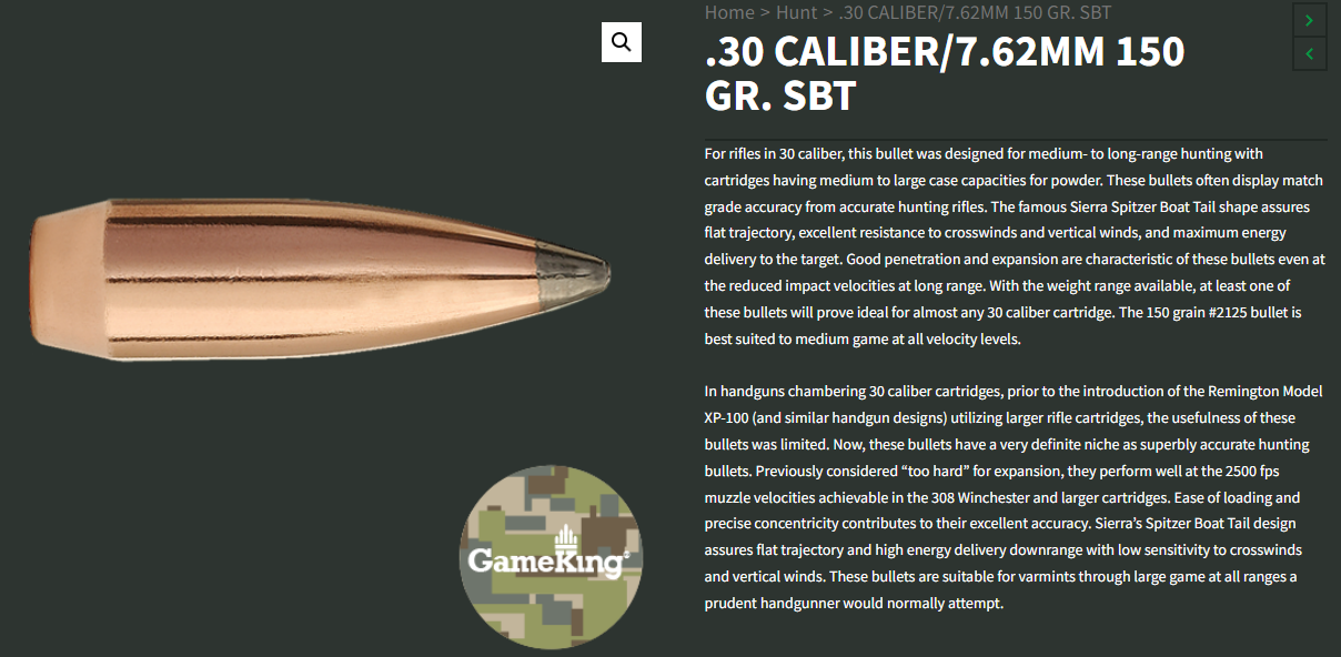

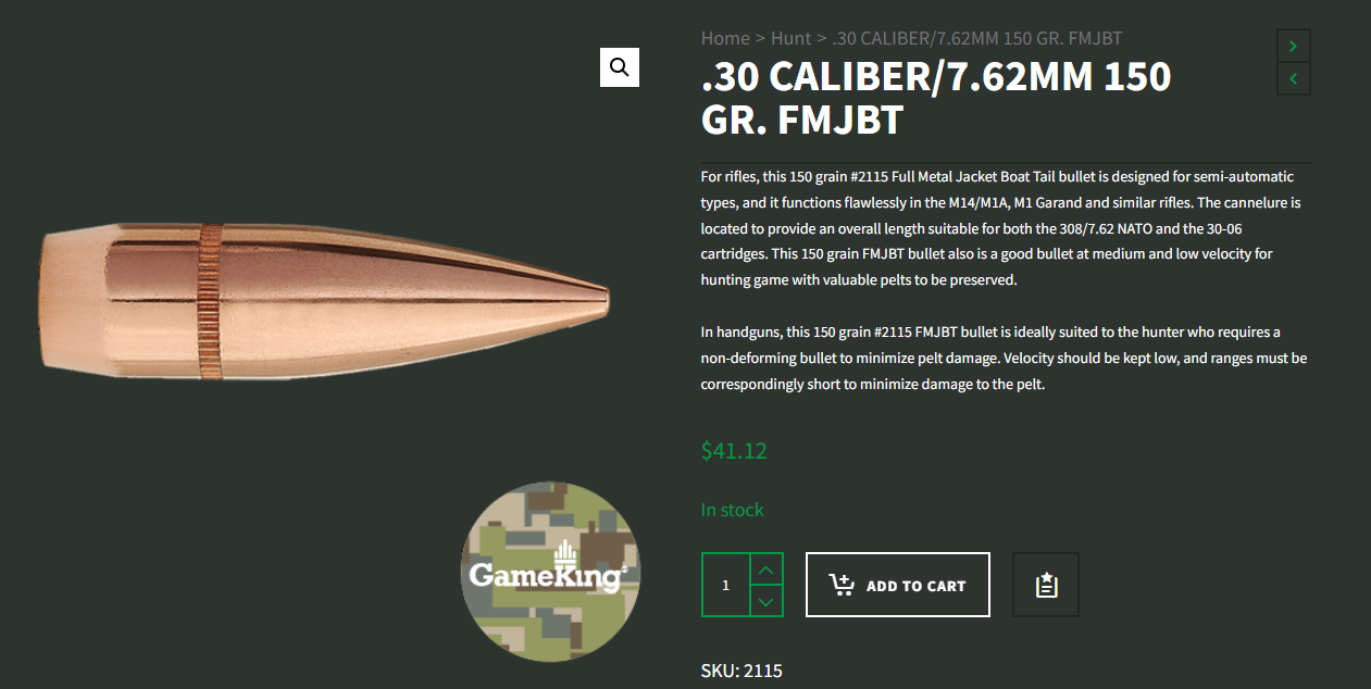

The 150 GK is really an FMJ if we are talking part number 2115.
If you can find part number 2125 it would be a better choice. It looks like this:
I have no idea why a marketing department would use a word like GameKing for a bullet like the 2115? They must be using the same folks who sell beer around here. The 2115 will punch through and certainly kill, but not the way you want it to on game. Here is what Sierra says about it:
