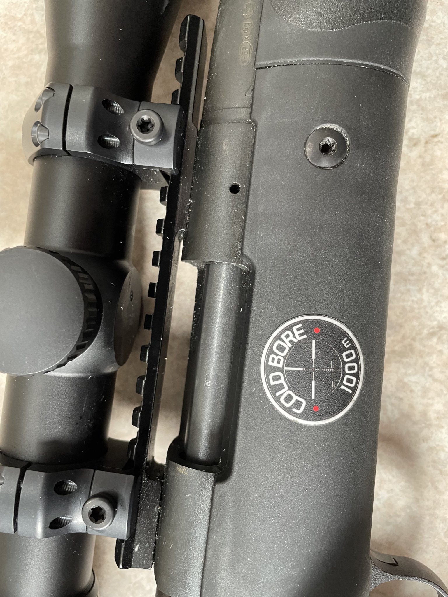

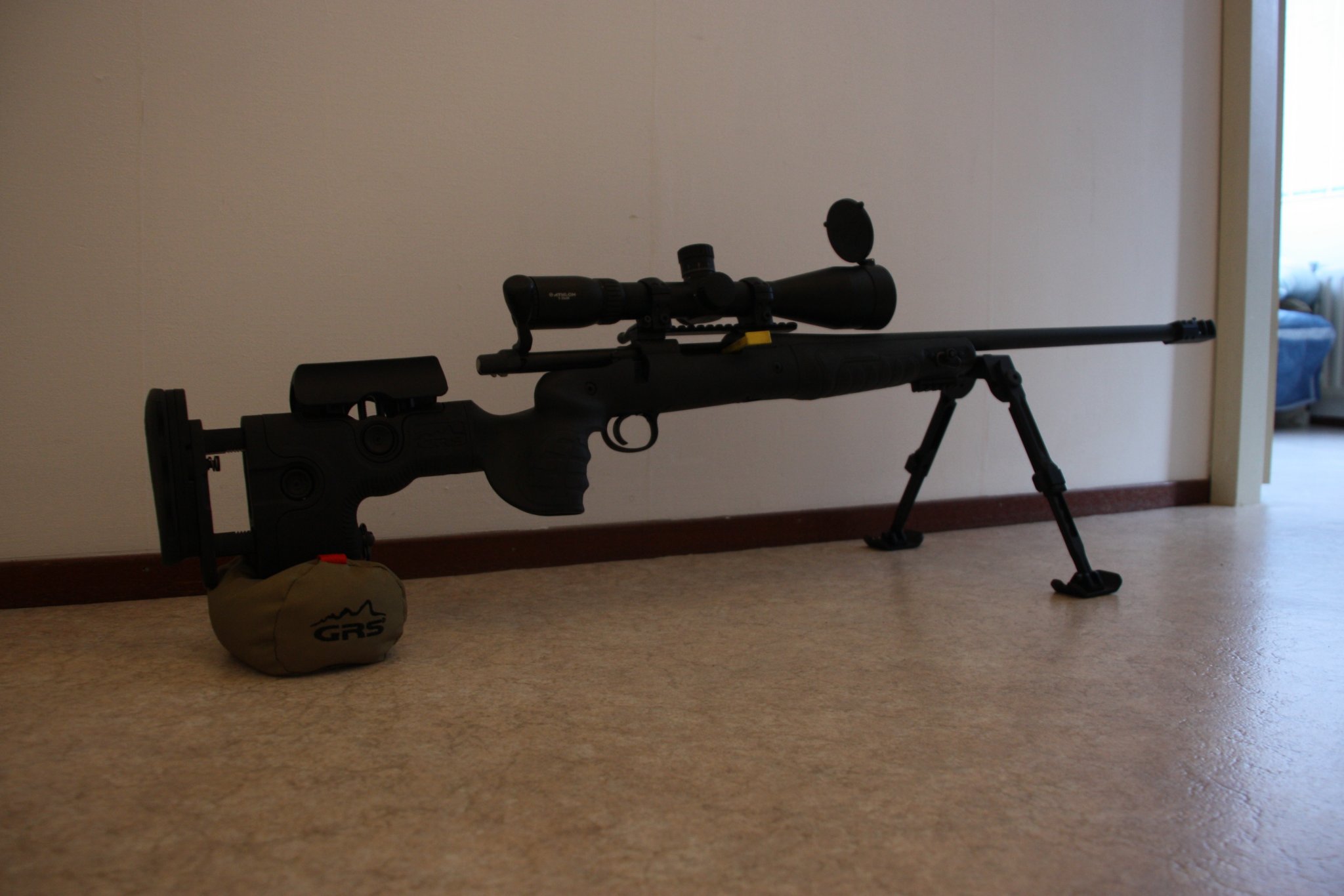

hi guys,
i am rob from the netherlands
i have a Remmy 700 26" twist 1:12, grs stock,roedale comp,timney trigger, 20 moa piccatiny rail,athlon midas tac,fortmeijer biipod.
last summer I shoot in Denmark the 1 kilometer range (and hit it!!) 168 grs hornady a-max,43,5 vihtavuori n540, lapua shell, federal primer.
our next goal is the one mile!
so the question is have somebody good suggestions for a bullet recipes?
greetings
rob
