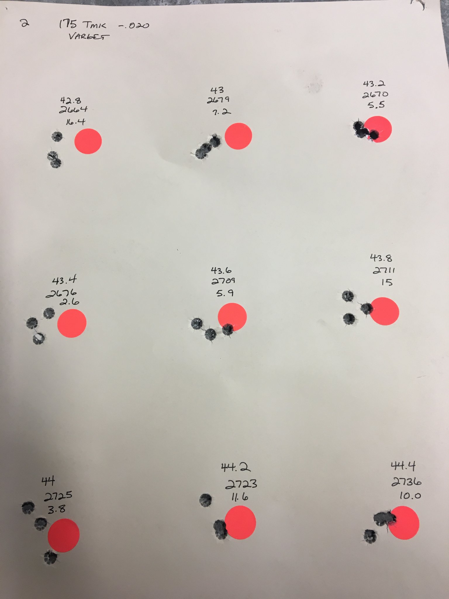

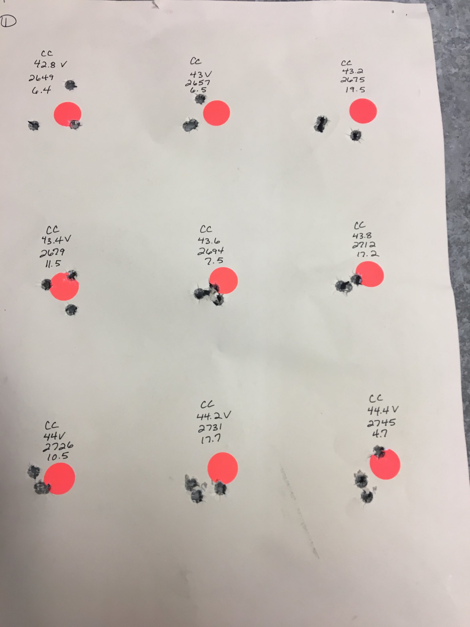

3/4” dot at 100

Yes all measured with a Magneto speed that’s the average and SD
I would further explore that group with the 2.6 sd, that's pretty low. Run a 10 round string and see what the spread is. If the spread stays nice and low, maybe it might be a marksmanship issue. If you have it open up, tweak the seating depth in small .003 increments and see how it responds. Just my .02 take with grain of salt.
At .020 off of the lands those TMK’s are long they will have to be shoved in a bunch to fit in a mag with a binder plate. Are those speeds nominal with a 175? I wondered if I should try going up over 45
Note the POI of the center of the groups from 43.6 - 44.0 grains are pretty much the same. Group size is also fairly consistent across this range.
I'd bet your node with the 175 CC projos is right at 43.8 grains. I'd load 43.8 grains and try jumping them from 0.010" off the lands to ~0.070" off the lands in 0.010" increments (your choices may be restricted here if you are loading to magazine length).

I concur with the 43.8 in the custom competitions. I shoot my OCWs without a chronograph. After finding which 3 or 4 charges are the most consistent POI I'll go for the upper half, load more and verify on the next range trip, then chrono them.

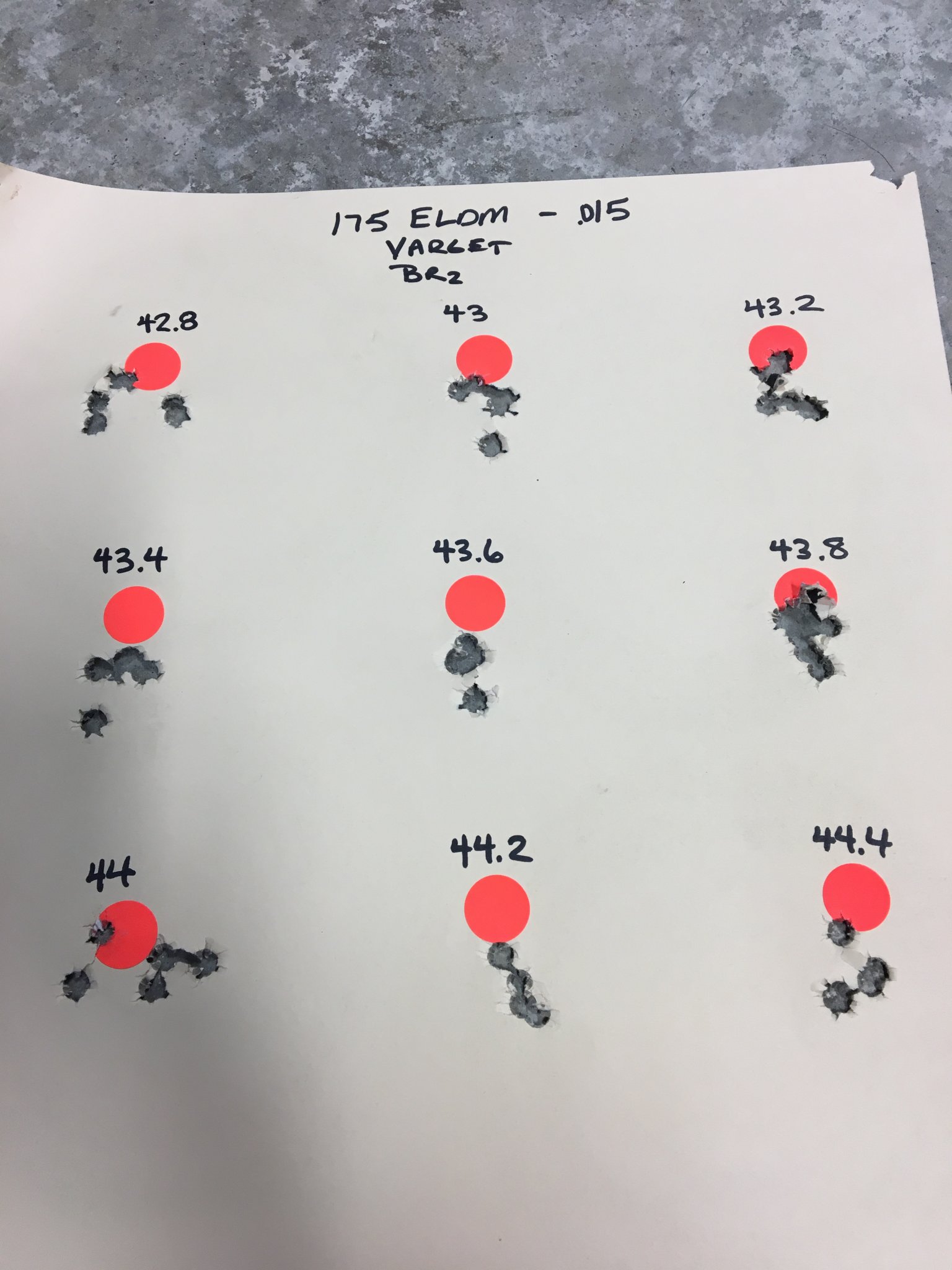

175 ELDM -.015 off
Varget
BR2
Federal brass
5 shots

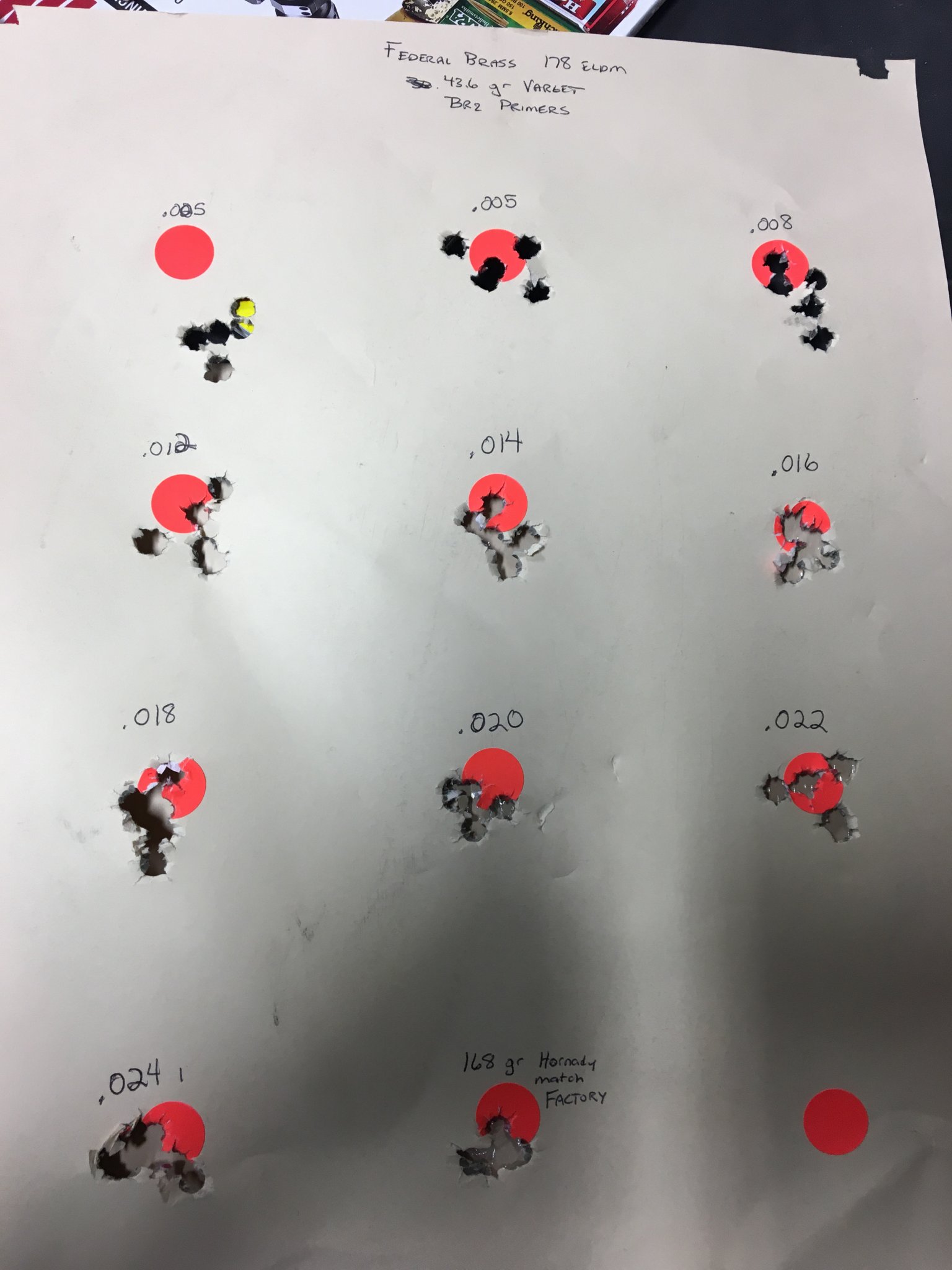

MT - looks like you've tried the 175 and 180 eldm's but the 178's look the best?. .017 and roll with it...
