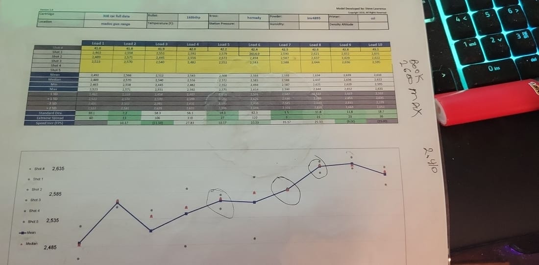

morning guys? got some questions for you. started loading 308 168bthp hornady rounds with imr 4895 powder and i am wondering if they will get into the 2700fps or is that out of the question so far i went 20thou off the lands. and this is what i got so far. any help would be great thanks

Describe your rig and bbl?
There is a big difference in the outcome depending on if the rig looks like a SBR or a Palma rig.
Trying for speed over accuracy isn't a good trade on most days, but what a speed for a 308 and any particular bullet should be does depend on the bbl.
Reactions: ShtrRdy
its a factory ruger precision rifle with a factory barrel. did the one load test and as the picture shows there is one good group but no flat node. was wondering if i should look for a node or not?? what do you think of the test pic?
Dont worry about finding flat spots, they aren’t reliable anyway.
Why do you need 2700 fps?
Its best to find an optimal charge weight that gives you the best level of precision consistently and safely. I ran your numbers using the Hornady 168 bthp and its supersonic to 850m at 2550 fps (11.4 mils) and 925m at 2600 fps (12.2 mils) using sea level, 50 degrees F, 70% humidity.
Mind you, these are only estimates as im not sure where in CAN you live but should give you some idea of the load’s max effective range ls at those mv speeds under those conditions.
i live in ontario. so yea. so if i use the one set of numbers 2578 fps i should be able to get it out to a 1000yards

The 168 Hornady and Sierra are very similar and neither do well stability wise in the trans sonic region below 1.2 Mach. That pretty much limits them to about 800 yds in normal barrel lengths depending on elevation. The 175SMK and 169SMK both have shallower boattails which handle the transonic region better.
2700fps may be achievable. 2000MR and CFE223 would be the powders of choice to do that.
As for flat spots? They are a function of testing, and are not real.
