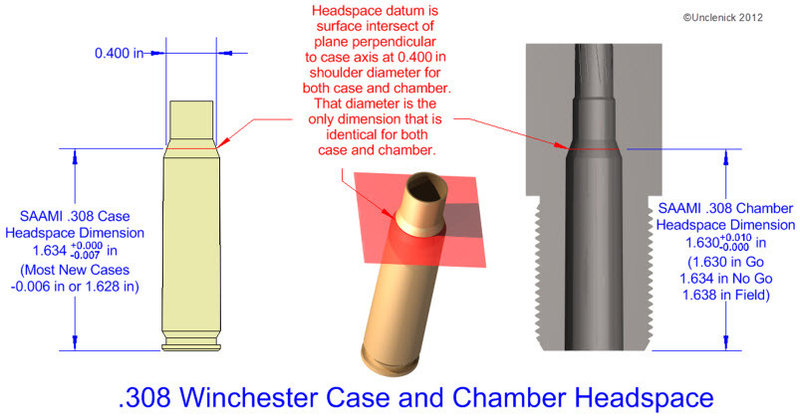

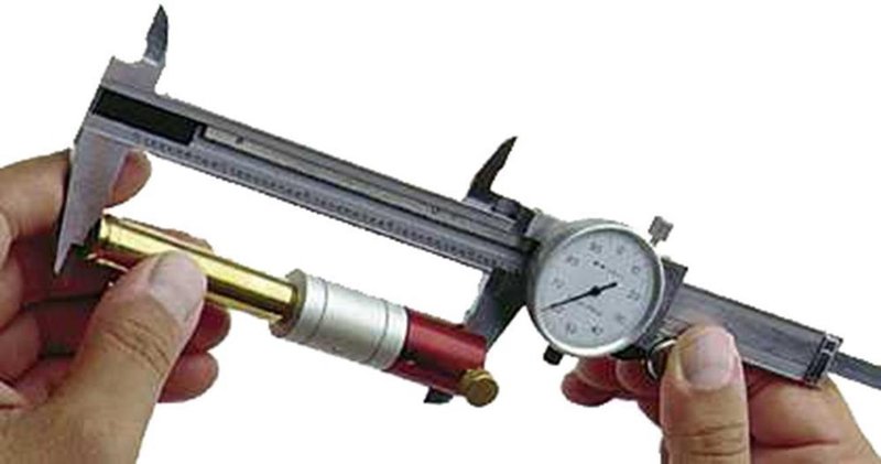

youre not bumping your shoulders back enough. I think it's the shoulders.. reason being you quoted ".457, .456, .454" when someone asked you about shoulder bump. Don't know HOW you're getting those #'s.
You need to get the measurement for your shoulder datum line
