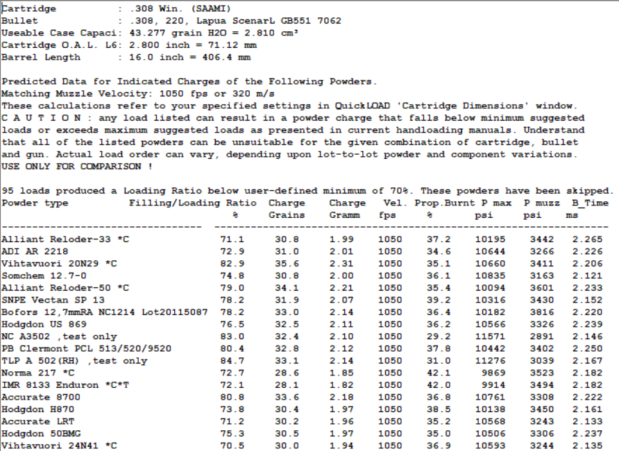

I used the classic 10.5gr of Trailboss with the Lapua 200gr Subsonic for years - good combo. But given your situation, let me run some numbers for you...
So here I set the parameters for >70% case fill with a targeted velocity of 1050fps. It looks like the slow magnum powders are your Huckleberry

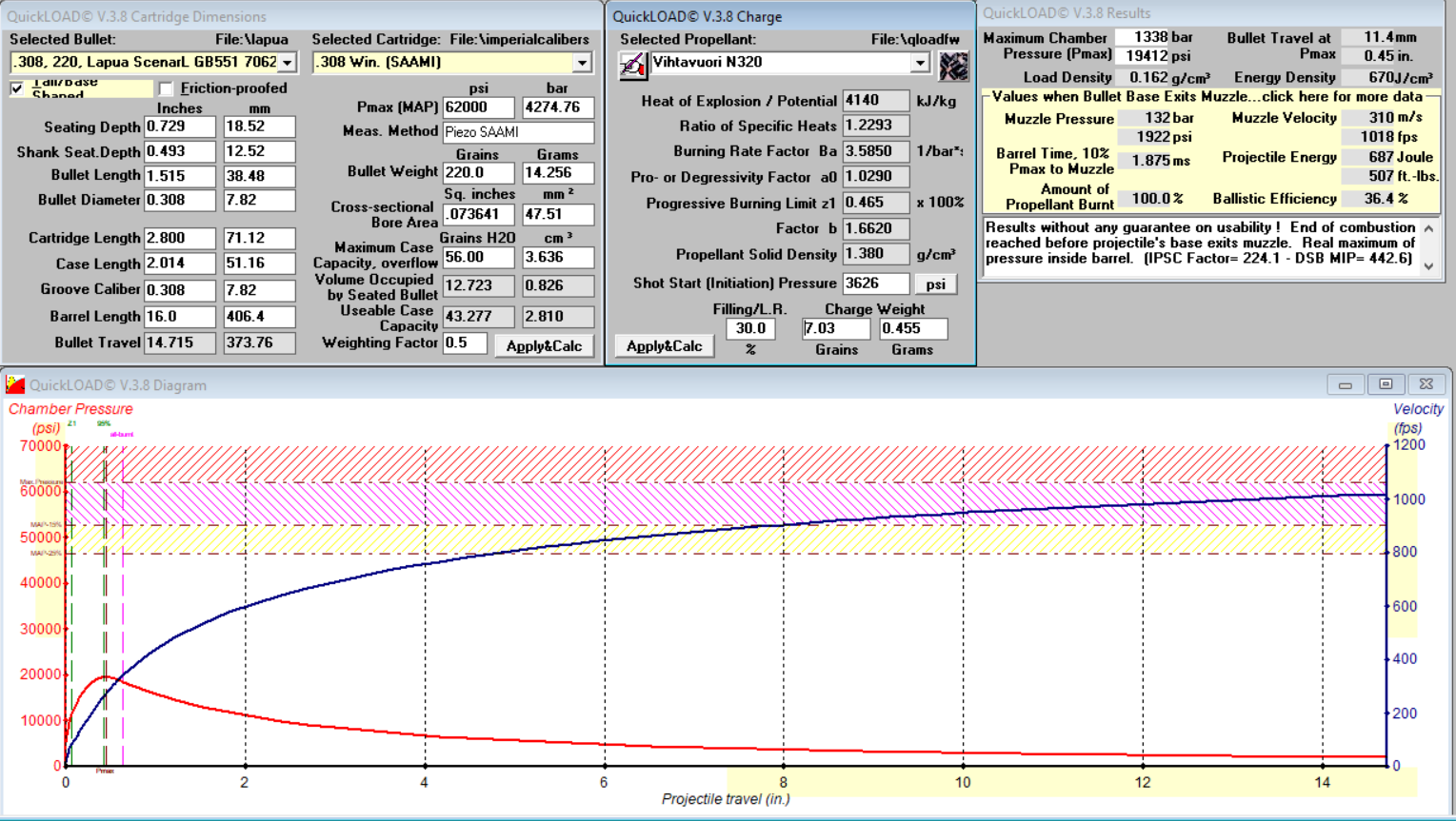

Some of my friends are using n320 but with case filler that i want to avoid.

I figure you should be able to get your hands on Vhit. Might be a good way to go with that 20n29.
This is the best I can see with N320. The main problem is the Fill % is 30, which is a really bad idea. You'd need some kind of filler to make that work and that can often be problematic. Time to switch to .300BLK ;)

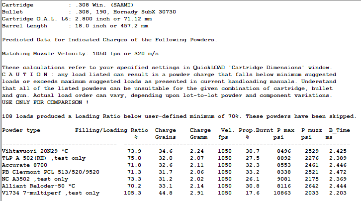

No 175 SubX in the library, so here's what it says for 190s
Not good data, I think...
The problem in general with this kind of stuff is that you can get into a danger zone with Filling/Loading Ratio below 70% very quickly. Trailboss is popular because it fills cases quickly without generating that much power. A good rule of thumb with developing subsonic loads is to start with a safe supersonic charge weight and then work backwards until you're subsonic, but you have to be careful with low fill % otherwise you may get a detonation.
Hodgdon suggests 2.69" COAL with 190 SubX and 10.5gr of Trailboss, so maybe start there....
