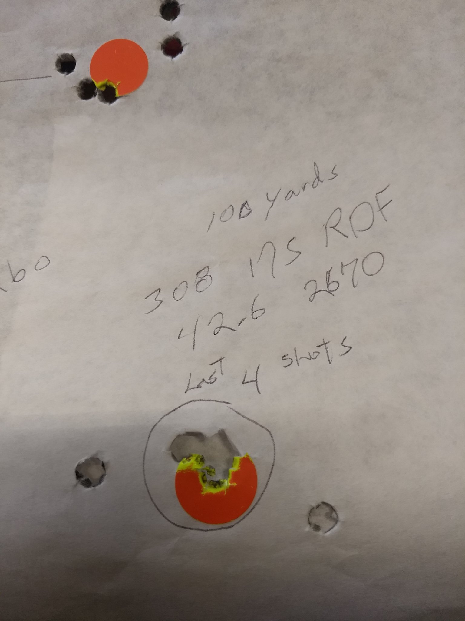

Retarded and dangerous?
I have used this load for almost 3 years.
There have been NO ill effects in my rifle.
I think you paint with a broad brush?
Thats not to say your wrong in any way!
I guess I didn't explain my loads the way I should have?
I have a pretty long jump even with my coal of 2.850 I still have .100 jump with the RDF also I can insert the bullet into the case filled with 42.7 grains of 8208 to a coal of 2.75" . So from my stand point I'm neither retarded or dangerous!
Should I have stated this on a public forum? Probably not but to say its not possible to get a 2650 as the OP was wanting is not true either.
If I seat the bullet deeper as stated that gives me a .10 more volume then add another .10 of jump to the lands and I'm not pushing the envelope!
In fact I was having a hard time with the rifle not cycling with lighter starting loads.
Sorry!

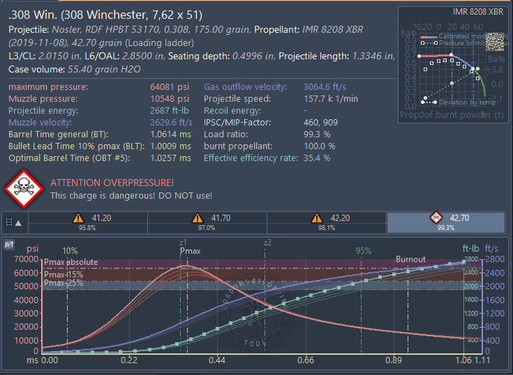

The rdf is 1.35” long to the SMK being 1.25”, so its .100” longer. You seating the RDF to 2.850” is still seating it deeper than the SMK at 2.800”. You are doing this in a LC case having 2 grains less case volume than the Winchester case. If your powder charge makes 61,000PSI in a Winchester case, its making well in excess of 70000 in a LC case. And this is with XBR of all powders, probably the most unforgiving combination for the 308. I have LC LR brass. I know how it handles pressure.
You’ve using this for 3 years? Lol!
For what its worth, this is what GRT puts out for the load being debated. Puts him at 64,000psi, while spicy and technically over charged. Its not gunna blow up the gun and with strong primers should only show flattened primers as a pressure sigh. I know im comfortable running my 308 up to 65,000psi before my butt starts to pucker(proof load for 308 is 75,275psi). So I'd say this load is plausible, albeit deffinatly qualifying under the +p Category. Lets try and keep it civil here talk with the data.

Not right . From a 2.850 I'm still jumping
.10 to the lands with the rdf. Doesn't matter the length, what does matter is the profile of the particular bullet.
The baring surface is shorter.
