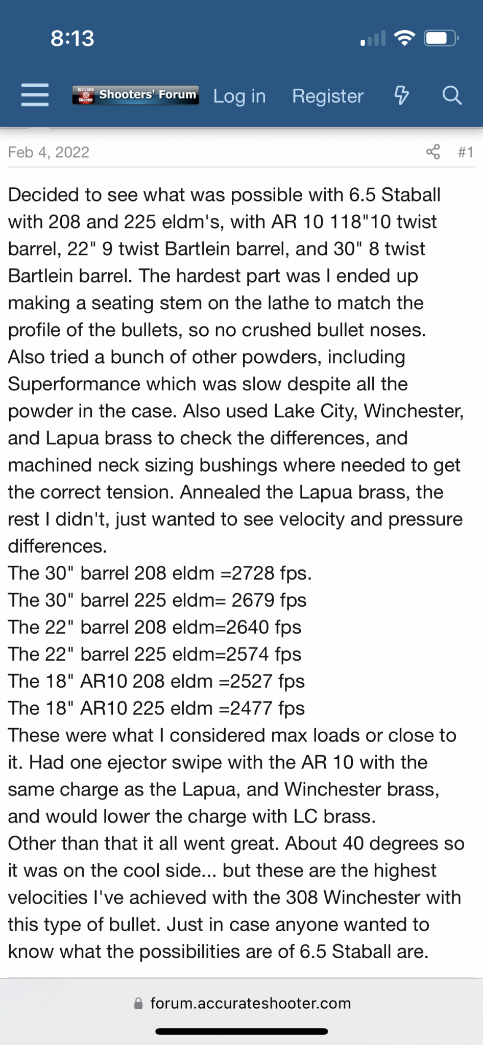

Ran across this reading some forums the other night. It’s not my test but I’m going to add it in here to see if anyone else has seen this. If legit I WILL be trying it in my 20” barrel AR. Anyone with quick load to verify anything?
Hope I haven’t broken a rule sharing more less doing it to see if anyone here has any more results similar?

I have seen some of this guys posts and he claims to get really fast velocities with different
308 rifles. Cant say one way or another but the velocities seem too high for normal SAAMI pressures.
ARs dont have the best case head support so I would be wary of pushing speed in a gasser.
A 225 ELDM in a .308 case? In an AR 10?
Did he have the base of the bullet backed up to the flash hole?
Mike
Reactions: Kushiwah
He claims he is a machinist and he probably is but he cuts really long throats on 308 chambers
and uses long barrels to get speed.
Most likely he used a throater to lengthen the throat of a large frame gaser and is single loading.

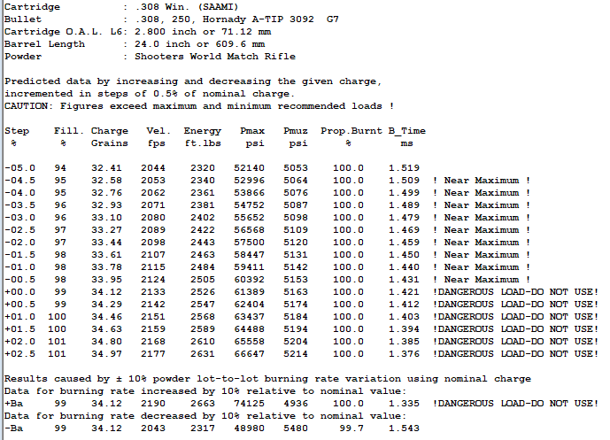

Why not try 250 A-Tips? In a 24" bolt gun you can still get 2100 fps. Starts to feel like a scaled down .510 Whisper.

His other post- My experience only, for informational purposes not a recommendation...my maximum in my rifles in my chambers, with my loading practices 208 Eldm to 51.0 grains 6.5 Staball in all 3 rifles and 3 brass types COAL 2.290" The 225 grain 49.4 grains 6.5 Staball max with 225 gr ELDM 3.035" COAL in all 3 rifles. The AR 10 must have an adjustable gas block...I made the throat slightly longer...had single digit S/D and one 5 shot group .314"
You push the bullet out as far as it will go in a 308 case then lengthen the throat like Weatherby so you get more room in the boiler.
This guy has a machine shop at home so if it dont work cut 2" off and start again.
And he is probably exceeding normal 308 pressures.
