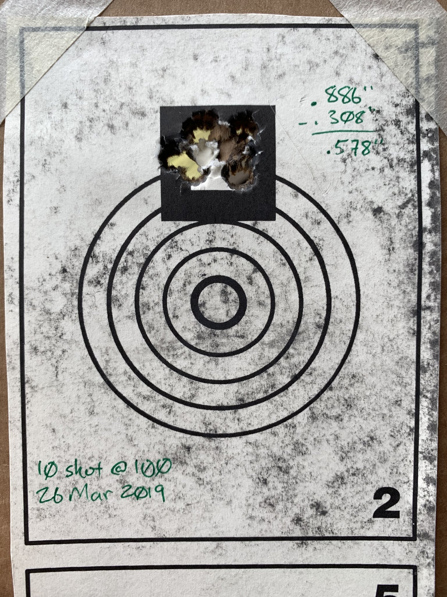

I did exactly that and Matt Stewart chambered mine with Robert Gradous’ reamer print, 21.75” Heavy Palma Bartlein 10 twist. The first 10 shot my brother put through the barrel, no break in or anything, was 2/3moa with called fliers. The first 10 shot I put down it was just over 1/2moa, with FGMM.
I would recommend it and will do the same thing when I shoot this one out.
From what I remember, it’s essentially a Bisley Palma print with a little more freebore, I am not positive though. The lead angles are the same from what I remember. I told him I wanted a chamber that’d shoot 155’s thru 185 Juggs, and potentially some 200’s, and mag feed.
Here’s a picture of a 10 shot, off the bench with a bipod and small rear bag.
