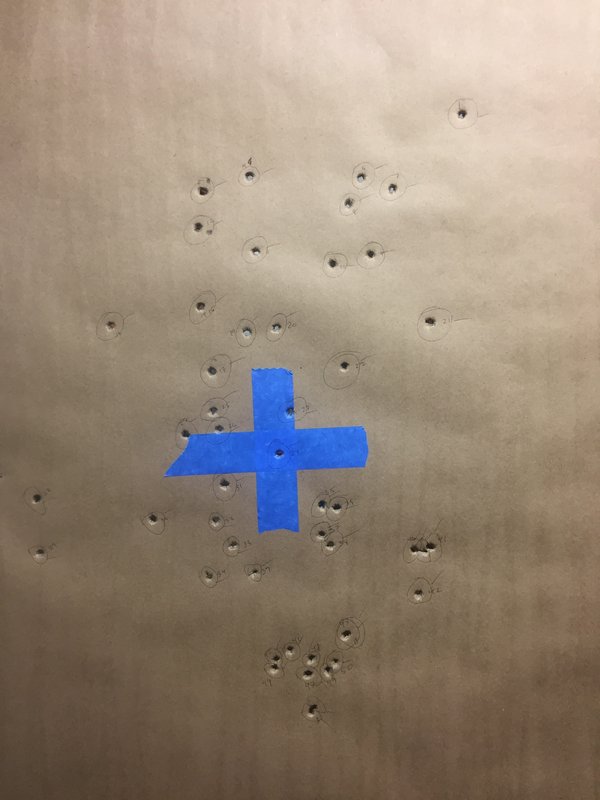

Been lurking around here for a number of years now, but this is one of my first posts so if its in the wrong place, feel free to move and I apologize.
I am working on a 308 subsonic load for my Remington 700P. The barrel has been cut down to 18" and threaded for my suppressor. Before I take a chance on a baffle strike I loaded a bunch up and shot them. I'm looking for some advice from the experts if you think any of the shots in the picture of my target appear to have keyholed. I tried to space them around the target, but between adjusting the scope for the new point of impact and probably not taking enough time some of them ended up touching. Thanks in advance for your input.

I think your gtg. What's your load data?
My favorite two for my 308
11.1 gr trailboss 200 smk
13.3 trailboss 220 round nose
Looks go to me.
