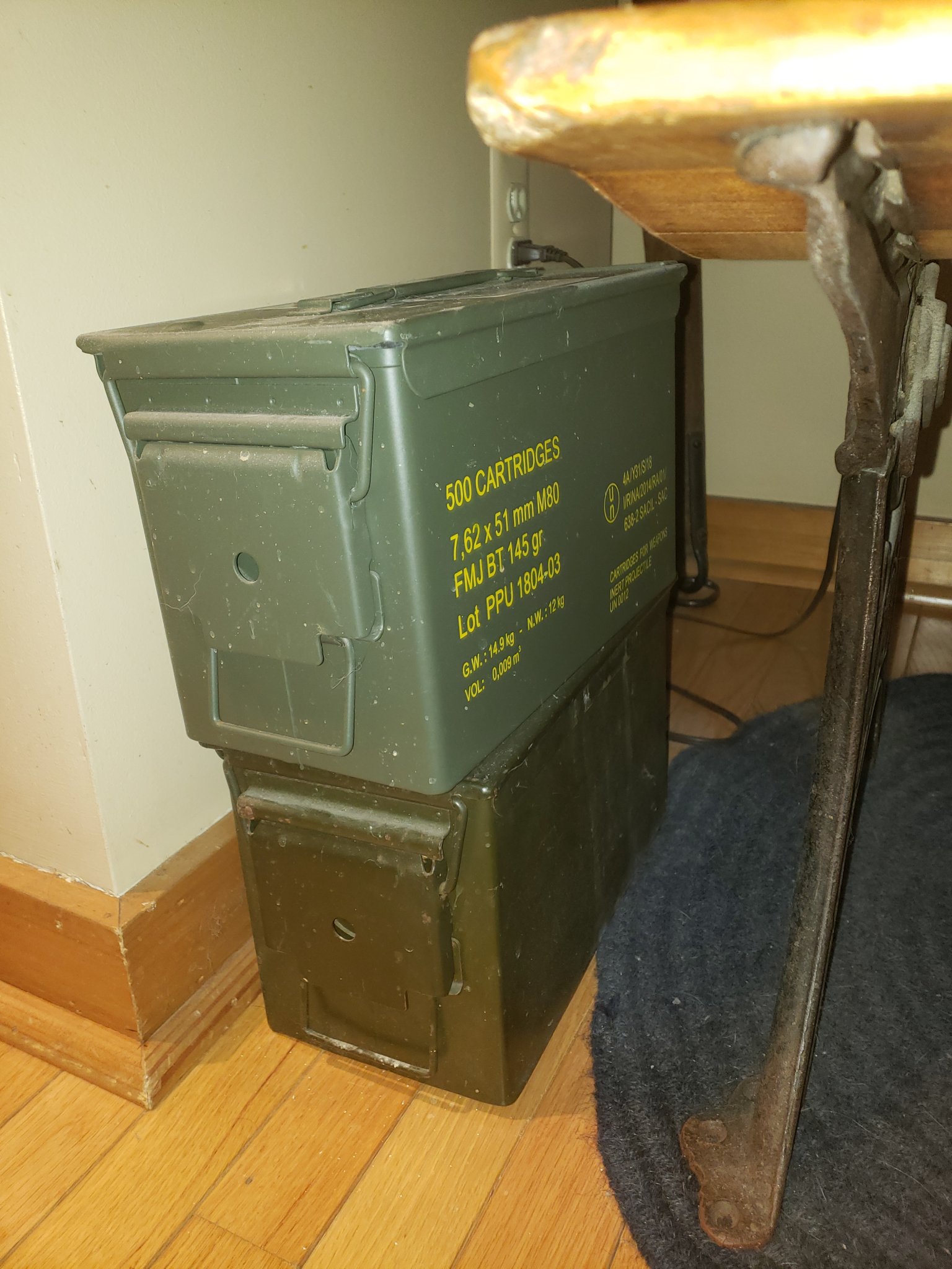

I probably have a thousand rounds of M80 in the cab of my truck.
M118 was on sale for two years at Target Sports @ $0.55 a round.
Then there's those nice 30 round cans of canned heat that they were practically giving away.
I have those everywhere
