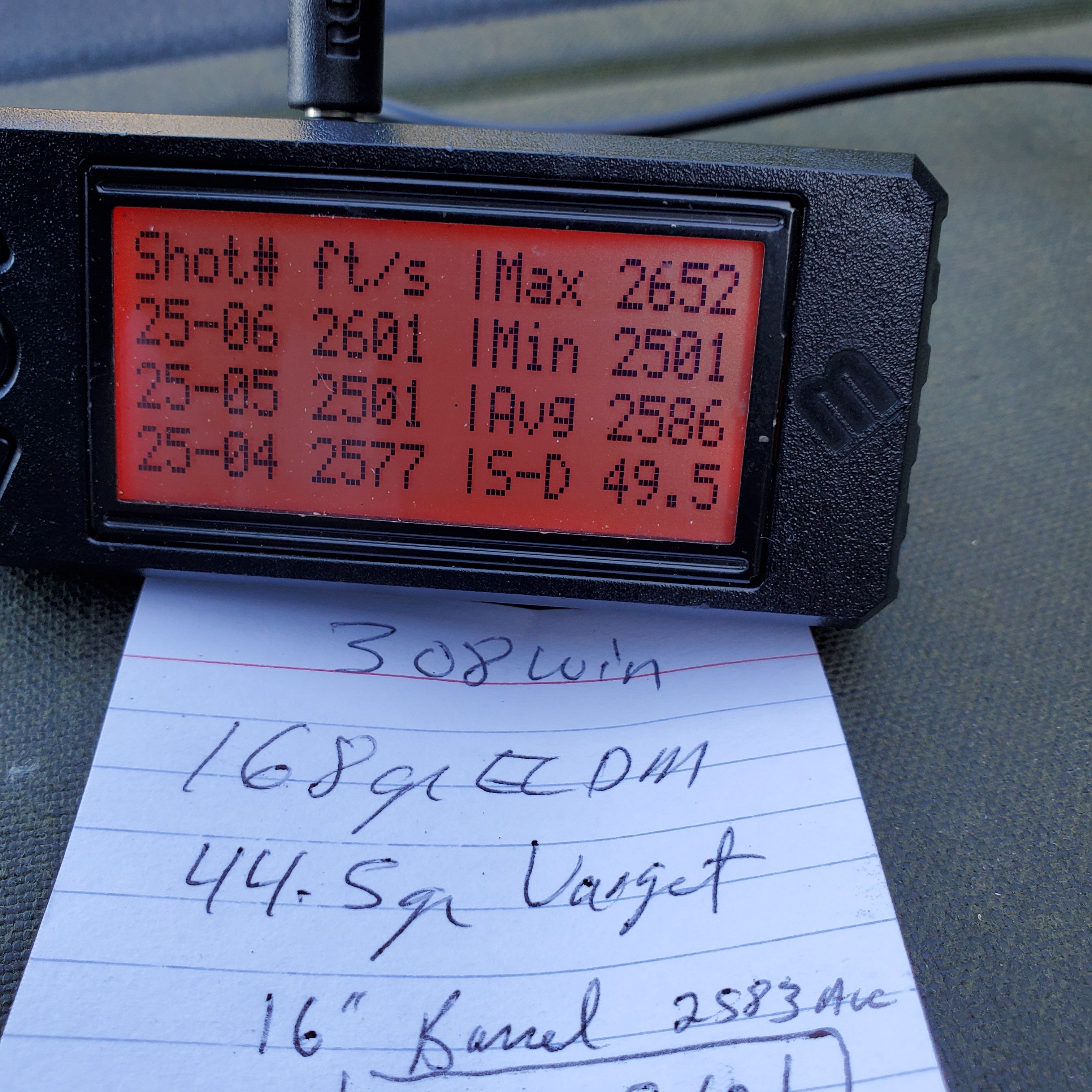

I would have bet against this, and it's not the normal with Varget.
This 16" AR 10 did not like Varget 49.5 S/Ds with 168 gr bullets poor accuracy.
But it loved 168 ELDM with 2000MR right at the max...fast & accurate.
So that's what I shoot in it, also the 169 and 177 SMK are liked, in this barrel.
