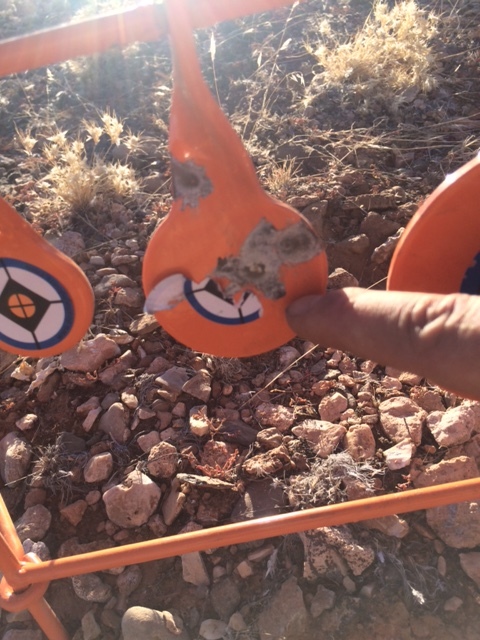

    Target is usually a 3 gong steel swinger (pics attached) where the middle gong is a hair over 2 inches, and the larger gong is 3.2 inches. With a good mirage, I can't even see the 2 inch gong half the time; however today, there was next to no mirage which presents its own set of problems when trying to determine what the wind is doing downrange especially since the first 75ish yards are blocked from my 3 o clock to basically have no wind due to a canyon wall and as soon as the bullet passes the wall, there's wind.
    243 yards made 5/5 and 3/5 hits (target with my finger pointing at it after the first 5/5) for reference and then put a clay pigeon holder with a standard clay in it at 315 to see if I could get a hit as I wasn't sure I'd move the gong much and after 13.4MILS, managed to on the 2nd round.

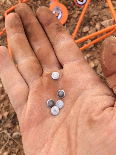

    At 315, the round is basically coming down like artillery with 155 inches (13 feet!) of drop and with a 5mph it needs 2MILS of hold. I used both the steel spinner gong and a 4.5 inch self repairing polymer gong. When hitting the gong at that distance, they just barely hit it and fell off right in front of it making a neat little pile of flat bullets; at 243 they still ricocheted off.

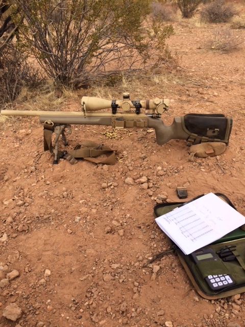

    The furthest I've pushed out the ole 452 was 400. My hs-t maxes out at 16 mils so at that point I had to half my magnification so I could keep the target in my fov as I held for the extra 5mils. At that distance a hit is a hit and its kind of a crap shoot with the wind. Luckily on that particular day back in spring the wind was very calm and at my head.
    The results for the day
    Really fun stuff
