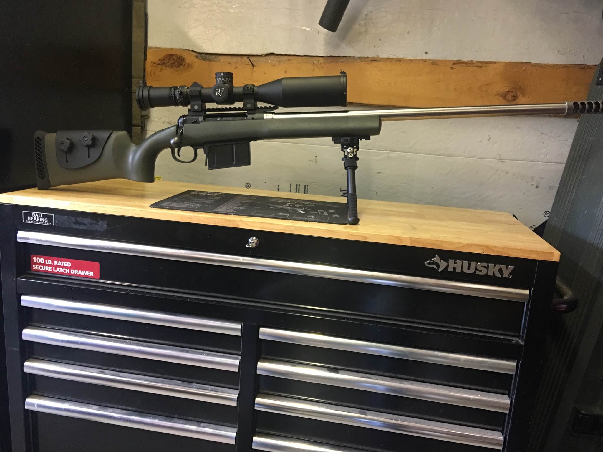

I have ran a 250 grain projectile up to 3100 ft./s but do not attempt this it was A very hot load always work up and if you’re going to be swapping barrels etc. savage is a decent platform to start with I am running a 28 inch BARTLEIN with a 9.3 twistATTACH=full]7369612[/ATTACH]
Reactions: paulwardd
View attachment 7369612I have ran a 250 grain projectile up to 3100 ft./s but do not attempt this it was A very hot load always work up and if you’re going to be swapping barrels etc. savage is a decent platform to start with I am running a 28 inch BARTLEIN with a 9.3 twistATTACH=full]7369612[/ATTACH]
What is your rifle weight and is that a stock brake?
As far as the break that is a terminator T4 I’m not sure if the weight I Only have a bathroom scale let me Weigh it and I will get back to youTo start off it was a savage 110 FCP
Reactions: Jscb1b
Approximately 16 pounds roughly I weighed myself on my bathroom scale held the rifle and Re-checked my weight
Reactions: Jscb1b

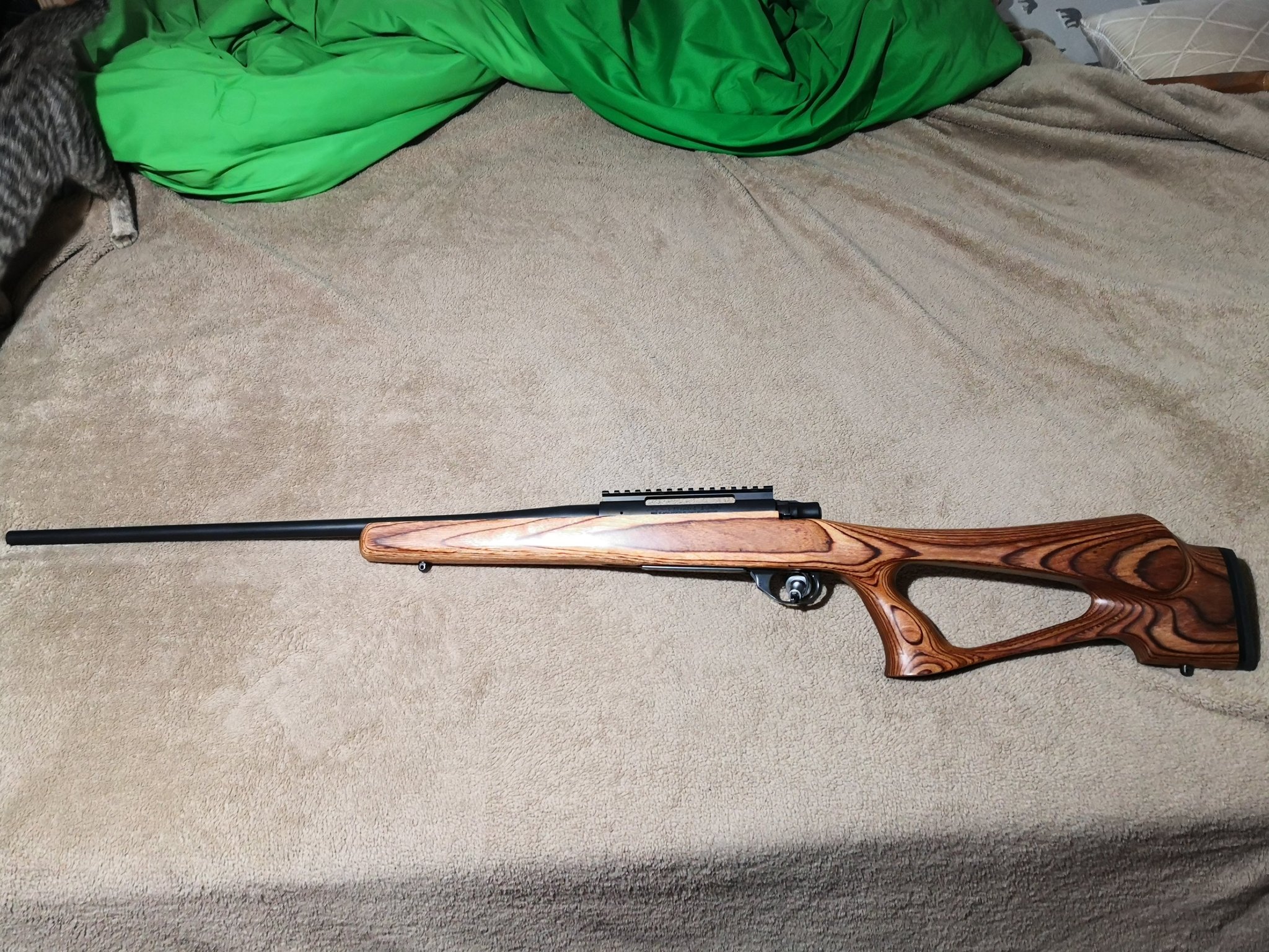

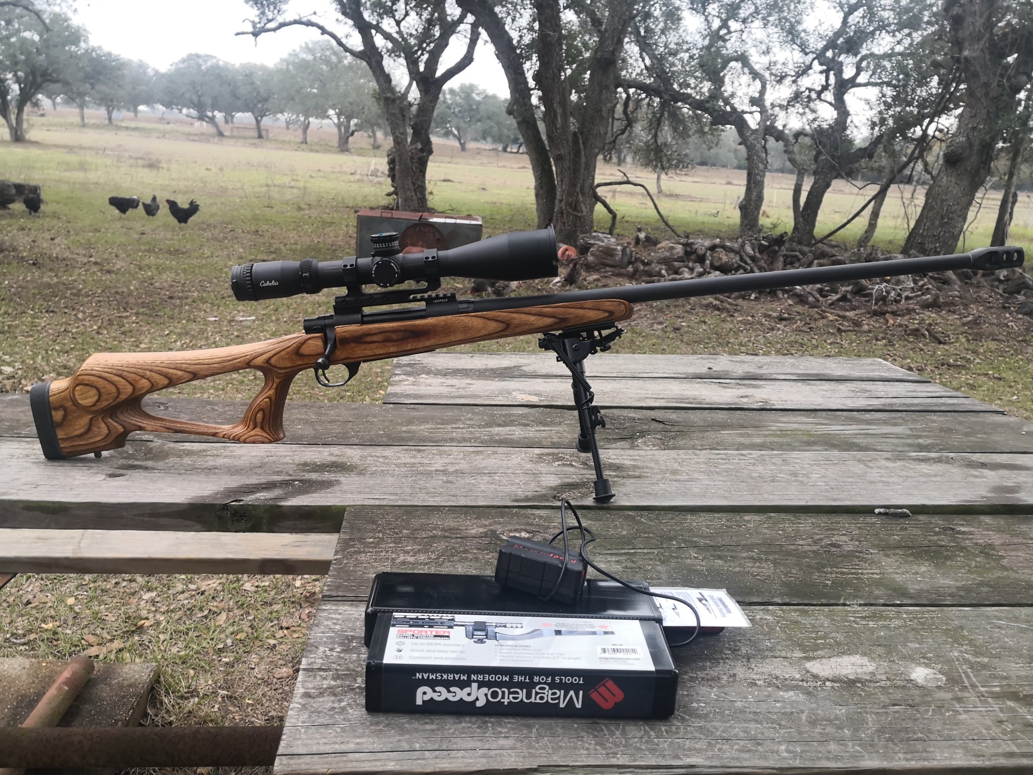

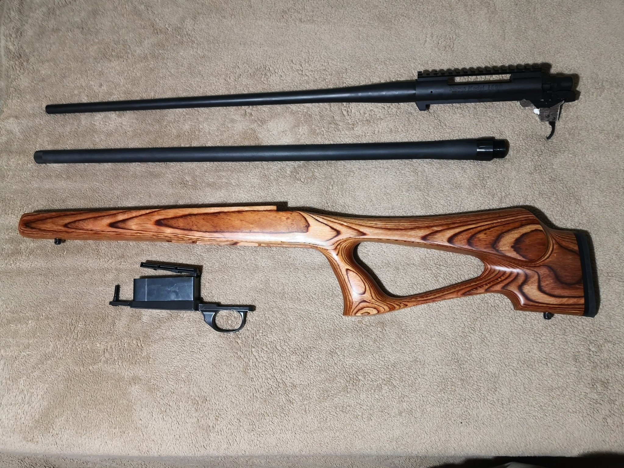

I know I'm late to the thread, but I built this 33 Nosler Howa out of a M1500 338 Win Mag I had bought. Main reason was that I hated shooting it with the shorter pencil barrel because it wanted to jump up too much and was unbalanced especially with the almost nonexistent recoil pad(got scoped a couple of times).
I ended up ordering the 28" Remington sendero contour barrel in 33 nosler from Mcgowen with the howage barrel nut and wrench on last year's black Friday special. Got the headspace gauges from Pacific tool and gauge
Main reason for 33 nosler was that I didn't want to modify the action or bolt along with the inlet in the stock to make an Edge or RUM work in it. I did have to open the barrel channel a good bit so it would fit and removed the old recoil pad and installed a new one, but that was all. Earlier I was getting 3025 fps with the 225gr nosler E-tip with 84 gr 4831sc. Should have some 265gr ABLR coming soon and see what they yield.
The dies and cases I get from Grafs since they have the "bulk" unprimed 33 nosler 50 cases for $70 vs the ready to fire at 25 for $73. The bulk you just have to resize and check length before you load them up. So far everything I've loaded has been sub moa at the most but still have some testing to do.
